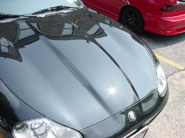

The WETTEST look possible?
Anal prep with 3M LC, Menzerna IP and FP, AIO and Zaino.
Paint has a dripping wet appearance, deep in color hue richness (prep), reflective as hell (prep and Zaino), and this appearance last wash, after wash, after wash. :xyxthumbs
#80 - AIO - Klasse Sealant x3 - Wolfgang x2. These pictures are 10 days after detail and after a 100 mile drive.

Meguiars #80 Speed Glaze with a cutting pad, #9 Swirl Remover with a polishing pad, NXT wax with a polishing pad, Wolfgang Sealant by hand (two layers), Pinnacle Souveran by hand.
Direct sun shot
Angled sun shot
Shady side shot

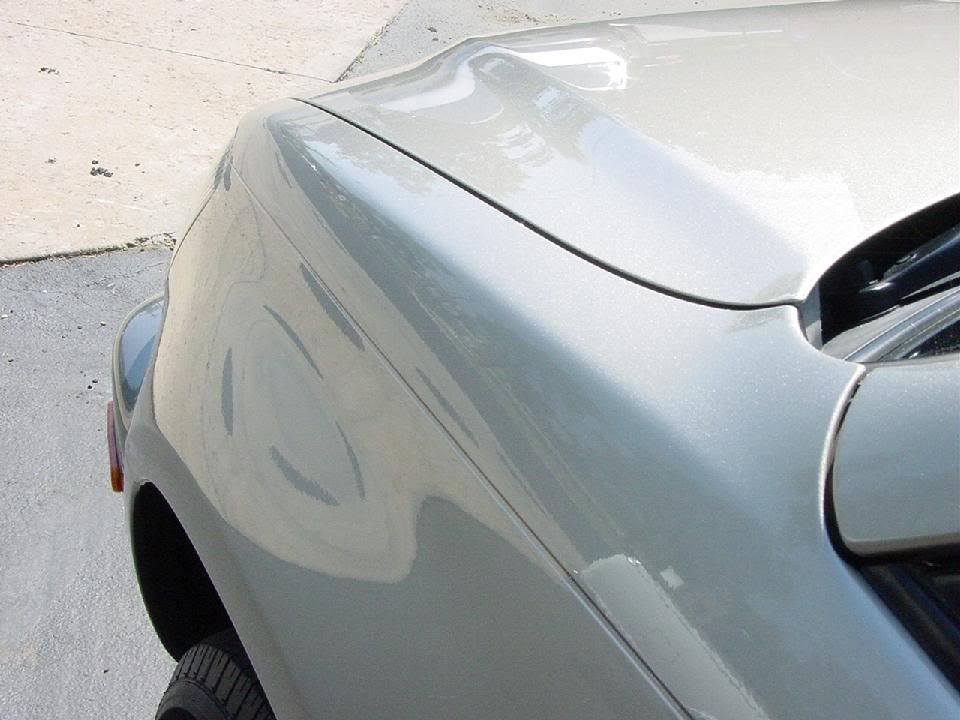

Hmm...that's strange. As far as I know, no part of my car has ever been repainted. Here's a pic of what I'm talking about. It doesn't even bother me because it's barely noticeable.
You can't see it too well in the pic, but it's there....could it be etching from the weather over the years? :confused:
