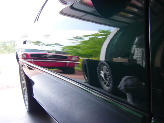

Nov 15, 2004 #62 MattZ28 New member Orange peel is when the paint isn't completely smooth like a mirror....looks like the peel of an orange, or a golf ball. Here's an example. Look at the side of the garage, see how it's not perfectly smooth?
Nov 15, 2004 #63 B B737Capt New member I think the paint on my Pontiac GTO is kinda like that. Is this just cheap paint? Is there a way to smooth this effect out?
Nov 16, 2004 #64 N Nocholis Rimnson New member Most all Production cars will have Orange Peel.. And With LATE paints being Sprayed on so thin...There is NOT enough product to color sand without going through the clear coat..
Nov 16, 2004 #65 MattZ28 New member ^What he said. Pretty much any car under $150,000 is going to have orange peel
