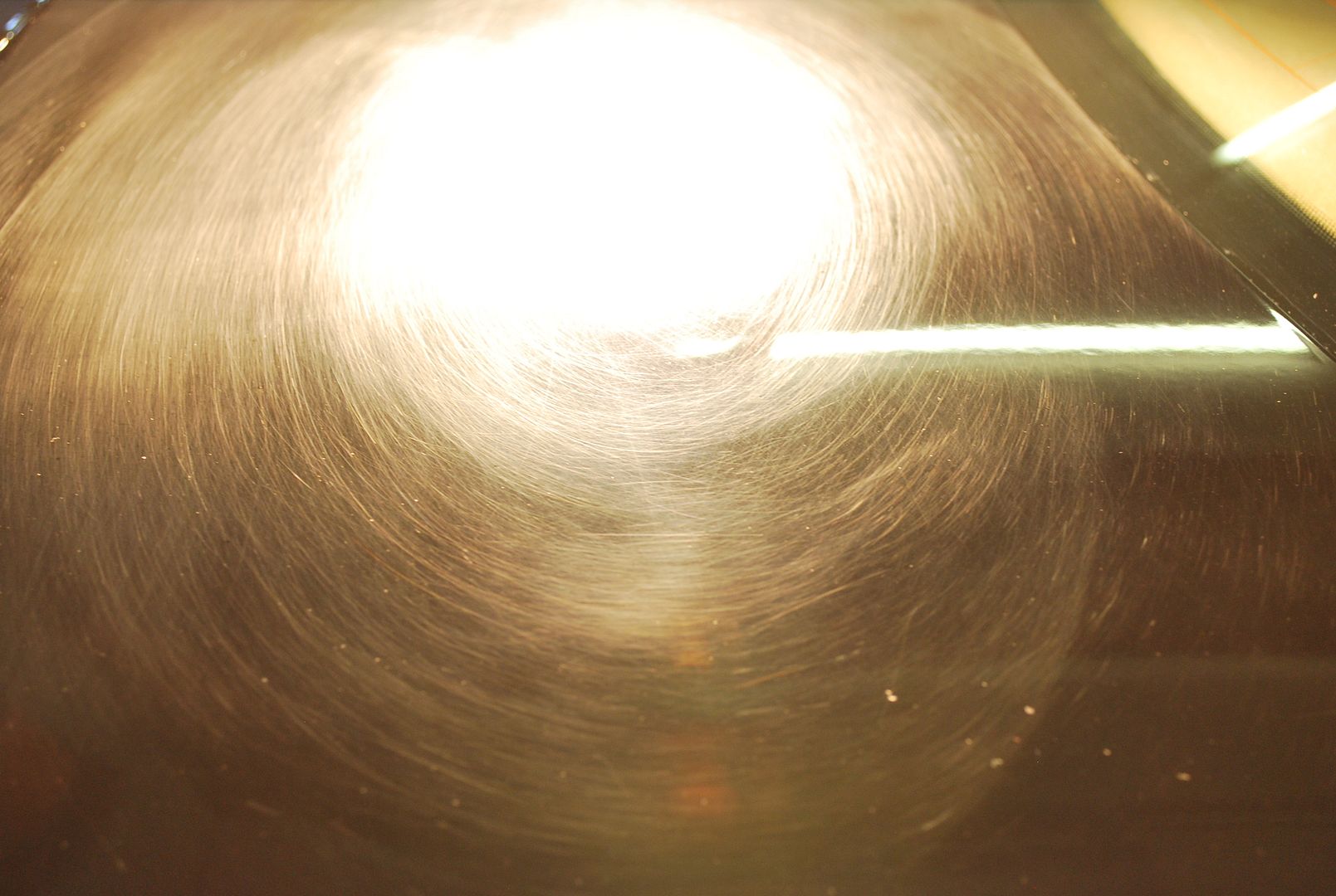

The Audi A6 you are about to see is one of the worst cars we’ve had in the shop this year. Not only due to the horrible condition of the paint, but the job overall. The car had recently been to the body shop for some paintwork and was just a swirly, dull, scratched, neglected mess! The paint did not want to cooperate at all and was just a nightmare of a job.
The pictures below show the condition of the exterior the day it was dropped off at the shop. Keep in mind that it had just left the body shop and was wearing a fresh coat of glaze which was hiding a good amount of the defects. I knew once it was properly prepped, it was only going to get worse.
I’ll just let the pictures do the talking……

I started on the drivers side rear door to see what kind of correction could be achieved. I quickly found out how ridiculously hard the paint was and knew this car was going to be an absolute nightmare! I must have used a dozen different product/pad combinations before making a dent in it.
Below is the drivers side rear door after about 90 minutes of polishing. This is with no final polishing or wax! Definitely a huge difference compared to the front door!

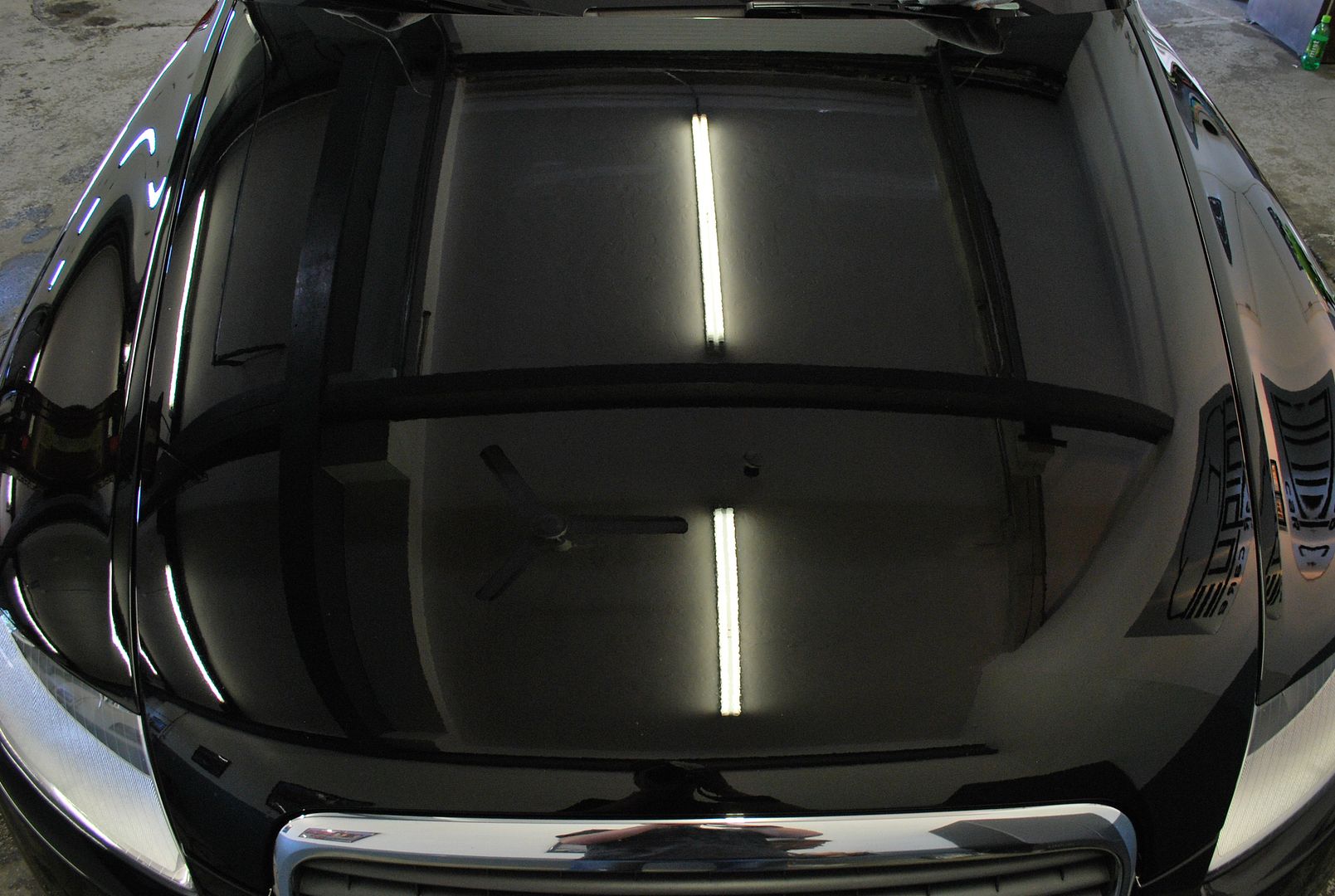

Now onto the after pictures! We were so beat upon completion that we didn’t go crazy taking after pictures, but I think you get the idea how well it came out!
AFTER!!!!!!
