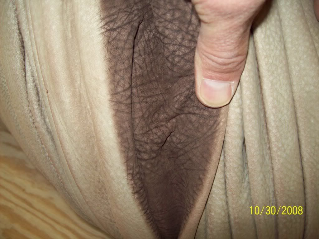

It was a suede. I didn't realize it till after I had started to clean it.
My sequence to restore this will shock most people. I put the cushions in a front load washing machine and thoroughly washed them. I finished with a DI water rinse. After this they were pretty much prepped. I used Refinish Coatings top coat thinned down to soak in. I don't remember how many coats I put on it. I finished with a light sanding to bring the sued back up.

These “Velvet Suede� also known as Nubuck show the result of the leather-safe system removing years of embedded body-oils and bringing back the 20 years of sun-fading without resorting to colors or dyes.
This work was done by a fellow leather service provider operates from Detroit – USA.
Hydrating with a pH 3.3 hydrator and fatliquoring with a pH 5.0 fatliquor was the main contributing process that brought the color back naturally.
I think it's a much simpler and safer system than what you have posted.
Do you see the technological advantages of using Hydrator and Fatliquor restoring back the color?

#1 Sunfading
#2 Before
#3 After

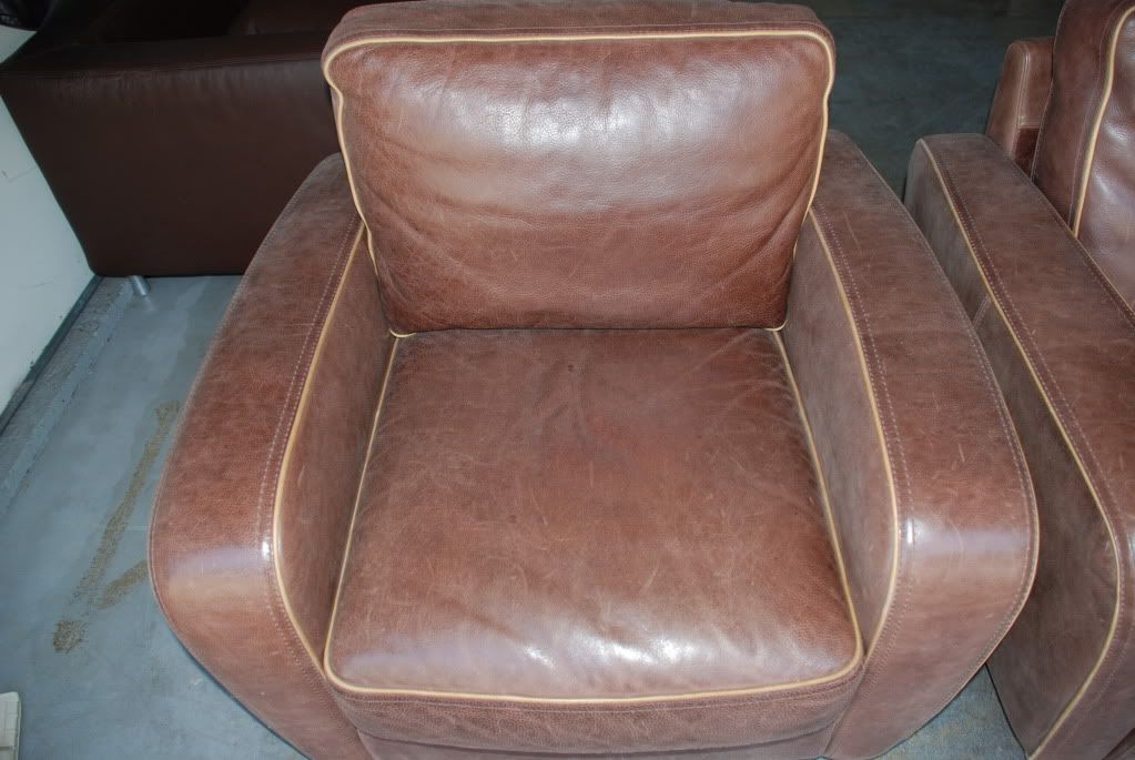

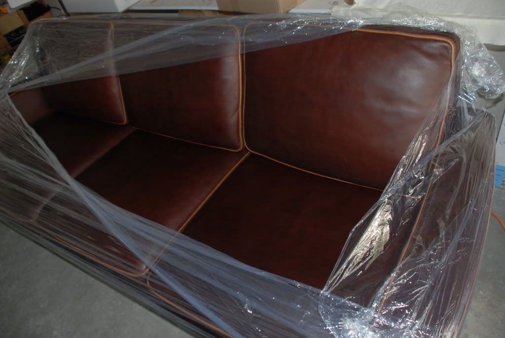

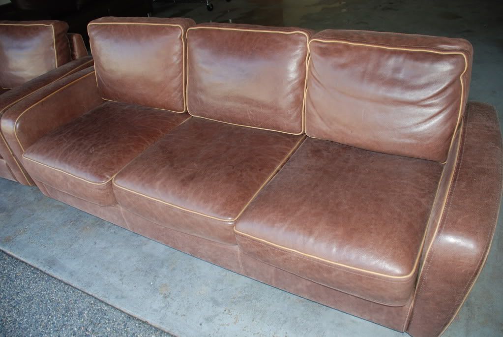

#1 Baxter Waxed Aniline Armchair before
#2 Baxter Waxed Aniline Armchair after
#3 Baxter Waxed Aniline Sofa before
#4 Baxter Waxed Aniline Sofa after
