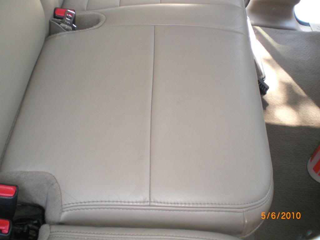

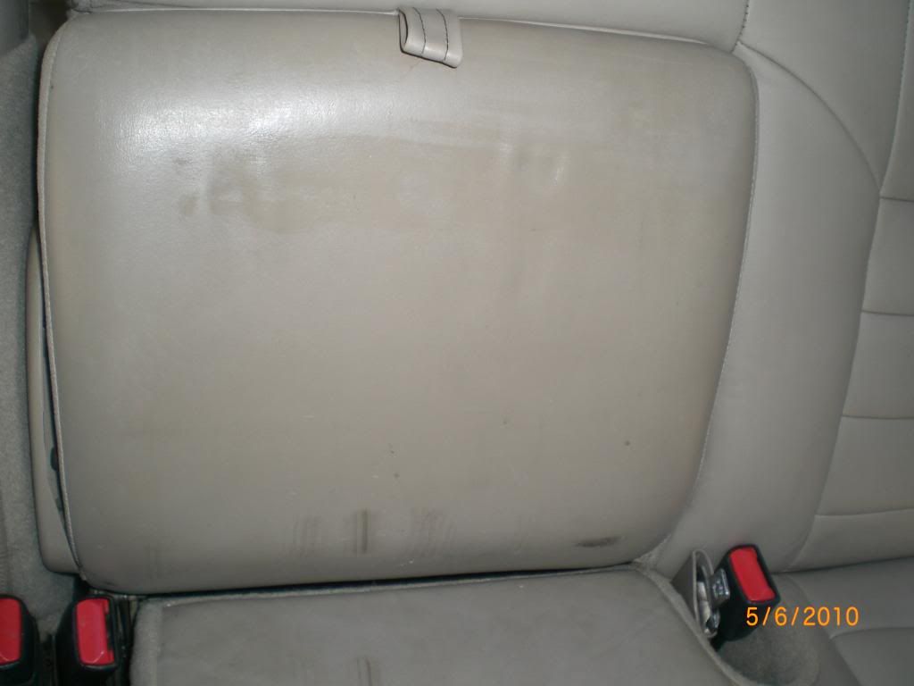

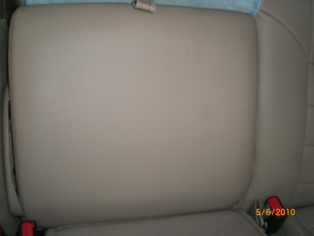

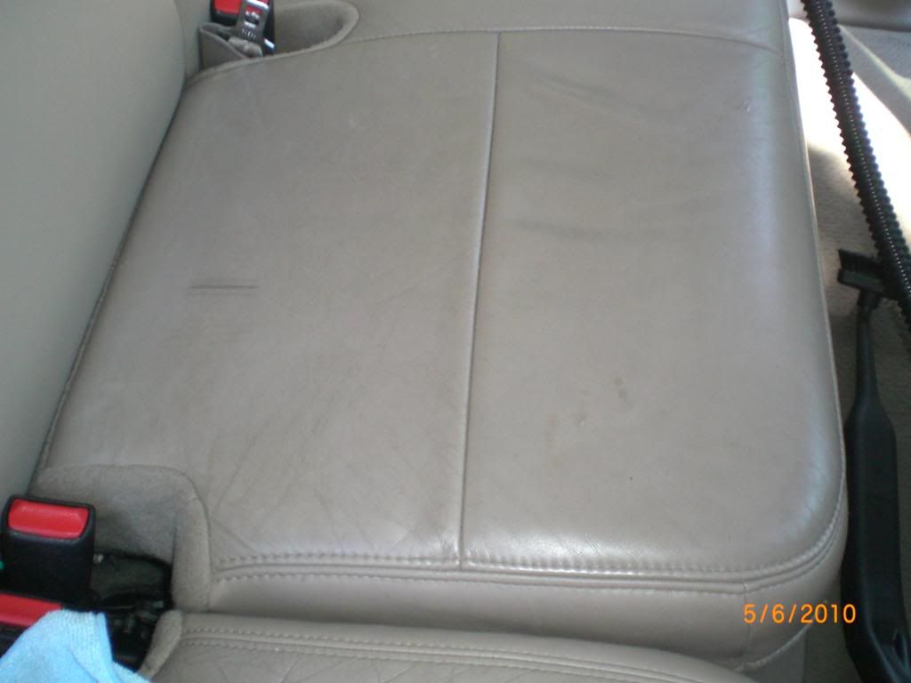

I went the steam route and APC 10:1......
Before
After
[quote name='silvSS03']I went the steam route and APC 10:1......
Looks Good!
Can you tell us the pH of your APC?
And also the Temperature of your Steam?
Roger Koh
Leather Doctor®
