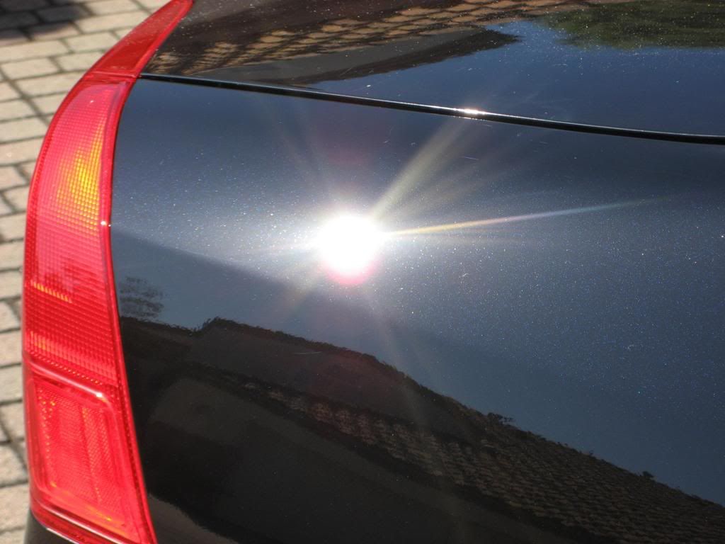

My experience with M105 and the Flex on Honda paint:
2 X M105 with PFW
PO106ff with LC Orange
I didn't have as much luck on the trunk, but it could just be how really horrendous the car really was...I did 3 passes with M105 on the trunk.
