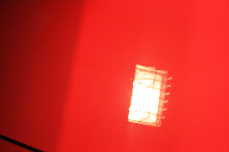

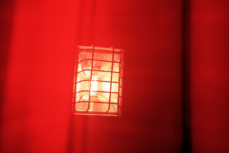

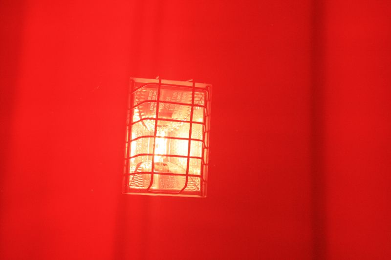

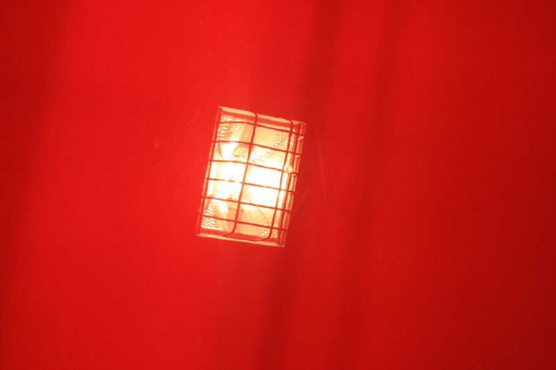

THIS PROCESS WORKS!!!! Thank you so much waxman! I did exactly as you said, prime the pad thoroughly, laid about a 5-6" bead down, 1000rpm, worked until drying, then spritz with water, and keep going until it finished down. Worked flawlessly!
Here the results:
BEFORE:
After several different processes including 2 passes with M105/Wool(normal), 2 passes with SIP/Wool, SIP/Orange, SIP/White..NOTHING WORKED!
Now after ONE "pass" using new process from iamwaxman, followed by 106FA/white:
The light is out of focus because I had it to show the swirls not a perfect reflection of light..

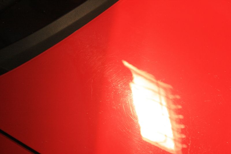

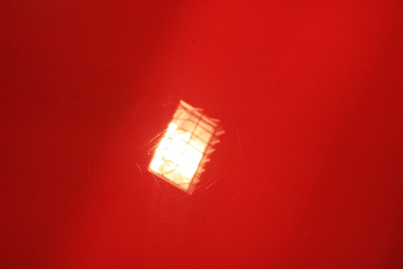

Here is a little more detailed:
BEFORE:
BEFORE: I messed with the levels in PS to make the swirls stand out.

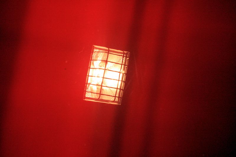

AFTER:
AFTER: Used same exact process as for the before picture.
