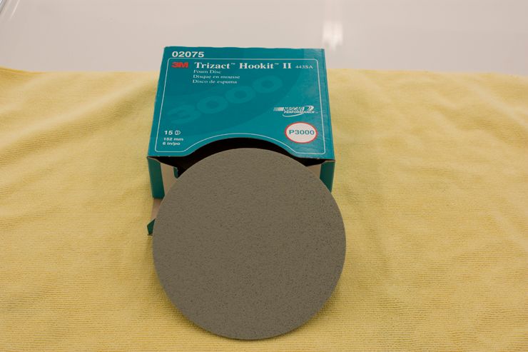

M105 is definitely aggressive enough to cut through 2000 grit marks, but pad choice will be a huge factor as well as the paint itself. On most paints M105 and a wool cutting pad will cut right through 2000 grit sanding marks...though finishing with
3000 is still the better way to go. M105 is not as aggressive as the 3M
extra cut compound, but it's pretty close to their regular compound yet finishes down a LOT better IMO.
