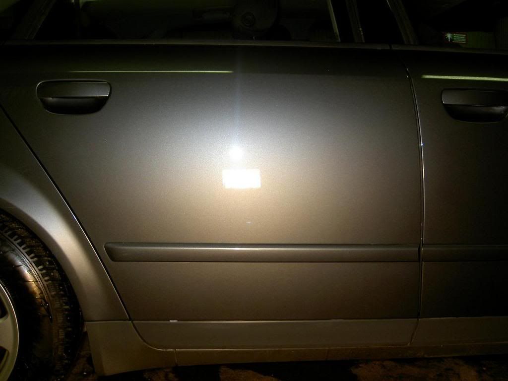

I used Menzerna PO85RD3.02 with white compounding pads and after that I used a new typ of pad, think it´s the same material that the new Lake country CCS pads(orange) with FF(PO106FF).The car had some light swirls and some RIDS but the paint was hard as a rock. Used PG to prime the RIDS and after that I hit them with IP.
But the strange was that I could easily take out the big scratches but the small swirls was way harder to eliminate :nixweiss
The 80439 is pretty much the same as Menzerna FF, but I have only polished two cars with it so I don´t "know" the product yet.
here are some photos
