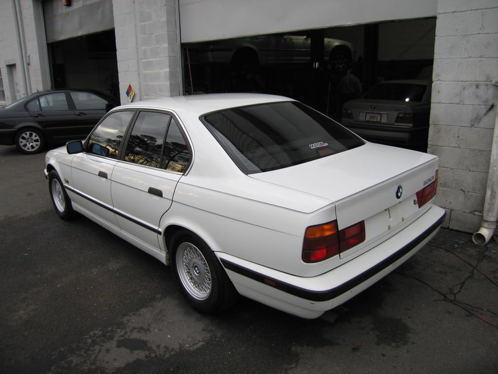

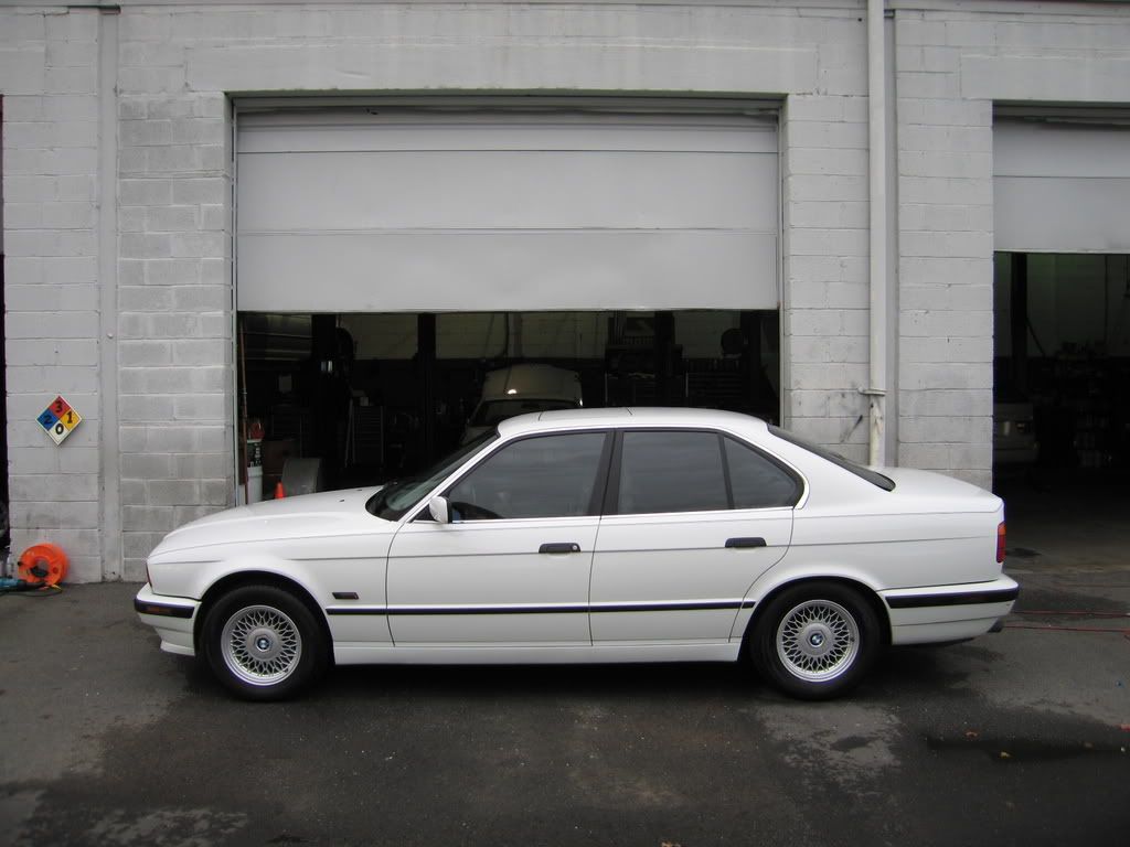

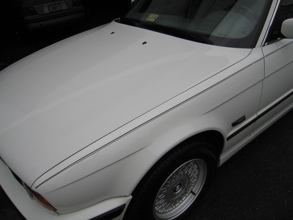

stiffdogg06 said:
:showpics
All these reviews and still no pictures. I call BS.:grinno:
My pictures today didn't come out too good at all, but here you go, just for you.
You will not be impressed at all. In person the paint looked great though.
Looks good tdekany.
