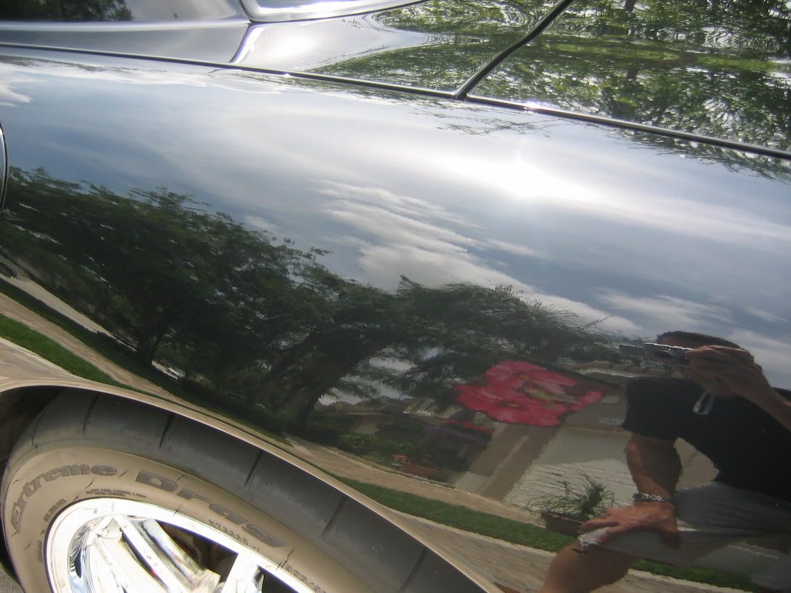

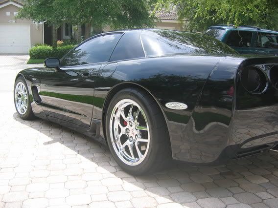

Sorry about the absence but the Army sent me TDY for personnel updates so I haven't been home to work on the Z as of late but finally finished up the other day upon returning.

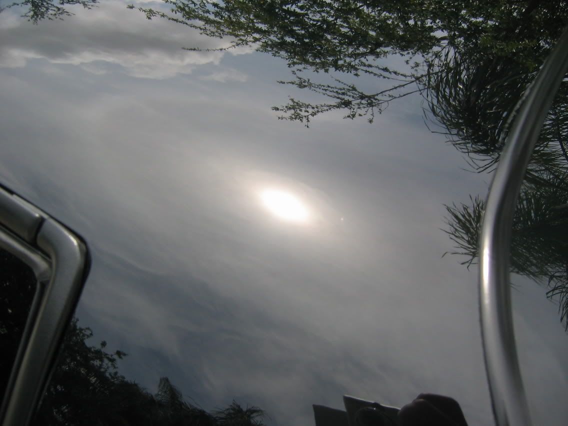

I did get some pics today but I don't think they are detailed enough to see the work. I took them under lightly clouded skies. Every section of the car turned out very well except the hood and trunk. You can still see 4" orange pad trails. The trails are hazy as well. I suppose I will have to back over with RC with the 6" white pad, followed with the MG and final. I did not see these trails when the car was in the garage under florescent light and I really checked out the vehicle well before pics. I can't believe I could have missed such large areas. Could these trails surface after time?
Should I MG multiple times to eliminate the trails? I had only gone over each area once with the MG and thought maybe 2 or more times were necessary. If I can get these two areas straight, I'll be happy. :)
http://i6.photobucket.com/albums/y241/Shamdaddy/IMG_1226.jpg
http://i6.photobucket.com/albums/y241/Shamdaddy/IMG_1237.jpg
http://i6.photobucket.com/albums/y241/Shamdaddy/IMG_1225.jpg
