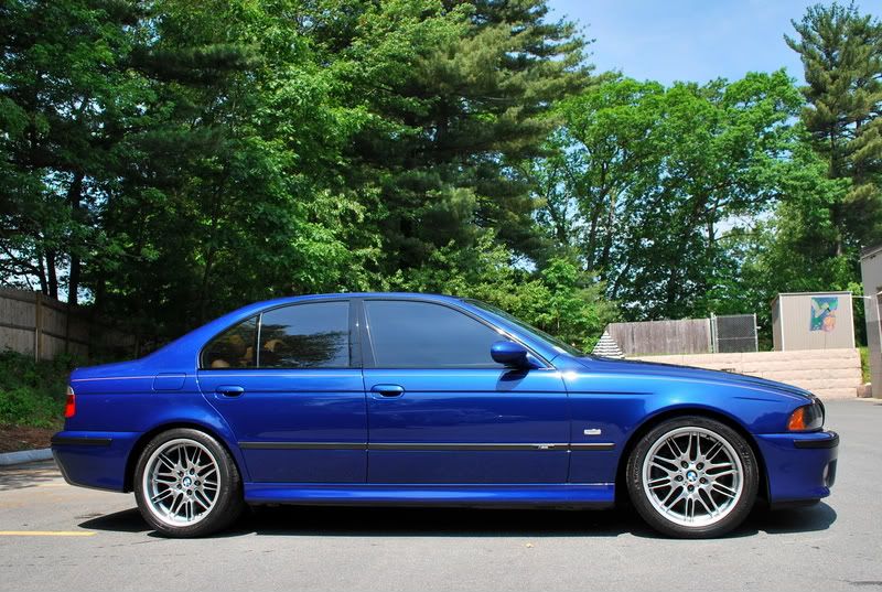

This beautiful blue BMW M5 belongs to a relative of one of my good customers, which is a member here on Autopia. The owner takes really great care of this car, but it was in need of a serious polishing due to minor paint imperfections and a moderate amount of swirl marks from washing, etc.. Not bad for a car that is 5 years old! The car has some minor performace mods which were tastefully chosen and really add to the car.

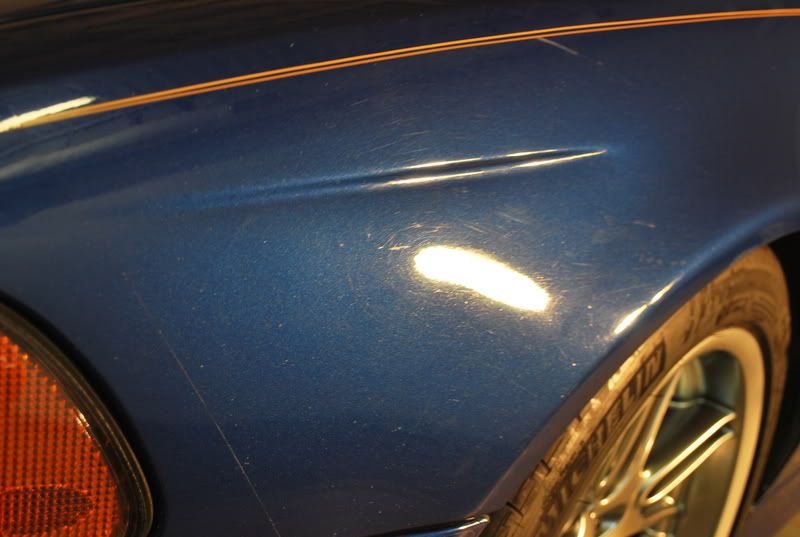

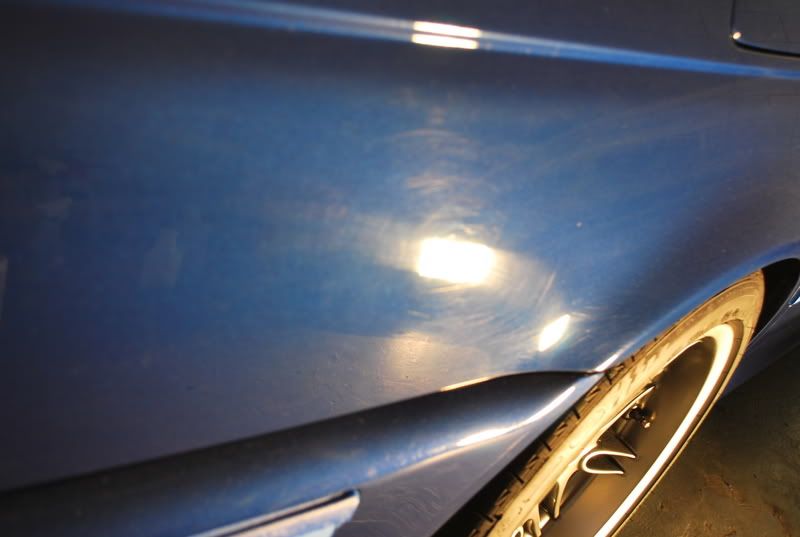

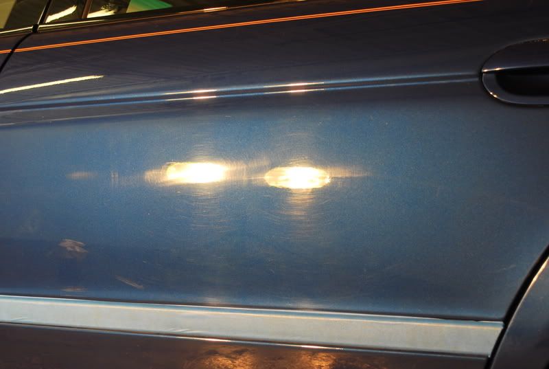

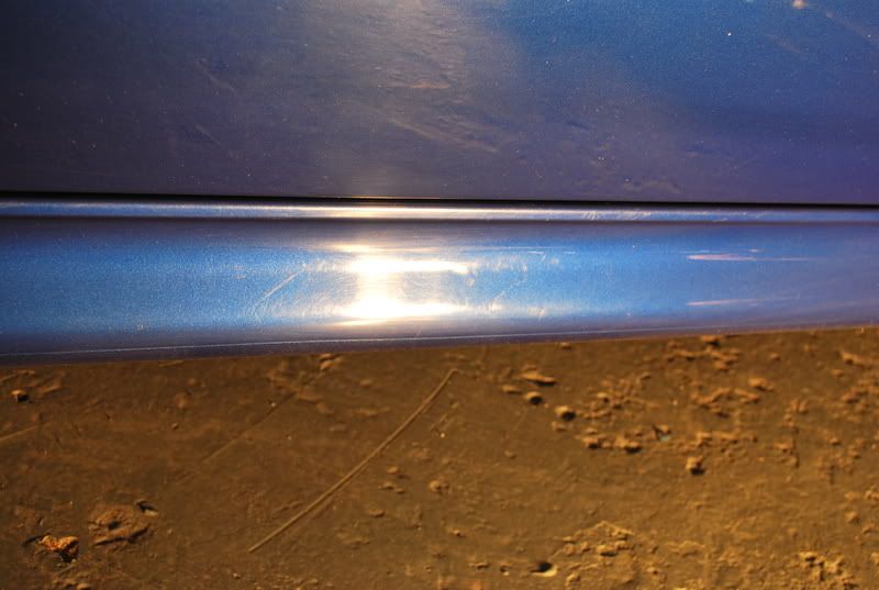

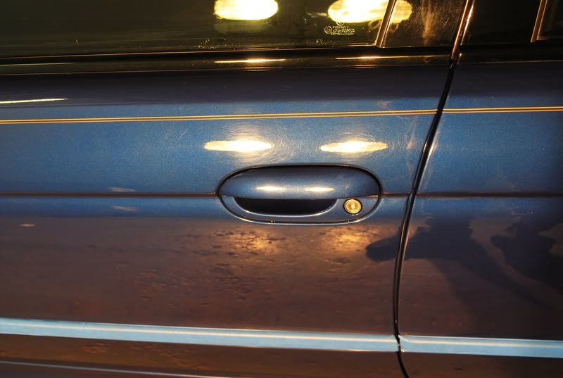

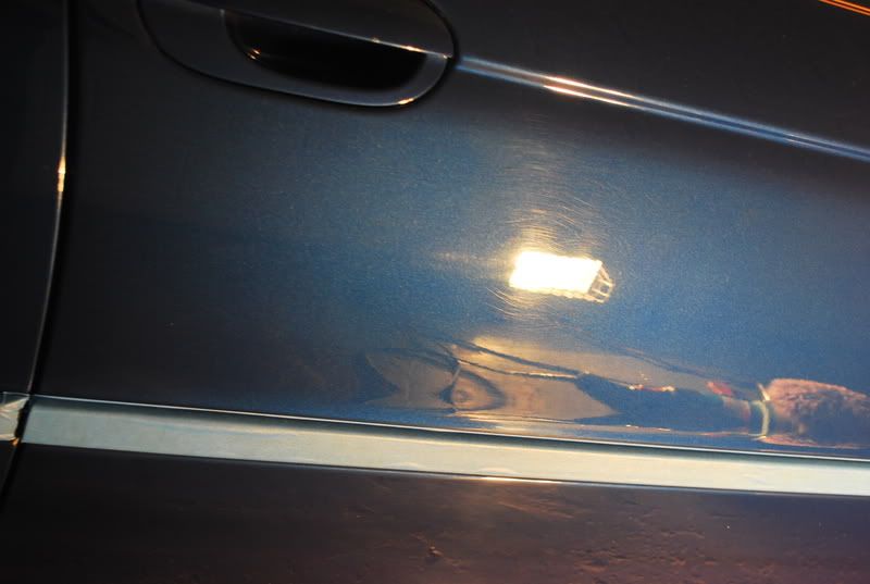

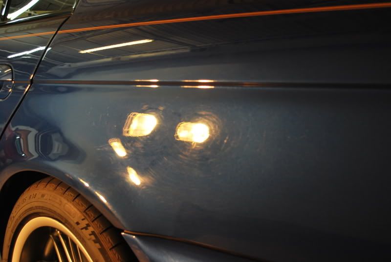

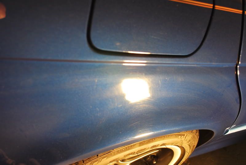

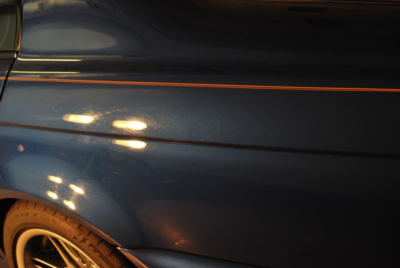

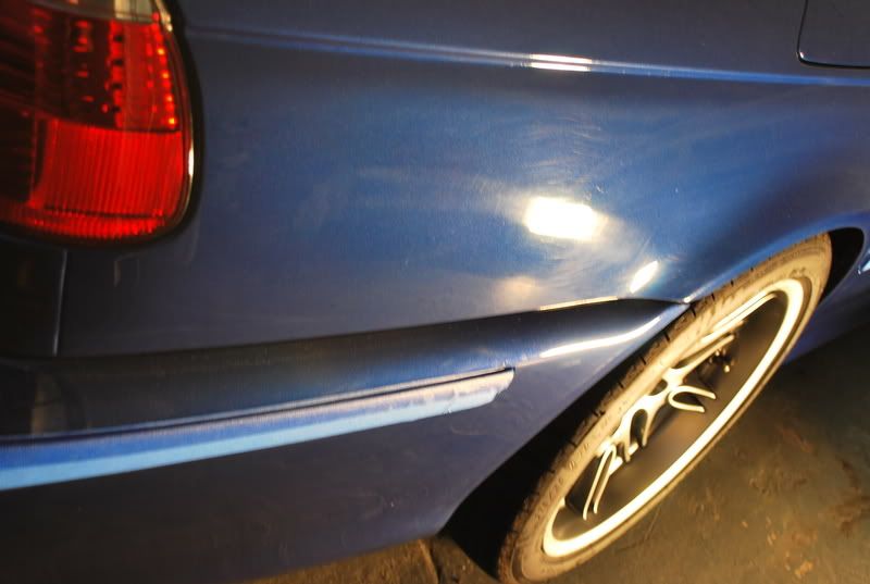

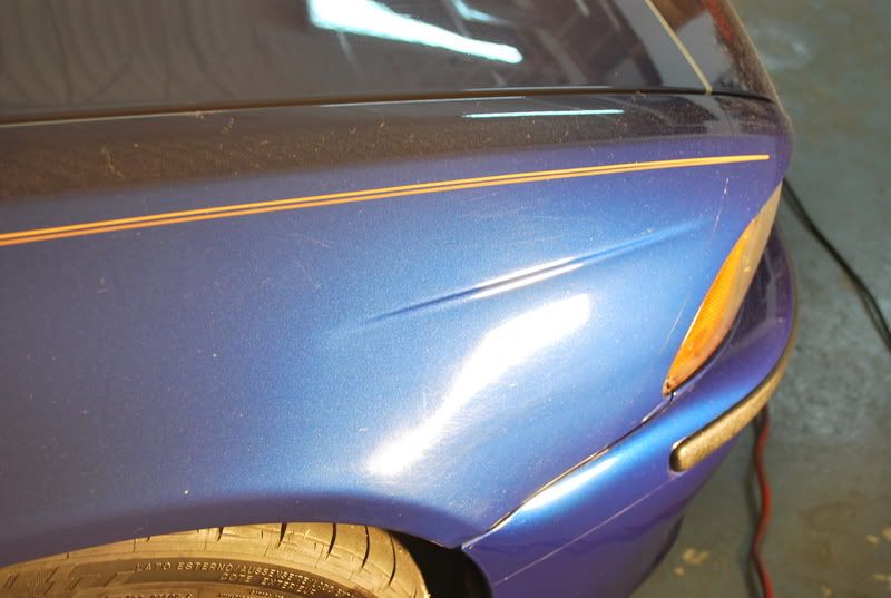

By looking at the car under the halogens, you can see that the swirls are very visible. Some of the imperfections were imbedded deep into the clearcoat and I knew that multiple passes would be necessary to fully remove them.

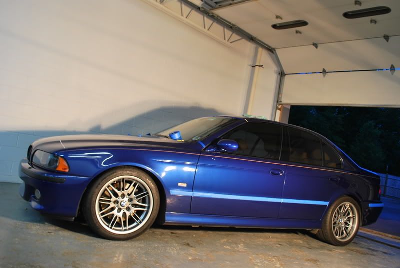

Below is what the car looked like after it had been washed and masked off.

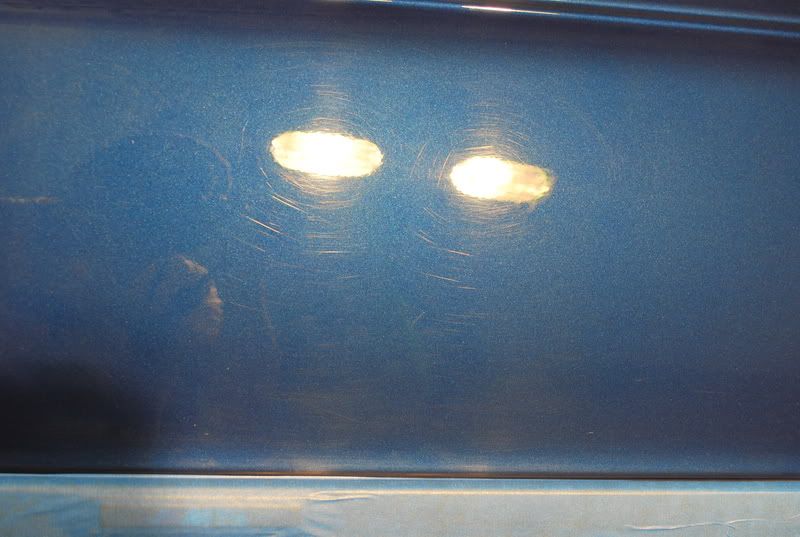

I started off by using the drivers side rear door as a test panel to find out what combination of products would yield the desired results. I started by using a few different products on a yellow foam cutting pad, but the clearcoat was extremely hard and did not want to cooperate. I decided to step up to a purple foamed wool pad for a little extra bite, which made a huge difference. I was amazed how rock-hard the clearcoat was and knew that It wasn’t going to be an easy detail.
After perfecting my test panel, it was time to start on the rest of the car. I decided to use Mark V Uno on a purple foamed wool pad for all of the heavy defect removal. It took me 3 – 4 sets of passes and a total of 18 hours to completely remove the heavier defects. The Uno left a really nice finish for a compound, but a middle step was needed before a finishing polish could be used. Menzerna SIP on a yellow Meguiar’s So1o foam pad was used for the middle step, which removed all of the compounding haze and left the paint ready for the final polish. I decided to use Menzerna 85rd on a blue CCS pad for the last step, which made a huge difference in depth, gloss, clarity and reflectivity.

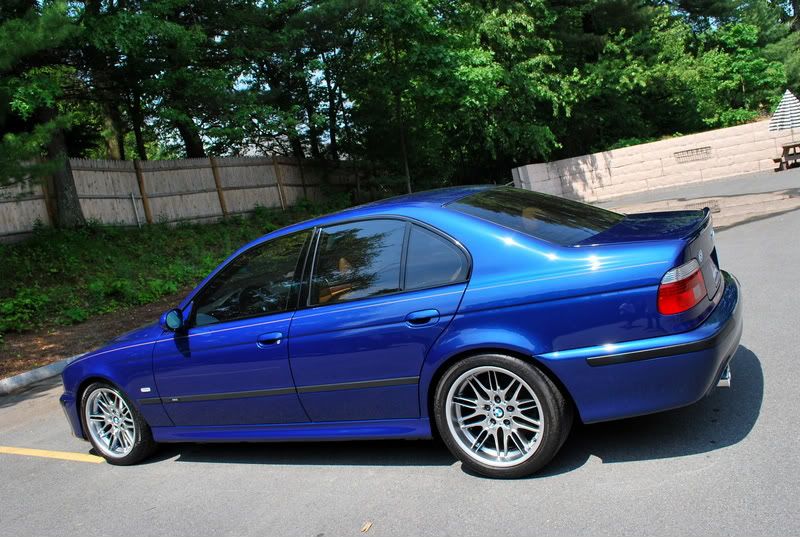

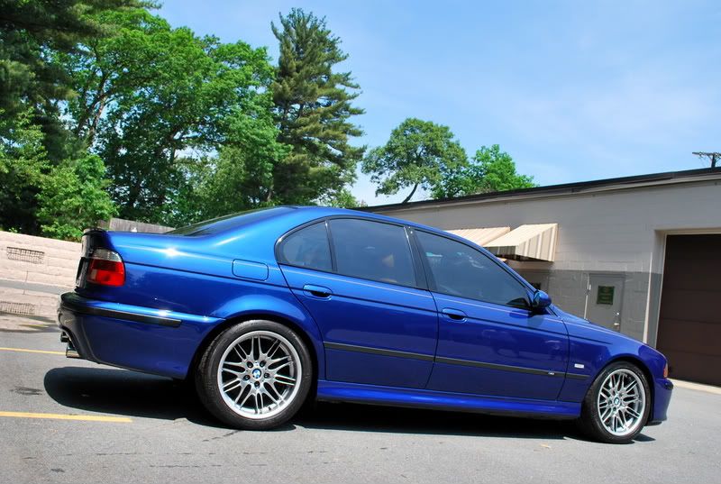

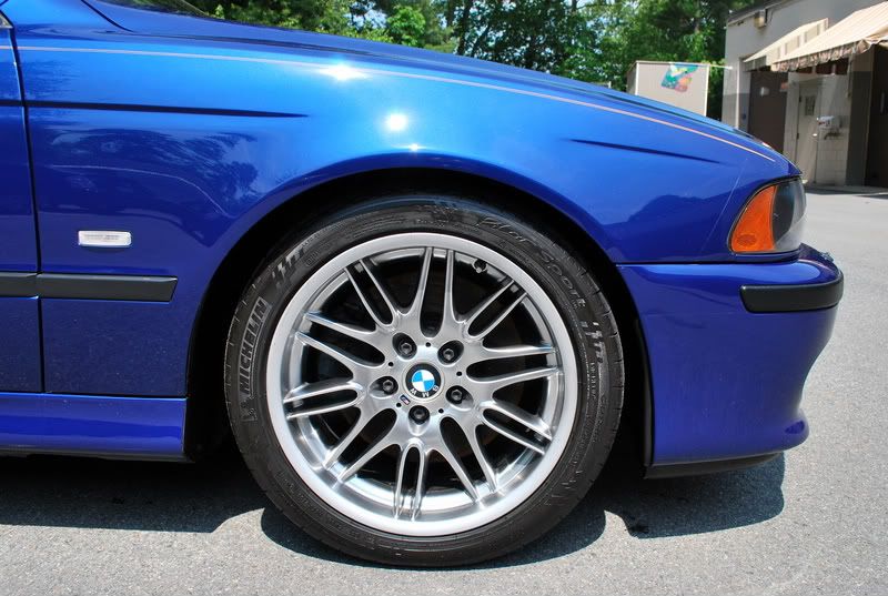

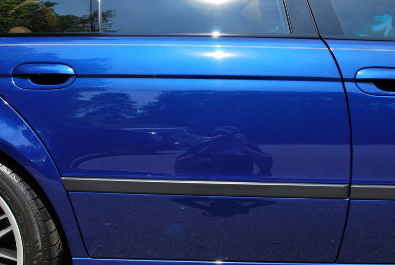

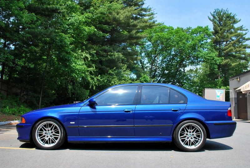

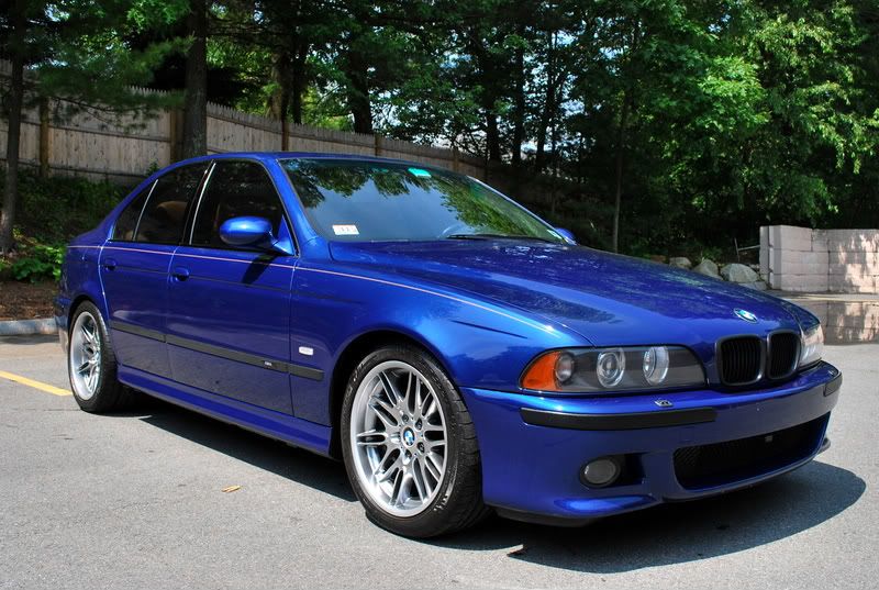

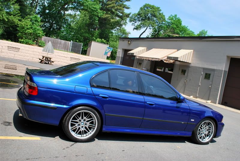

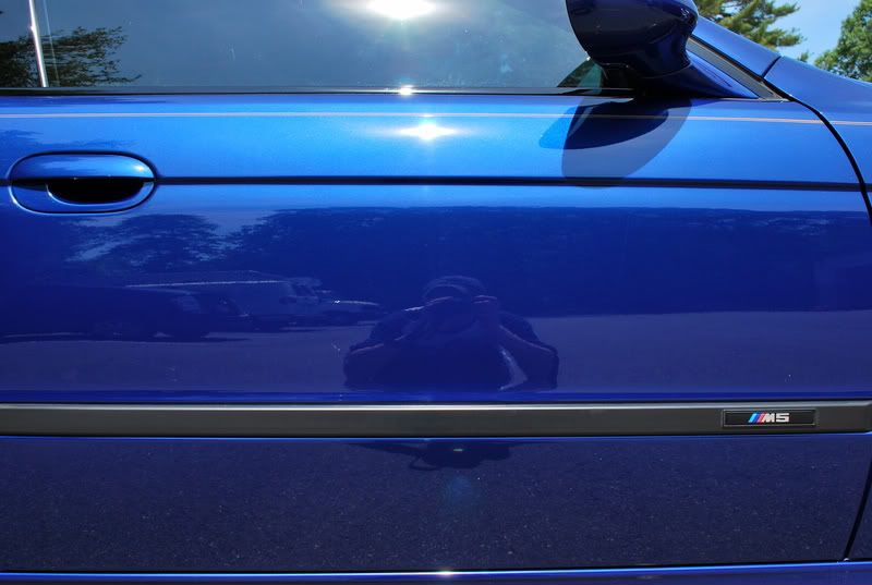

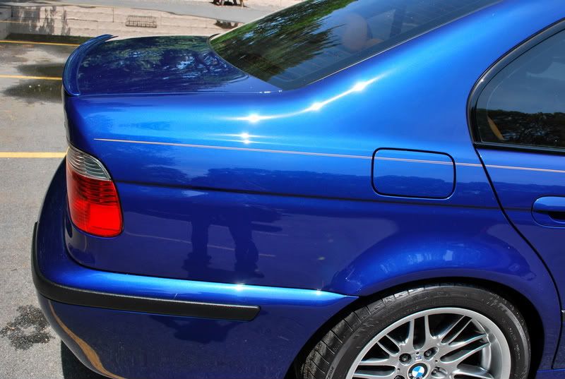

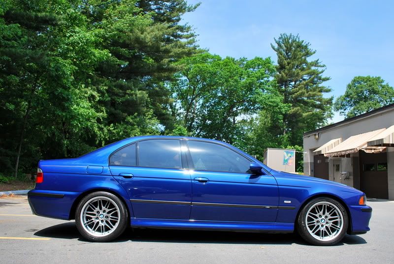

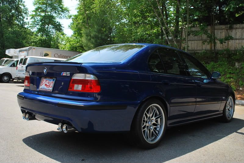

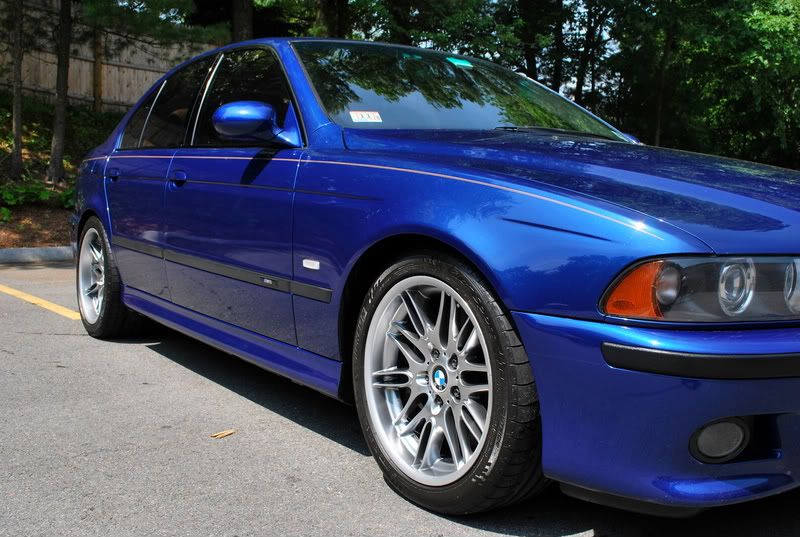

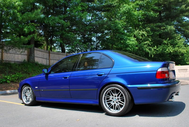

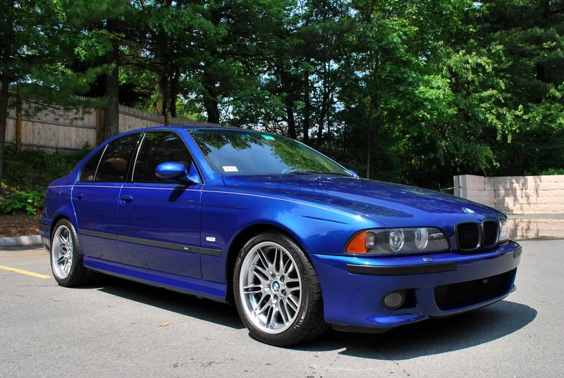

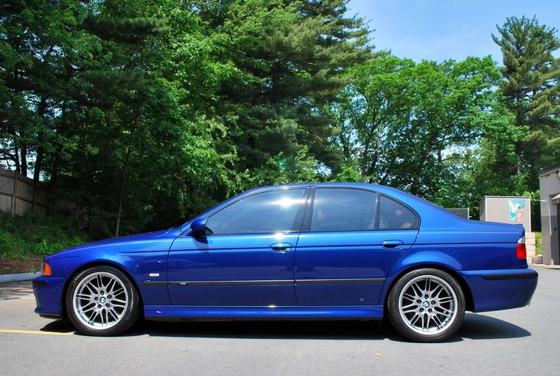

The pollen was the worst I have ever seen, which you might be able to see in some the pictures. The car was covered in pollen not even five minutes after pulling it out of the garage. Here are pictures of the end result…
