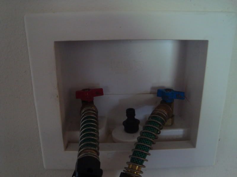

Here's my set up for high flow water for a hose and a utility sink in my garage. The high flow set up is just a set up for a washing machine. I don't know the set up of your apartment/ if you could even run a hose through it to reach the garage, but if you have a washing machine in your place, possibly you could hook up a hose to it's connection like I have and run the hose to the garage. :nixweiss

Rx8Fanatic- I think the pressure and volume will be OK, not optimal and not what *I* like, but I bet you'll think it's OK. Eh, I bet the real compromise comes from the little water lines that lead to most sinks...nothing like the size of pipe usually run to an outdoor spigot, at least IIRC. But hey, I'm no plumber ;)
If you want to hook a hose up to the faucet and it's the type that can accomodate one, you ought to be okay. Maybe you won't have high pressure for spritzing down wheels and wheel wheels, but what's most important is that you can lightly hose down the car for the final rinse. I'm guessing you should be able to bucket wash with no problem.
