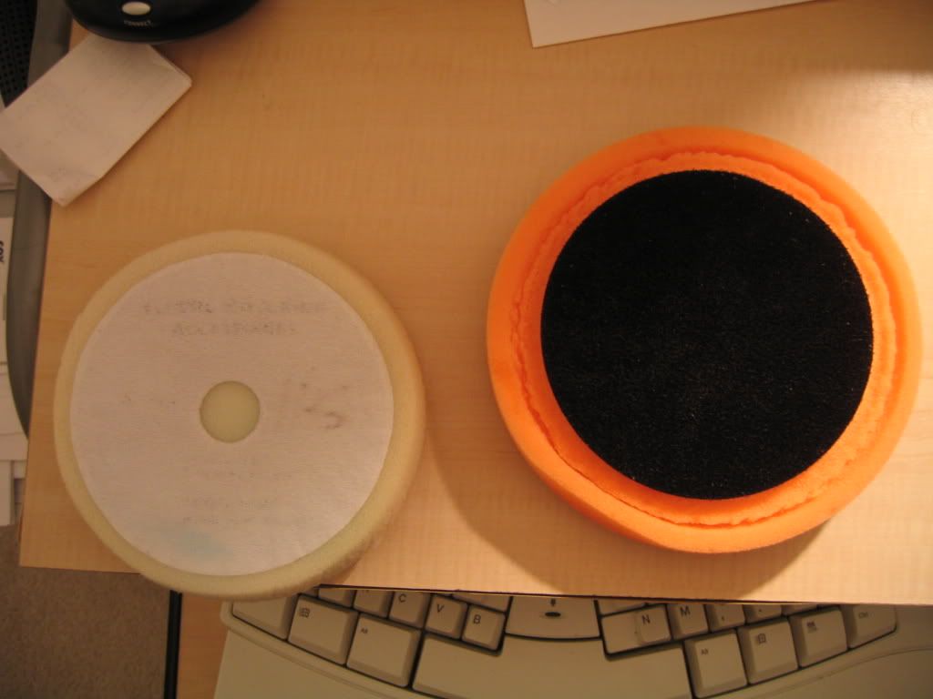

Anyone had their PC Pad do this? (pics)
oaevo8u said:
Im actually washing them right now and just inspected them and all of my pads have no hole in them except my green sonus. Its like something is nawing at it.
Just like mine are in the pics??
My old CMA pad (1 of 5) that has really been abused (not washed for days after using them - many times) alot and still holing up.
My new TOL orange pad after using it on half of a car.
Do I need a different backing plate with these pads?
Well I know my problem does not consist of a big backing plate, its the one that comes with my sonus kit. I just find it hard to beleive that to much product would do this but on the other hand I beleive it because you can c product on the back side of the pad. Very very strange!!!!!

tdekany- I've never seen a pad do what your orange pad did. What size backing plate and counter weight do you use?
what ever came with the Coastal tool kit - the weight is 6 and the plate is 5.5? the cma pad is a perfect fit.

tdekany - My TOL orange pads (2) did the same thing as yours, and the velcro peeled off the back. I only used them maybe 4 times each.I just called TOL today and asked for exchange or refund and they said they would call me back so I'm waiting for them.
Eliot Ness said:
I would say as the Velcro backing on the pad is separating it allows the pad to wobble a bit, and that motion allows the Velcro on the backing plate to chew the foam through the hole.

My Meguiar's pads do that all the time. The backing comes off because of the heat being transfered through the pad is melting the glue. As the glue melts it makes the backing slide around and that center hole is ripped up because of the velcro on the backing plate. Its just what happpens I guess... I haven't had it happen with Edge pads or the Sonus pads. So far I have not found a good way to avoid this problem. I just make sure I always have another pad on hand just in case the backing falls off unexpectedly while on a job.
