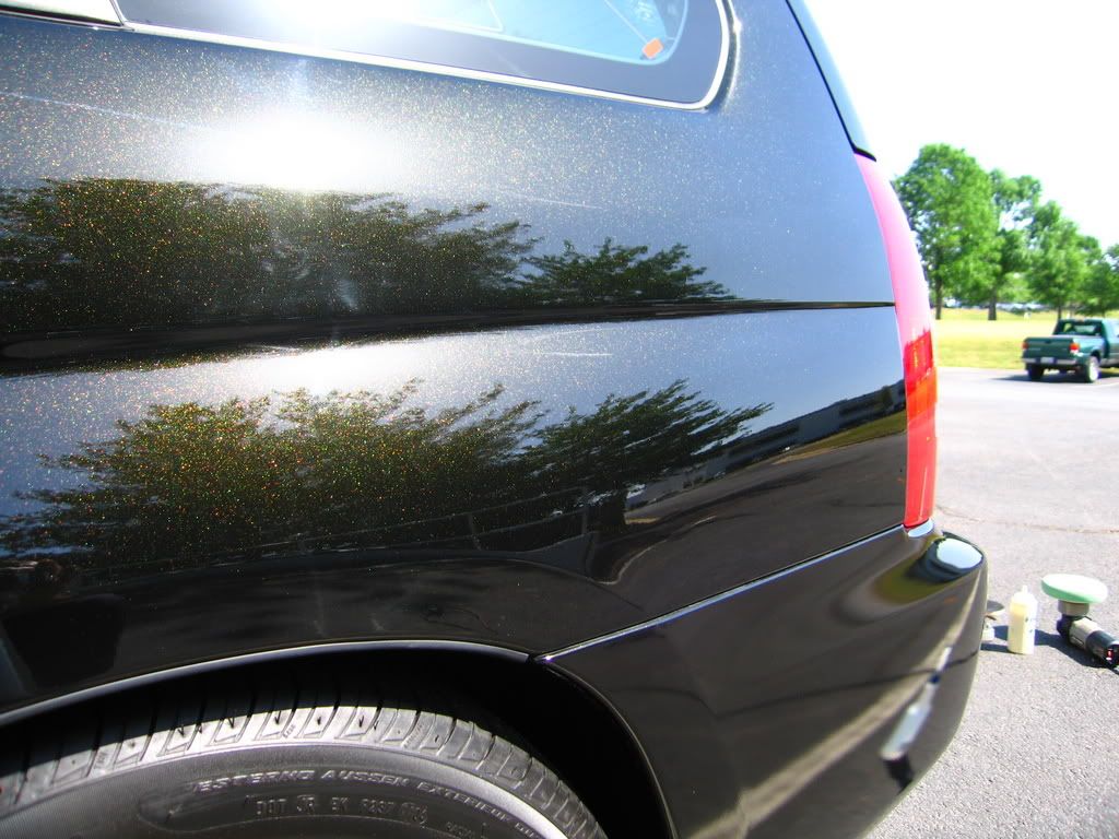

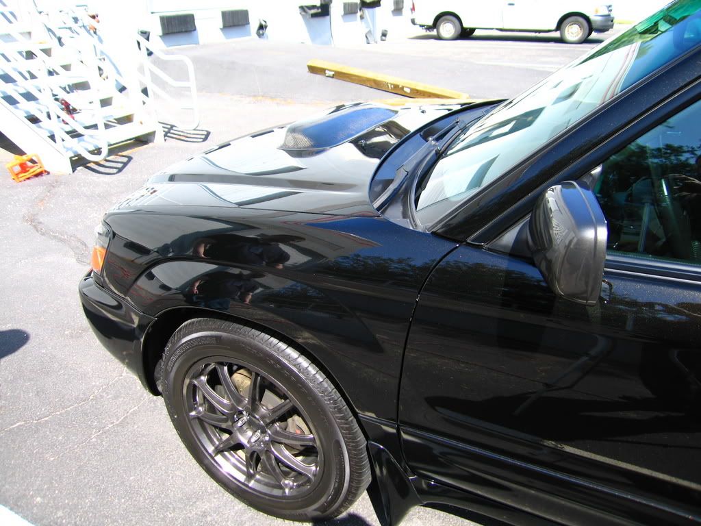

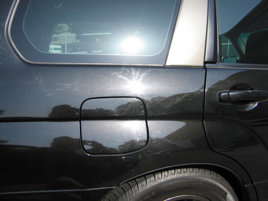

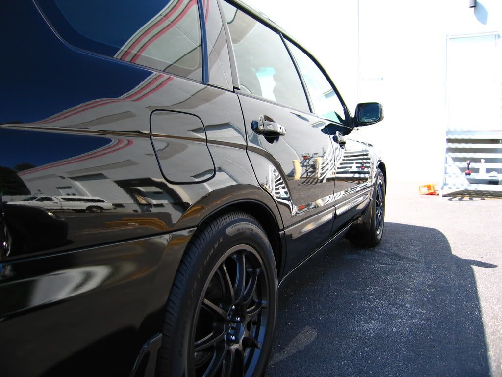

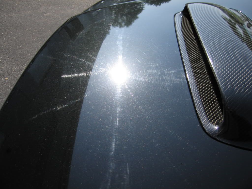

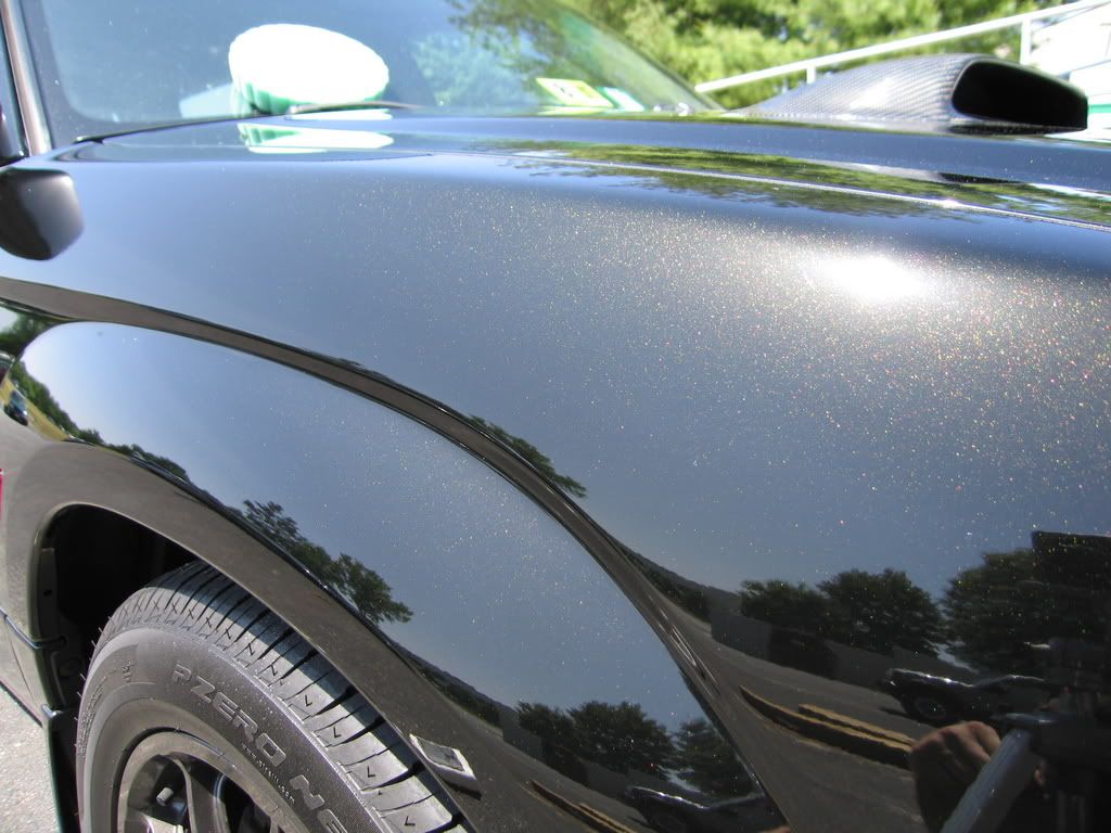

I had no shade today and it was a very very hot and sunny day. The paint got so hot that even OP couldn't be wiped off. A first. It was wierd!!!:chuckle: :chuckle: :chuckle:
It took a little extra time to figure out a process - thank god for CG's EZ Creme.
I worked on the exterior for 6 hours.
PS: I was told that this car has about 350HP or so. The owner may chime in.
qew
clay
OHC orange pad 1500rpm on hood
OP FK1 yellow pad pc 6/rotary here and there 1500rpm
Poli Seal green optimum pad pc 6 (to remove OP)
CG Ez Creme green ccs pad pc 6
Z6 wipe
CG Extreme coat Sealant to protect
Z6 wipe
Grape dressing on tires

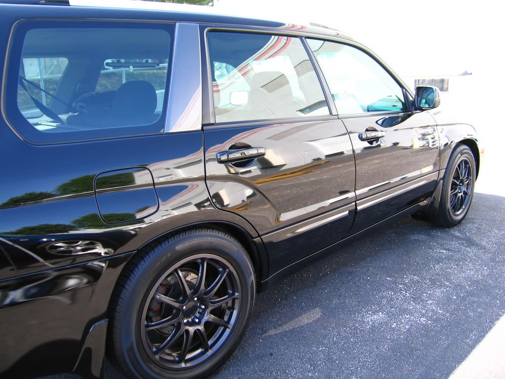

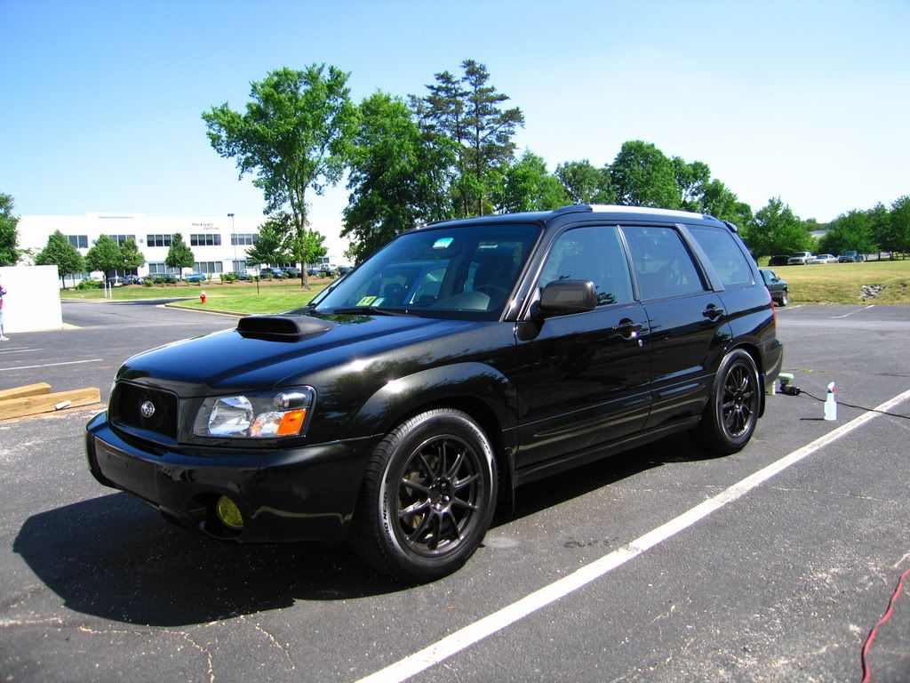

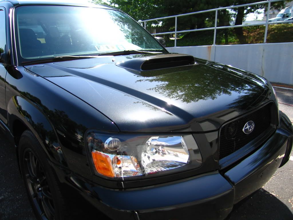

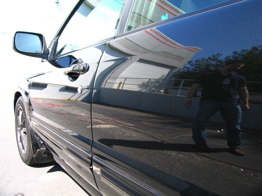

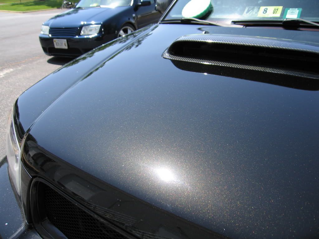

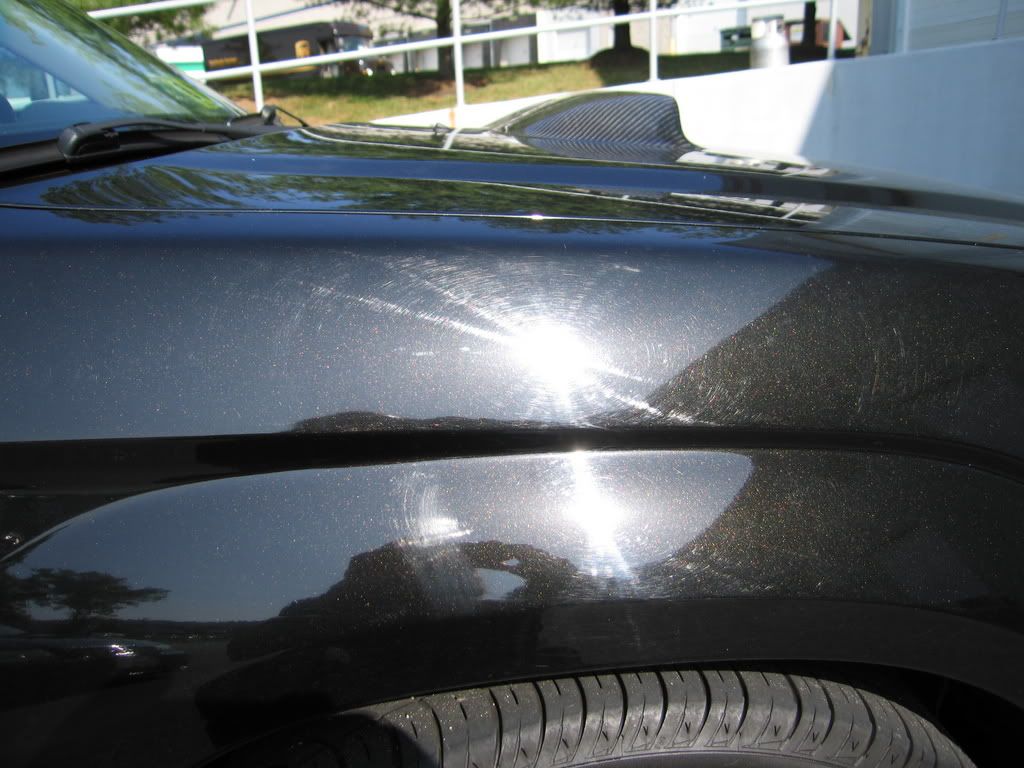

before
After polishing
After protection
Before
After
Before
After
