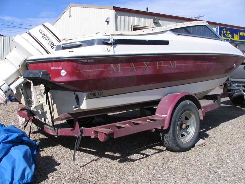

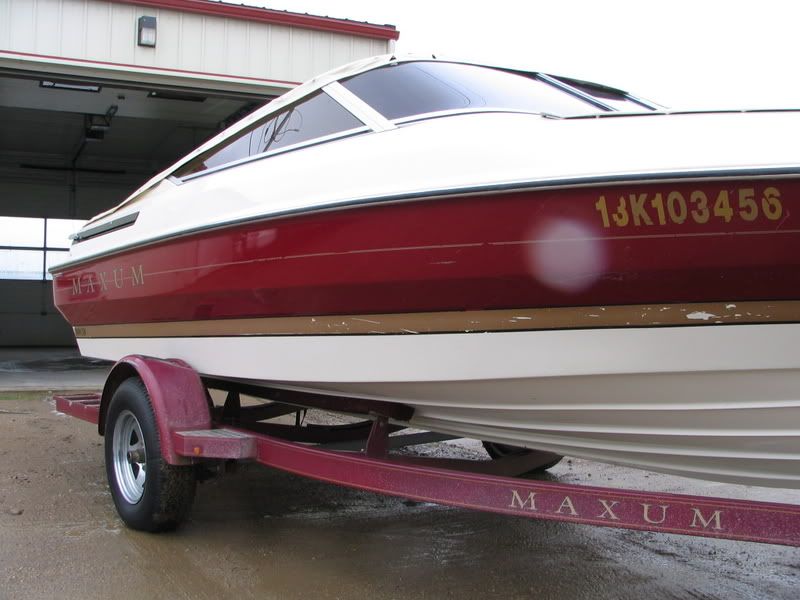

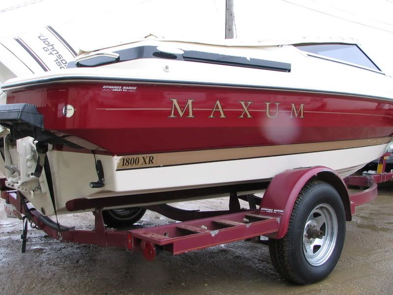

Just a little update to this thread. This is a boat that was cleaned and then polished and then X-koted. I should have taken some pics after the polish, just to show the improvement that X-Kote made.
Afters were quick shots in the rain with no sun, rain drop on the lens. This is one of the main reasons i bought into X-Kote. To reduce or eliminate oxidation on gelcoats. We will see how it works.
