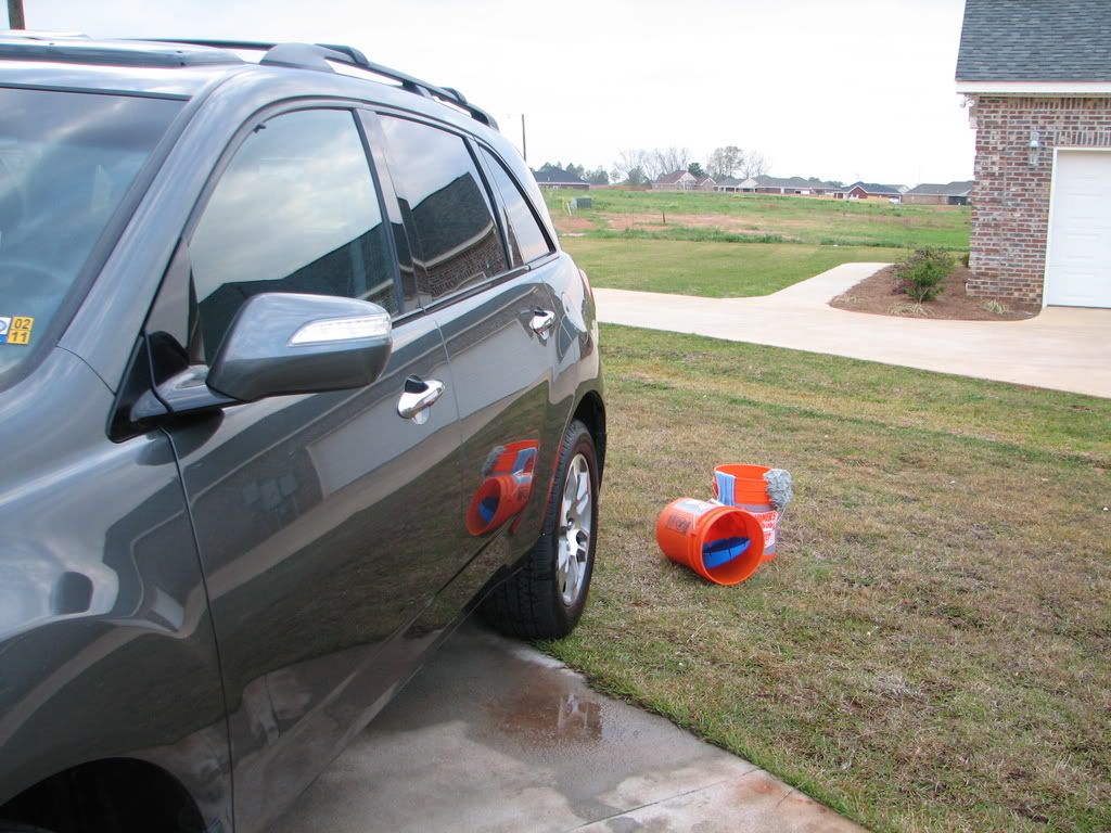

Pics make it hard to tell but here was my first attempt at my wife's almost new MDX (which we still have)

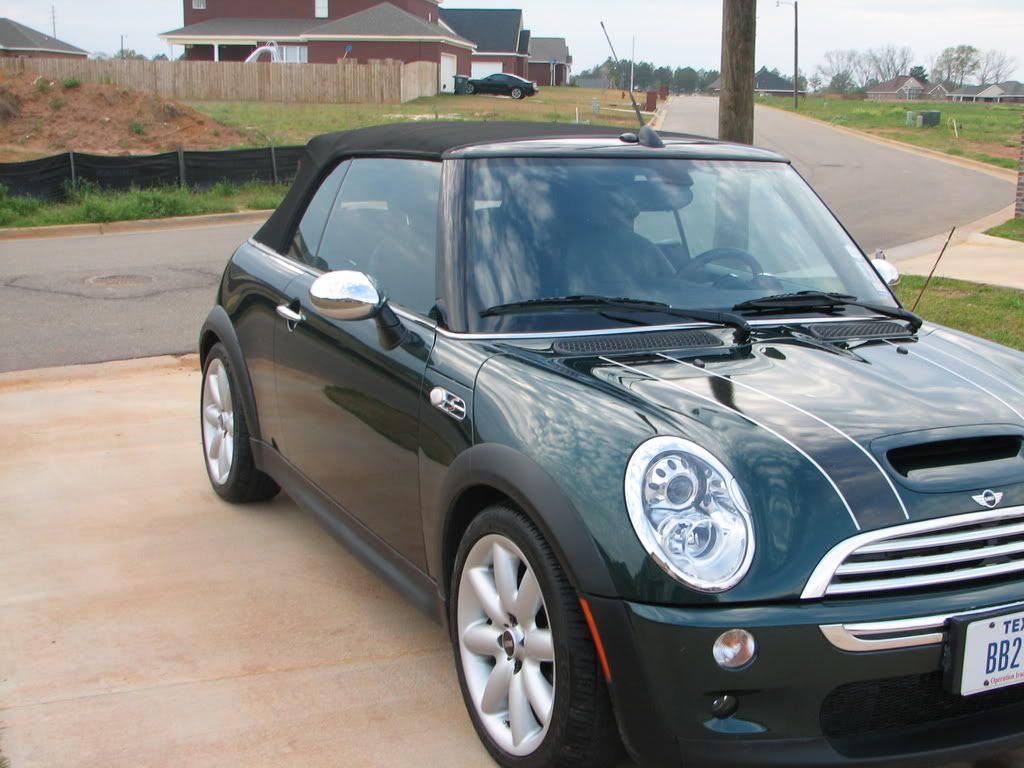

Here's the 3 year old Mini I had at the time:
Hard to tell but you could still see some swirls when I was done.
