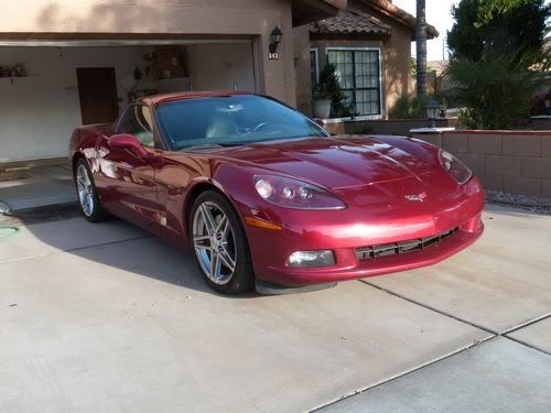

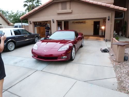

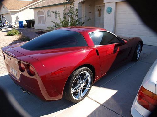

There she is....a beautiful red 2006 Corvette. Jim (the owner) saw one of the write ups I did on another Vette we did, a black 08' z06, and thought our work looked great. He was hoping that we could perform the same magic to his ride.
We met up with him after work one day to take a look at it. And yes it needed some serious love! It had its fair share of road grime and a few bugs here and there and of course it was swirled like crazy. Good ole Vette paint...doesn't take too much to scratch it, but MAN is it hard to polish! We talked for a minute, explained what we would do and then set a date for the weekend. He told us he had bought the car off of a ball player who played over sea's...and while the swirls and dirt were bad on this car....it was nothing compared to what the ball players girlfriend did to it when she found out he was breaking up with her....i guess she got inspired to play some ball herself...and took a bat to the windshield! Ladies i understand if you get mad but...leave the car out of it...it didn't do anything!
It was another early morning detail...a bit chilly, but it's finally getting around to the time of year where the weather is warming up nicely out here in Arizona. He backed it in and with the sun still pretty low in the east, you could really see how bad the swirls were:
Oh yeah, GOTTA love the dark colors! He had some nice etched in water spots as well:

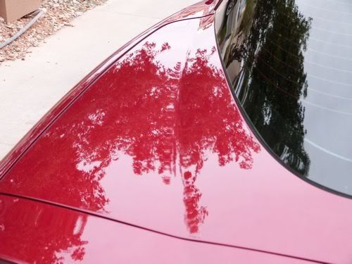

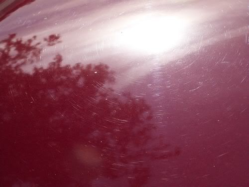

The back hatch was no picnic either...it actually ended up having some of the deeper swirls...but we'll get to what all it took to correct those in a minute...for now just check out the damage
These guys were pretty deep...took some serious work to get them out:

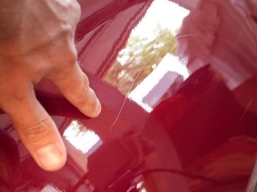

Up on the quarter panel was some good deep scratches as well:

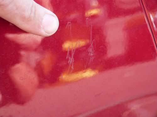

Now unfortunately there was some damage we couldn't completely repair. What do you get when you take an a**hole with no life and give him a set of keys? You get this:
There were two of these guys on his passenger rear QP. I spent extra time on these to try to remove them but they were just too deep to go after. They got lighter, but didn't get completely removed. Neither did this...looks like someone actually kicked it with their heel:
I was hoping it would come out but...no luck...this was lower on the same QP.

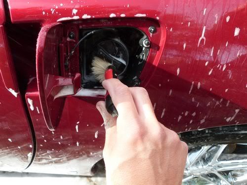

Having a little detail brush is good for getting the dirt out of the tight spots...like the gas chamber:

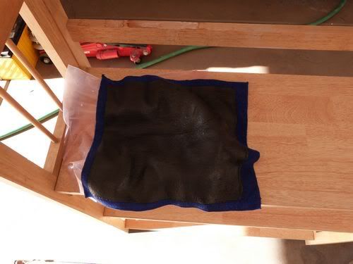

Now it was time to clay...except...i wasn't going to be using clay today. Nope...I was going to be trying out a new product put out by SM Arnold called the "Speedy Surface Prep Towel".
It is microfiber on one side and sort of a rubbery type of substance on the other...hard to describe but take a look:
I rinse it out in warm water first to sort of 'prep' the towel...seems to help it work better...its still aggressive but not OVERLY aggressive. The FIRST time you use it...its going to be pretty damn aggressive so what i do is i 'break it in' on the front windshield to get all the grime off of the windsheild but also help to get rid of that initial extra bite it has when you first use it. It doesn't take long to break it in and then its good to go to the paint.
The cool part...you can fold it into quarters and thus have 4 sides to work with:
You want to keep this thing LUBRICATED on ALL sides...the side you're using, the side your hand is on and DEFINITELY the sides that are folded onto each other. If you don't then you're going to have a real fun time peeling it off your hand or peeling it apart from itself. DO NOT use it dry or even dryish on the paint, it will leave a nice trace of the rubber on the paint that you will then have to work to remove with the same towel that put it there to begin with lol. Doesn't do any damage, just creates extra work. I got mine from ADS a couple weeks back and so far i like it. Its pricey, but re-useable many times over AND you can use it on trim and its very easy to get into tight spots where as with clay, you can't use it on trim because it would leave bits of clay all over...and using it in tight spots risks the same thing...leaving bits of clay wedged into areas that then takes extra time to remove.
If you get it, be sure to do a test spot on the vehicle you're working with. Clay an area and then check with the light to see if there is any light marring left. So far i've had only one vehicle do this...and it was the first time i used the cloth. But because I did a test spot, there was only a small area of very light marring.
After that i've used it on quite a few vehicles, including this Vette, which is red and would be VERY easy to see if any marring was occuring, but none did...so we were good to go!

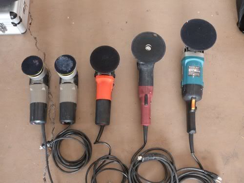

Now it was time to choooooooose your weapon!
Aren't they pretty :-D
I forgot to put my DeWalt rotary there too, but it ended up saving me some time and getting a good amount of use.
For this bad boy I ended up going with the Makita rotary with a 6" Lake Country Hydro-Tech Caynne Cutting pad and some Meguiars 105. Yes, the clear coat was THAT hard and the swirls were THAT bad.
This would be my first FULL correction using just a rotary for cutting. I had done bad areas on certain cars that needed the extra cut of the rotary, but this WHOLE CAR needed it. And since I would be using the Makita and DeWalt (I hooked the DeWalt rotary up with a 4" cutting pad for small areas) that meant my sister would have her first crack at the Flex 3401 to follow up behind me and do the polishing after i was done compounding.

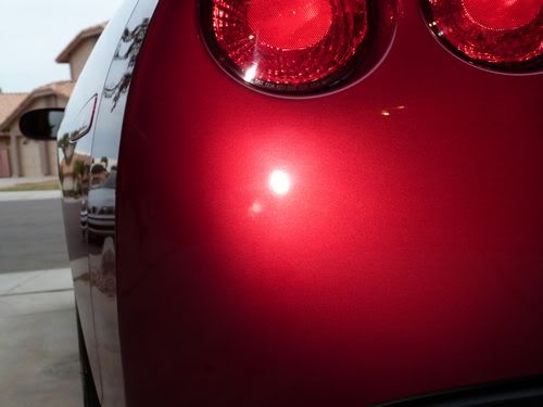

So, I did the best i could with the sun gun to show the 50/50 shot.
Left side is done, right side is not:
A big closer...
Not the best and clearest pictures ive taken but...you can still see the difference. Our neighbor came over about the same time and we showed it to him side by side and he was blown away...i think this was the final nail in the coughin for him to finally have us come do his black Silverado.....but thats another write up :)

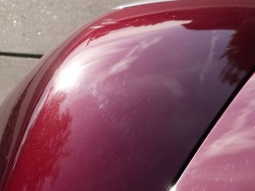

We got to about the half way point...which was the trunk...and THIS is where i ran into those deep scratches i mentioned earlier....you can really see how deep they are in these pictures:
Yeah..see thats not even my sun gun...thats just our little over head light in the garage!
With the sun gun, the true depth (literally) of the scratches really showed up:
As you can see, this was the very thin area right in front of the spoiler. This is where the DeWalt and 4" pad earned their keep.

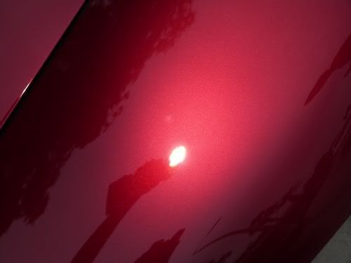

I had to go over this area three times to fully cut the swirls out..they were that deep...but i was finally able to get them to level out and get that area to match the beauty of how the rest of the car was starting to look:
Mmmm...glossy!

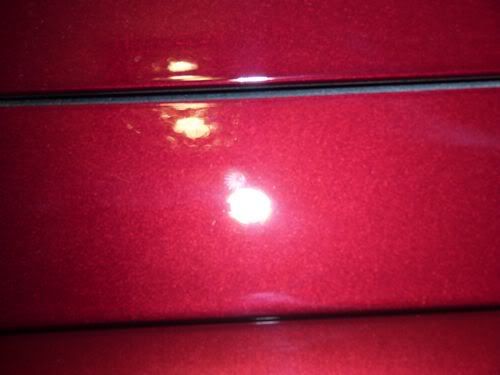

Now let me tell you something about cutting with a rotary...you're gonna get SOME holograms when you're going this aggressive with your cut. So after you follow up with your polishing step (in this case, Meguiars 205 Polish on the Flex), its very important to not only check your work head on and up close to make sure the haze is gone...but its EQUALLY important to stand back at a distance with your light and move very slowly side to side over the entire panel. And then...even if it looks good...LOOK AGAIN. I found holding the light at a slight angle, so it is INdirectly hitting the paint...was a very good way to check the paint. The reason is because now the light is slightly dimmer...still bright, but not so bright that it can cause too much of a glair in the exact spot you're shining the light...which can actually blind you from seeing a small hologram.
Note, looking for a very SMALL hologram, is a whole hell of a lot harder than just looking at a car that has been hacked by someone with a rotary..where you could stand 50 feet away and be able to tell "Wow, someone used a rotary on that and left holograms/buffer trails EVERYWHERE". No, its not like that...this is harder...because you're now looking for very small spots where...maybe the person doing the compounding (me in this case) allowed the rotary to stay JUST a bit longer in one spot than the rest of the section that was being polished at the time...or maybe the pressure was slightly uneven and cause the pad to level out one area a bit more than the other....we're talking a small area here...maybe the size of an apple...maybe smaller in some cases. Or maybe the person doing the polishing (Dani in this case) didn't quite get ENOUGH pressure in a certain area and thus didn't completely remove a hologram left from when the compounding was done.
There are a lot of varriables because...even if you're careful, which we are, and even if you're pretty good...which i think we are (note i know there are 20 and 30 year vets out there that could run circles around us...not trying to be cocky here), you're not perfect....things happen...not BIG things but little thigns like described above. And i think the best thing you can do is realize that hey, no matter HOW good you are, little stuff like that can happen...its not the end of the world and its surely not doing any damage to the car...it just means you have to spend a little extra time checking your work and being humble enough to know that you COULD have missed something.

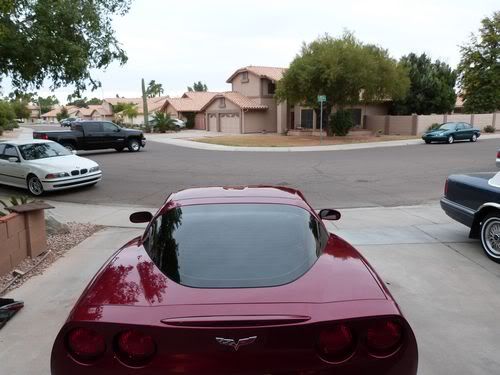

And now, the time had come...to see the finished product. Jim had arrived just as we were finishing the wax...it looked like a possible storm was coming...but we asked if he would mind if we grabbed a few after photos before he took off...he kindly agreed....and so here is what we had accomplished that day in about 8-9 hours (16-18 total working hours between the 2 of us)
I say you can put it next to any Vette sitting in a showroom right now and it will outshine it, but maybe im being prejudice lol :)
Remember how i said that wax was worth its price...well...this is why...look at how liquid the paint is.
Even the shaded side had insane gloss:
Heres a BAM IN YOUR FACE shot:
You can't ever tell it was riddled in bugs and grime can you?
And of course, most importantly, we have to show you it looks good in direct light, so take a look:

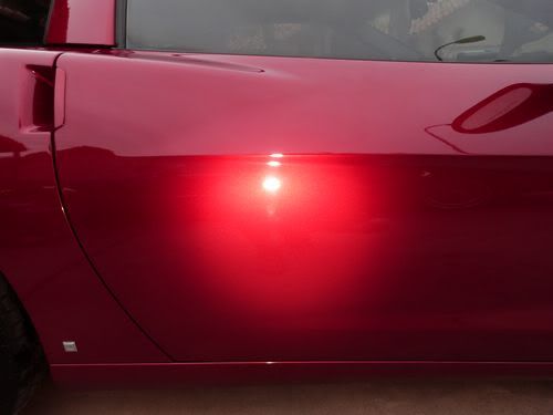

And as for that horribly swirled up Quarter Panel seen here:
No more:

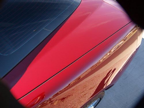

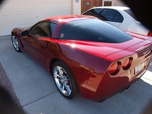

And the owner was nice enough to send me a couple sun shots a few days later:
Lookin sweeeeeeeeeeeet I'd say.

How did the keyed areas turn out? I hope everybody noticed that "just terrible" flaws like those sorta fade into insignificance once the overall vehicle looks great.
You knwo i didn't PLAN on getting into all that when i first started writing the write-up...but i just kinda got led there by what we went through just to be sure we didn't leave any holograms..checking and double and triple checking to make sure it came out right.
Those keyed areas were not completely removed. The really long one ( i believe the one furthest up on the QP) came out much lighter...it was the shallowest of all 3...but it still caught my nail. The other two however were all the way down and only touch-up paint could correct them. But like you said, the rest of the ride was SO nice that those spots that were serious eye-sores then became much less significant.
