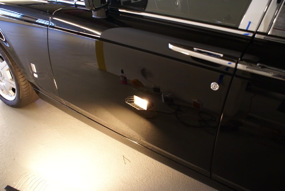

MORBID nailed it on the head...actually everyone is fairly right here, the only way you can get a perfect relection is to eliminate the orage peel...thats where we come in!! That Bentley is perfect. The reflection is soo crisp...i looked at it, and I thought it was just a wall at first...then I saw the wheels!
