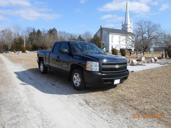

On a *metallic* black like that, for a paste wax I'd probably go with Collinite's 476S instead of their 915. On my Yukon (when I used wax on it), I did Collinite 845 first, lived with that for a while, and then decided to use the 476S on the painted parts (note that the 845 is fine on trim/exterior plastic/etc.). I'd definitely go with some kind of LSP-based approach on the exterior plastic anyhow, and 845 is good stuff.

You saw a noticeable difference in the metallic with the 476S? Man I wish I had a local place that sold this stuff. I will get the 845 for the plastic!

Clarification- I've never used 915! But it's not something I *would* try on metallics as the higher carnauba content would not be a "plus" in that case IMO. I would only use that wax (instead of one of their others) on a non-metallic black/red/dark/rich color. For metallics I *do not* want a whole lot of carnauba as the "alternative ingredients" make metallic paints look better IMO...they don't mute the flake the way carnauba can (OK OK that's a generalization, spare me the flamejobs you pedantic carnauba fans :chuckle: Hey, I use Söuveran on my metallic Jag).
You may very well like the 845 on the paint all by itself, give it a try by just doing the whole vehicle (trim and all) with the 845 and see what you think. You can always go over it with the 476S if you like later. Nothing at all wrong with 845 by any means.
I pretty much *always* do Collinite that way- 845 first and then 476S later.
You might find that you *prefer* the slightly "brighter" look of the 845, some do/some don't.
One thing though, I found that the 476S, on that particular paint, was quite prep-dependent when it came to how it looked. I appliedit once and though "eh, that mutes the flake". But then I repolished (doing a better job) and tried the 845-then-476S combo again and it looked great! Heh heh, as I said, I found it to be a tricky paint to get just right!
Oh...with 845, shake shake shake until it's as thin as milk. There'll probably be a "plug" of wax in the neck of the bottle; poke that down into the rest of the product and shake shake shake some more. Running warm/hot water over the bottle is helpful too. Apply it nice and thin, and on trim I like to buff it off before it completely dries..though that's not a necessity as long as you apply it thin thin thin.
