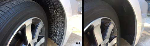

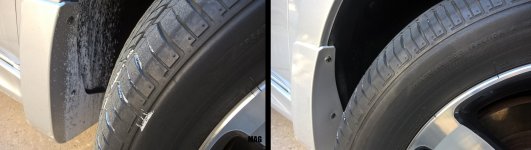

The GF ran over some freshly spilled paint on the road, so i spent my morning getting it to at least 90-95% and then gave the rest of the car the weekly wash.
After removing the great majority if not all of the paint, i polished the areas by hand with some HD Polish and re-applied sealant along with re-dressing the fender wells and tires.
