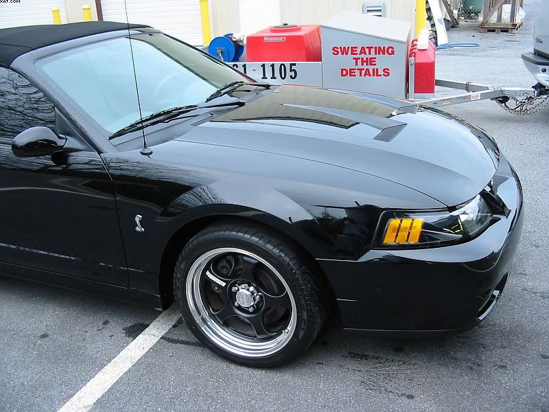

Here is an '03 Cobra I worked on using #80, PwC and EX-P...
I like using PwC almost as a Glaze after polishing to remove any haze...it darkens the paint as well (PwC Blue even more so). Topping with EX-P doesn't add any more depth or color but brings out lots of wetness and gloss.

i'm not into mustangs as much as i like luxury cars but i would take a mustang like the one pictured above in a heartbeat. btw nice detail.
