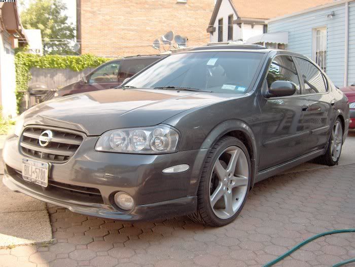

First up, 2002 Maxima. Full body kit, drop, 19" rims, stereo, etc. The paint was reasonably swirled and had a TON of bonded contaminants. I spend a lot of time claying which tipped the clock a little past where I wanted to be. The interior was pretty simple so no need for pics, but the exterior consisted of the following:
-NXT Wash
-PB Clay with NXT Wash lube
-The Big "O" polish with a LC Cutting pad via rotary @ 1500 rpm
-The Big "O" polish with a LC Polishing pad via rotary @ 1500 rpm
-Menzerna FPII with a LC Polishing pad via rotary @ 1500 rpm
-UPP by hand spit shined with OCW
-Rims/tires/wells cleaned with Eagle One Pro Wheel Cleaner
-Rims sealed with AIO/OCW
-Poorboy's BnB on tires
-Meguiar's Hyper Dressing in wells
-Flitz and #0000 Steel wool on exhaust
-NXT Glass Cleaner on windows

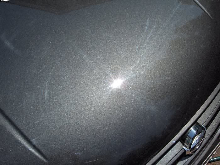

Before
Notice the dullness all of the contaminants brought to the surface
This is after washing, claying, drying...notice the amount of swirling

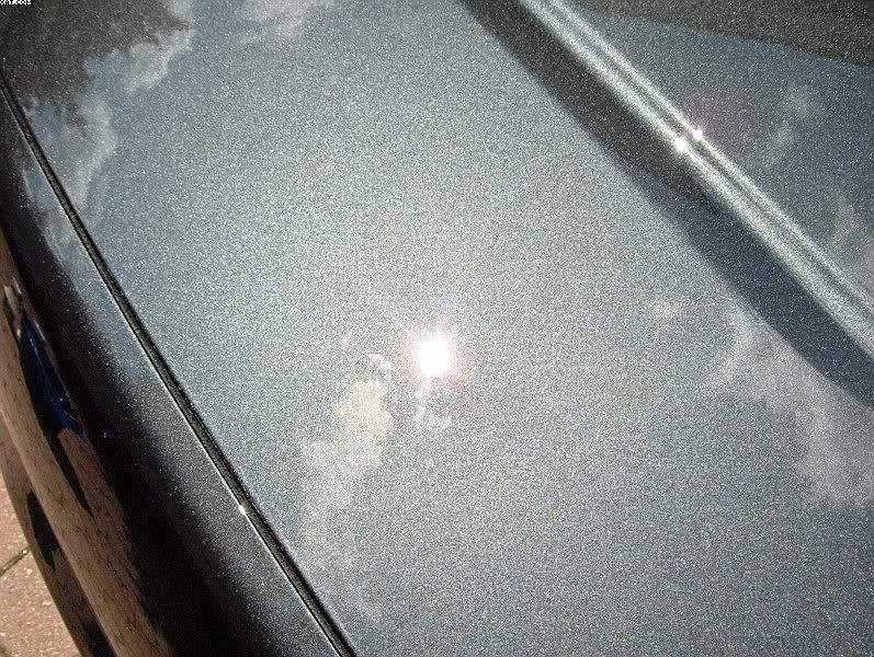

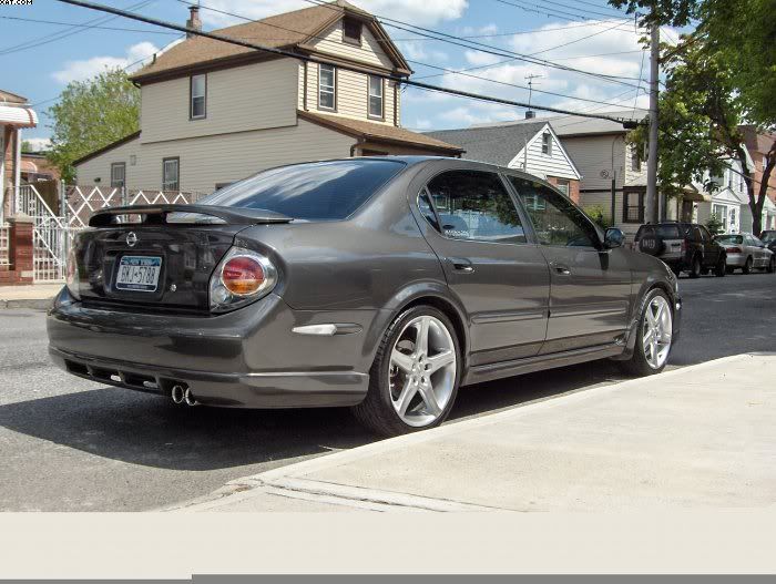

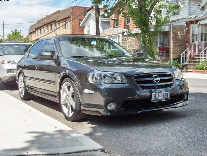

After
Flake is JUMPIN!

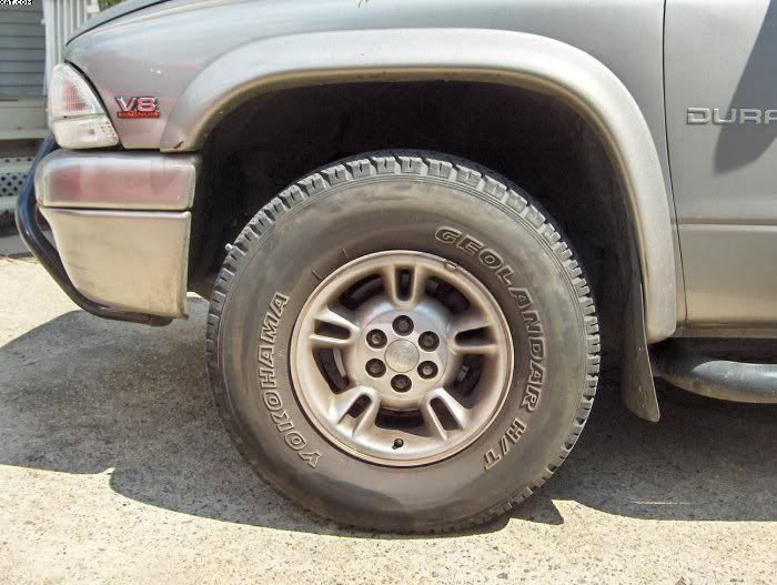

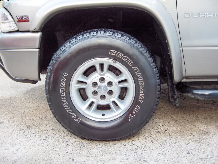

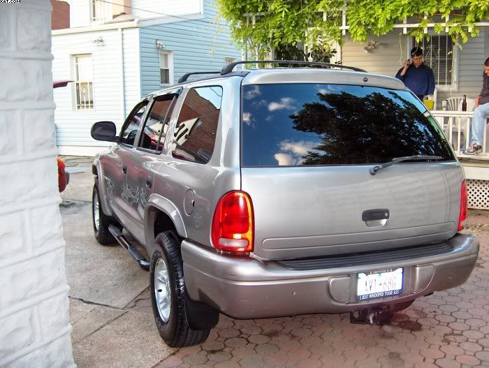

This won took the cake for the dirtiest exterior I've done. The rims/tires/wells took cleaning x 3 and still were not perfect. I have also NEVER picked up soo many contaminants on any vehicle. A combination of IFO, brake dust, overspray, etc made for a sandpapery finish. This is the first time claying has made a signifigant optical difference from a distance. Anyways, interior was remarkably neat (just lightly soiled and dusty), so no pics there. Finals on the exterior:
-NXT Wash
-PB Clay with NXT Wash as lube
-Menzerna FPII via rotary and LC Polishing pad @ 1500 rpm
-Meguiar's #20 Polymer Sealant (thanks to 1 Clean WS6 for using this on the silver 350z last week...looked AMAZING on silver)
-Rims/Tires/Wells cleaned with Eagle 1 Pro Wheel Cleaner x 3
-Tires, wells, and mudflaps dressed with Meguiar's Hyper Dressing cut 2.5:1
-PB Trim Restorer on black plastic
-Flitz on the headlights
Before

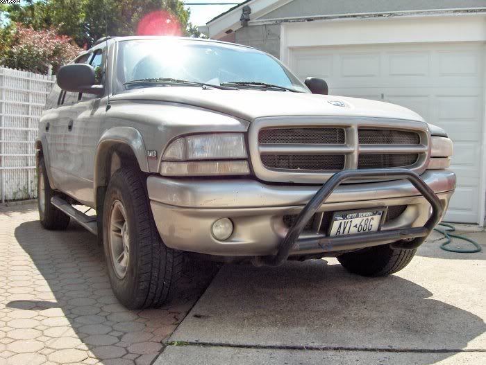

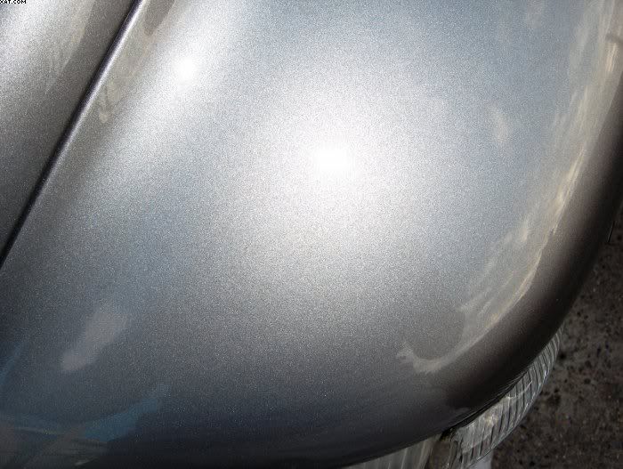

After
Before
After
Please excuse the wheel wells that would not come 100% clean :(
More Flake :D
