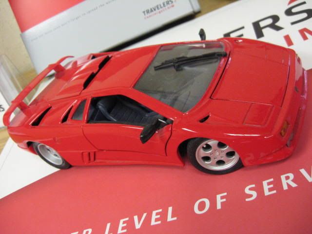

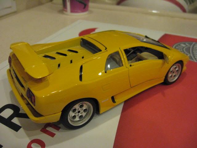

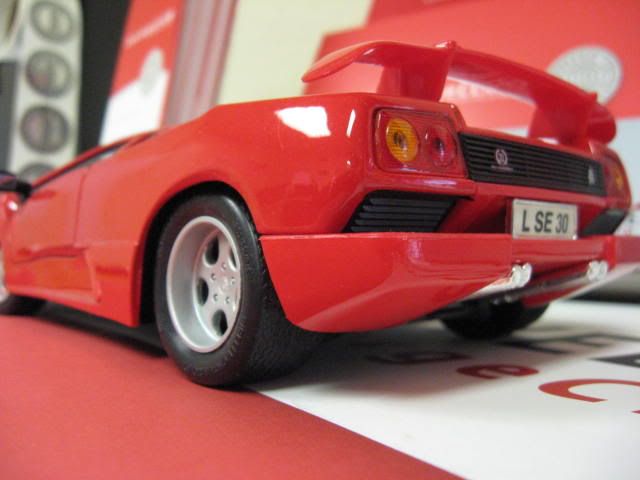

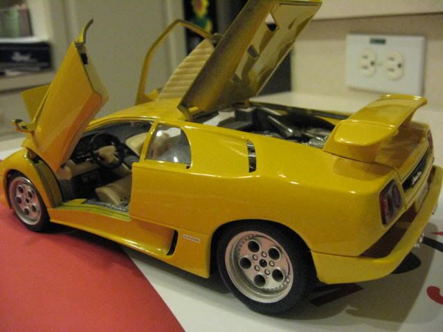

These are the only 2 Lambo's I've ever been allowed to touch so far::chuckle:

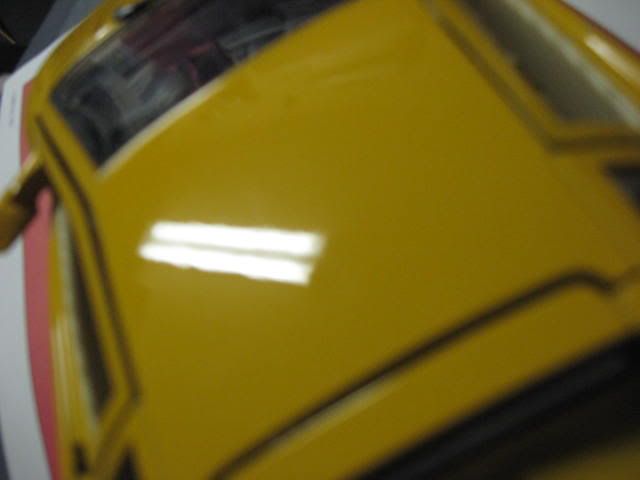

Here's some wetsanding I did to remove OP:
Scratches came out with 106 by hand via a dirty cotton towel. :grinno:
