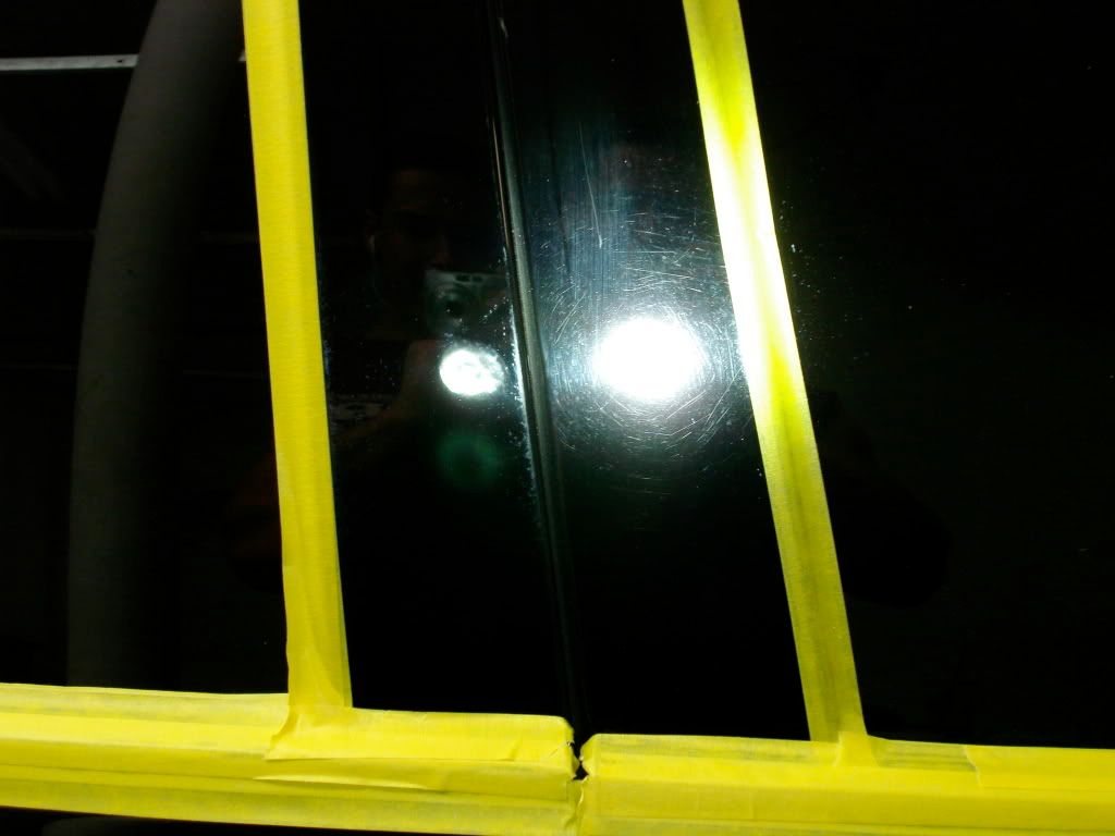

What polish(es) did you use on the B pillars and the smaller rear window columns? I noticed that you taped around those so I assume that you polished them too..
Yes I did, here is 50/50 of the B pillars which were corrected using M105 and Menzerna Po 85rd
I have a bunch of pics I left out to keep this a very short writeup but I should have included this one.

After over an hour playing with combos I landed on the following
M105 wool x 1 or 2 (2200rpm)
M105 foam (1800rpm)
203s foam
85rd foam
Some 50/50s after compounding
Just showing the difference in color, still holograms and haze in the polished side after compounding
