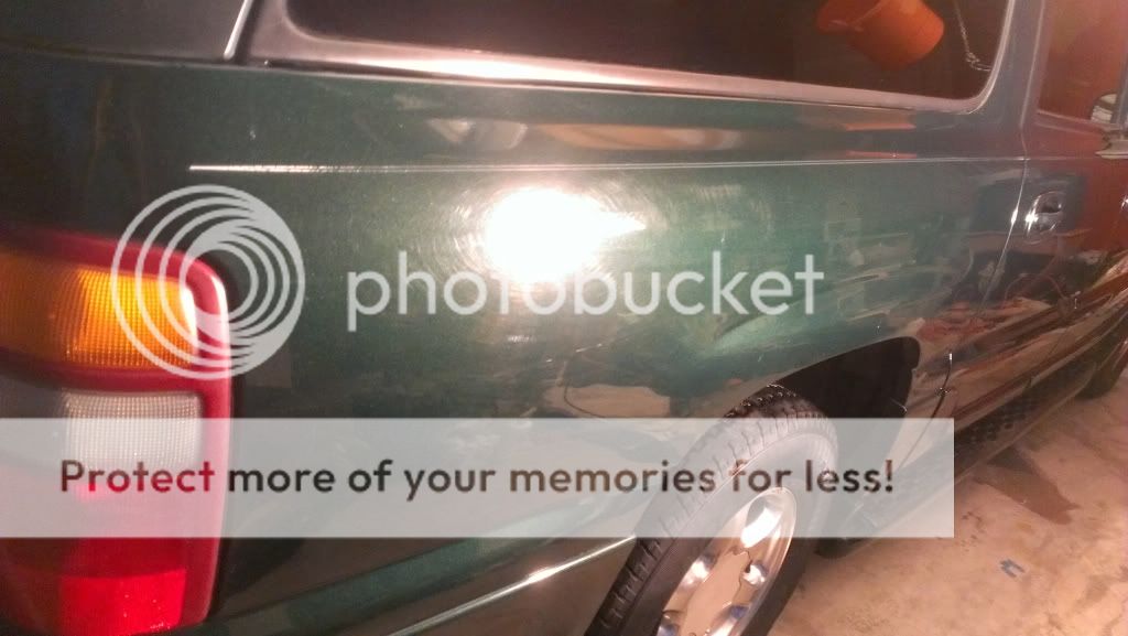

this is a pic of the initial amount i used to 'prime' the pad (which im not even sure is necessary with the rupes pad being open cell?) and then i put three pea sized dots on after every pas and brushing the pad off with denture brush
im thinking maybe its something in the pad because i had the same smearing that was hard to get off when using another yellow rupes pad with pb pws (although it was not as bad) when doing an initial test on the vehicle i am currently working on in my garage
running speed 3.5ish normally..moved it up to 4 and still had the same smearing, and its just a little bit. if i wipe the whole panel and then take the brinkman over it its a few spots almost like someone touched the panel with the fingers and left an oily residue
it comes of with a spray of qd but i did not have this problem initially on the denali xl
