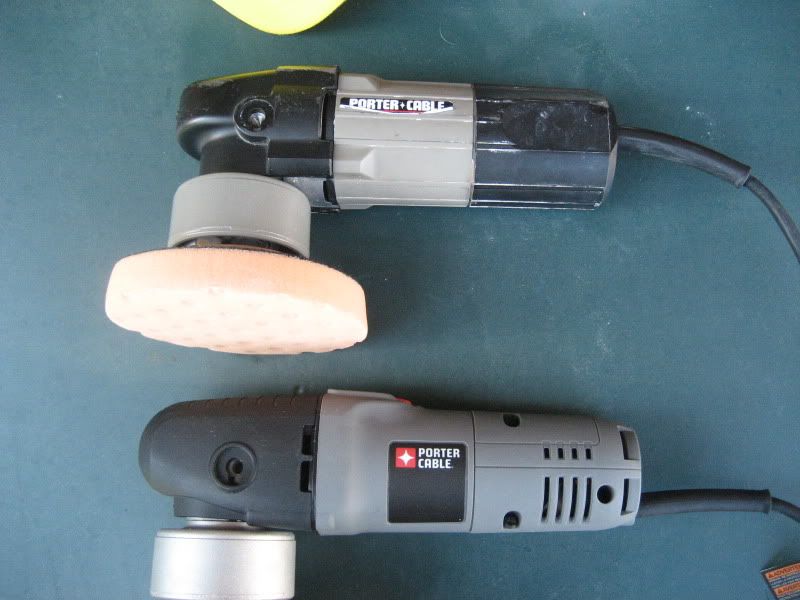

I just got my PC 7424XP and I wanted to do a comparison test for all who might be interested.
Size:
The XP is slightly larger, maybe 3/4" longer. Shaped a little different, more comfortable to hold.
Weight:
XP is probably 1/2 pound heavier, but not noticible when polishing.
Improvements:
The XP has an improved on/off switch. It is larger, red in color, has a more firm feel and is easy to locate.
The overall shape and ergonomics of the new machine are much better than the old one. Even though the XP is 1/2 pound heavier, it is more comfortable to use, just by the change in the shape... more "curvy". Fits in your hands better.
The speed switch is probably the best improvement. It is located on top, rather than on the end. Changing speeds on the fly is much easier and quicker.:D
Power:
7424 - 3.7 Amp Motor
7424XP - 4.5 Amp Motor
This is where the real difference is in the two machines. At lower speeds I couldn't feel or see any difference, but at 5-6, the machine clearly has more cutting power. Any deficiencies that the 7424 has for power, the XP makes up for it.
7424 - Speed 6 OPM - 6000
7424XP - Speed 6 OPM - 6800 (could have been 7000, but still good!)
Working Time:
I did half the hood of a Honda CRV with the 7424 and the other half with the XP. I used and Orange pad and M105 to cut swirls.
As expected, the 7424 took about 10 minutes to remove swirls on 1/2 the hood; the XP took about 8 minutes to do the same work. So about a 20% improvement in working time.
Vibration:
Although I could "feel" the difference in power and torque at speeds 5-6, there is not really any difference in the vibration at those speeds. I would put the vibration equal to the 7424.
FOR MORE INFORMATION ON VIBRATION, SEE POST 21 ON PAGE 3.
Overall Summary:
I am very impressed with the 7424XP. The working time and power are much improved. Not nearly the machine that the Flex is, of course, but for the weekend detailer, hobby detailer, or the professional who needs a PC for small touch up work, it is excellent.
I highly recommend this machine... I couldn't be more pleased!;)
Here are some pictires... As you can see, my old 7424 definitely has some miles on it!!!!:w00t:

Bill, I agree that its easier to hold the new XP when polishing, but IMO the new machine has more vibes at speed 6. That is the only speed I use.
I ended up using M86 for the first time as the one step polish and did not have time to do a a/b comparo between the two as far as corrections go.
BTW thanks to Todd for suggesting the M86, its a very nice polish that fills the gap between M105 and M205.
I didn't really notice a difference in the vibration.
What I really need to do is this... (on my "practice fender" in the garage)... Fire up both PC's at the same time and compare the vibration at speed 6.
I'll give that a try some time and post my findings.:wink:
