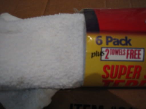

I use these terry cloth towels folded into 1/4s for application as well as removal. The areas I do are usually large so they usually become saturated with polish and very loaded up with black oxidation. If i'm feeling cheep i will recycle the cleanup wipe down ones to application for next time. At this price they get tossed after i'm done with them. I've tried washing by hand to get the "heavy stuff off" and then tossing in the washing machine but it makes a mess! Not worth it.
above from Target I believe. Always looking through the clearance automovie when I go with my girlfriend.
Below are from a dollar store.
