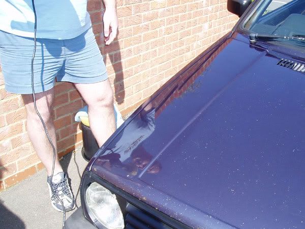

Some Pics.

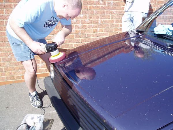

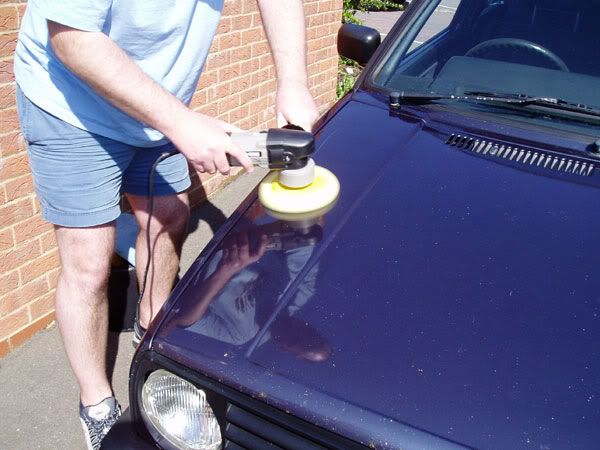

Andy gets to work on the PC demo
Improvement in progress

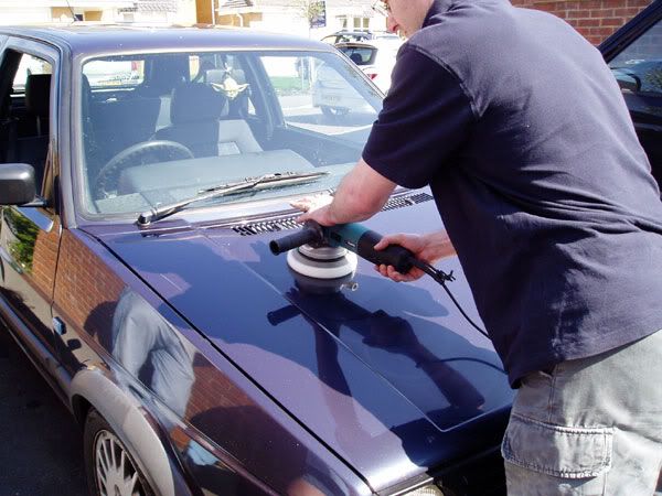

Dave demonstrated the UK alternative in the shape off the Matika
I was impressed how thinly you can apply things with these machines

Makita performed very alike. It was a little heavier than the PC.

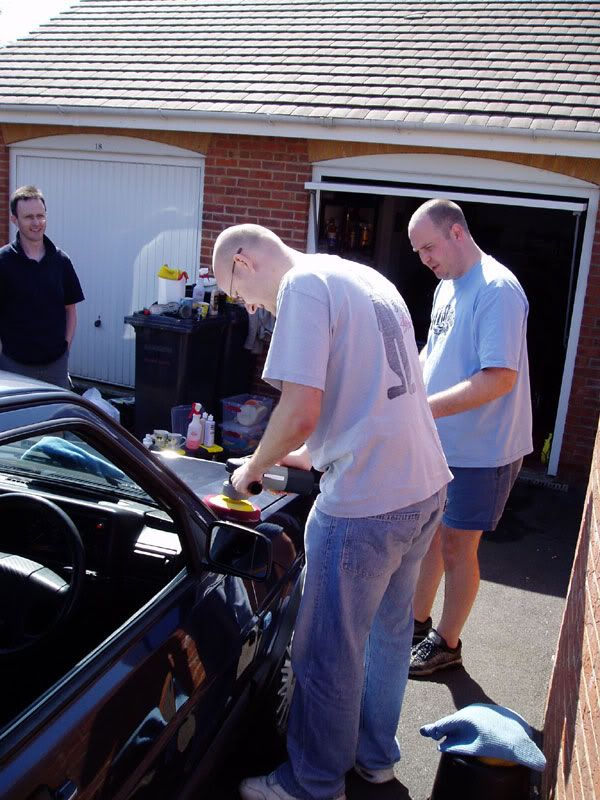

Andy C is in the light blue T shirt.
Paul (nogrille) in the grey T shirt
Dave (butchdave) is the guy on the Makita in the polo shirt.

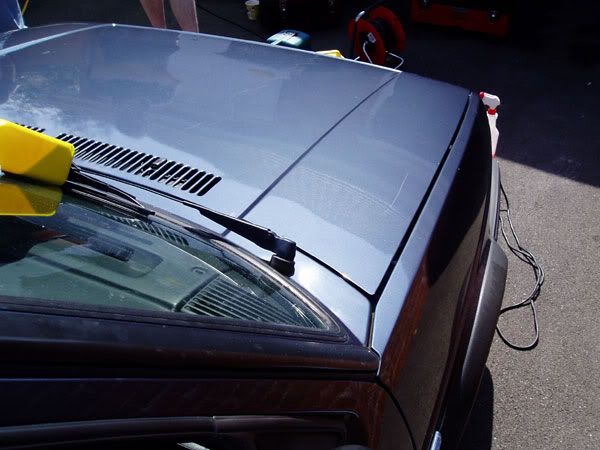

That right hand panel of the bonnet looks and feels SO good! I'll add comments on products used to the pics when I've gone through Andy's list.
