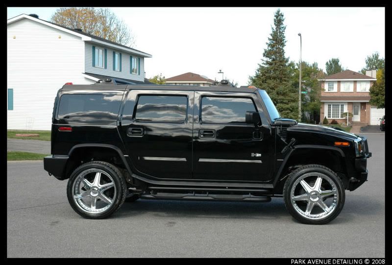

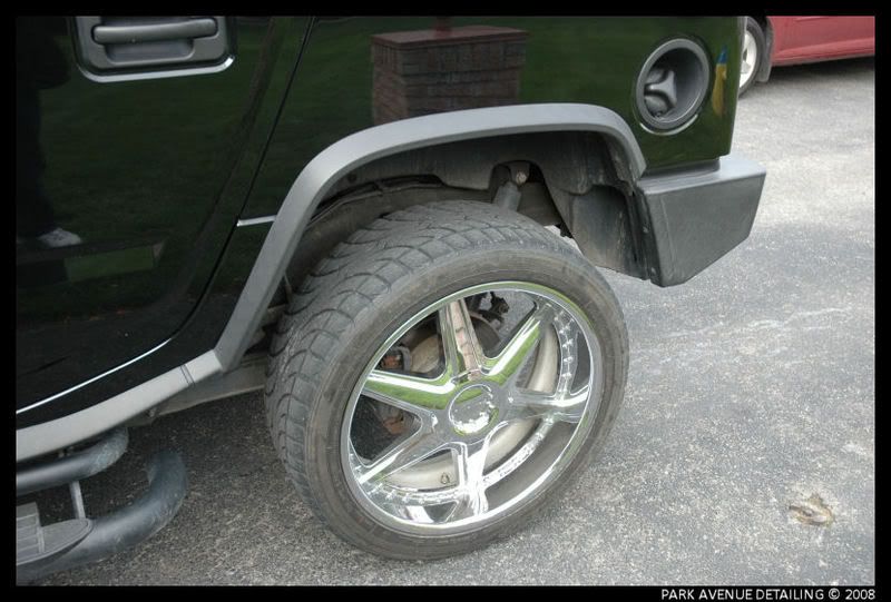

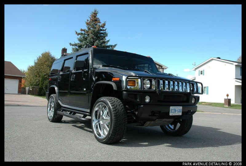

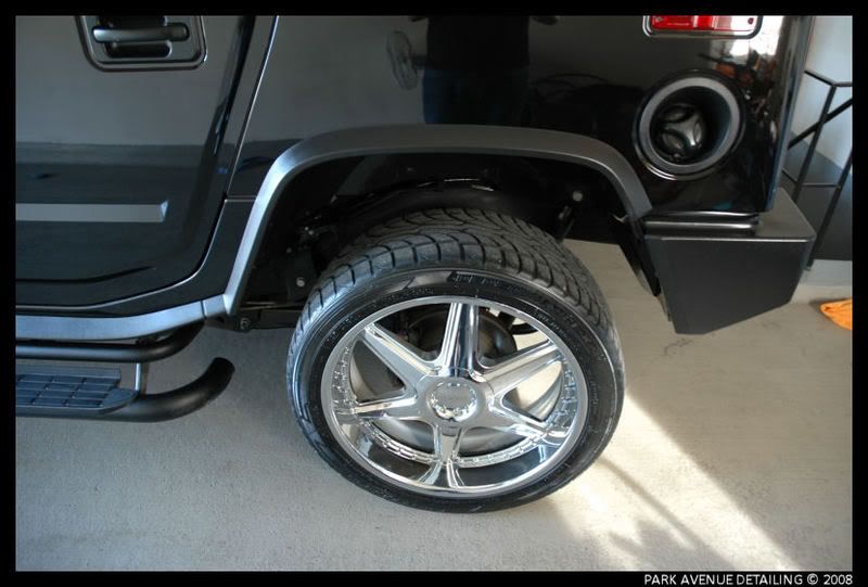

Process:
Wheel's/Tire's/Wheel Well's - Megs WB, Degreaser on tires and in wells.
Everything scrubbed. Tires, trim and wheel-wells dressed with
Opti-Bond via Wagner Control Spray Gun.
Foam - DP Extreme Foam
Wash - Megs Shampoo Plus
Clay - Megs
Tried SIP with Orange CCS and got no where (temps were low)
Tried M105/OP with Orange and got somewhere (easier to work),
but was getting alot of marring. I decided to try SIP/White and that did the trick.
The paint wasn't as hard as I thought it was. So:
SIP with White CCS via Flex
PO106FF with Blue CCS via Flex
PO83 with Blue CCs via Flex
UPGP x2 by hand

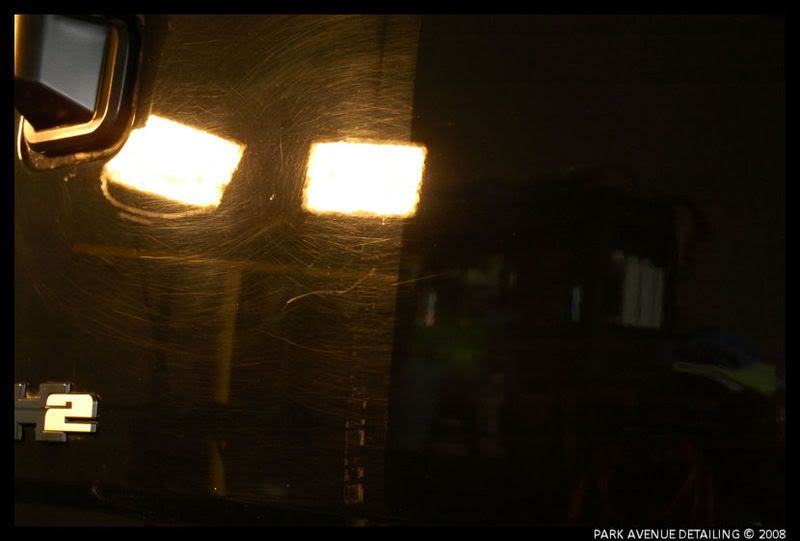

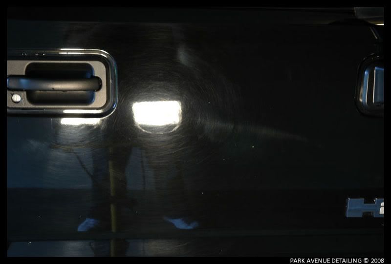

Swirls:
50/50:

Swirls:
50/50:
