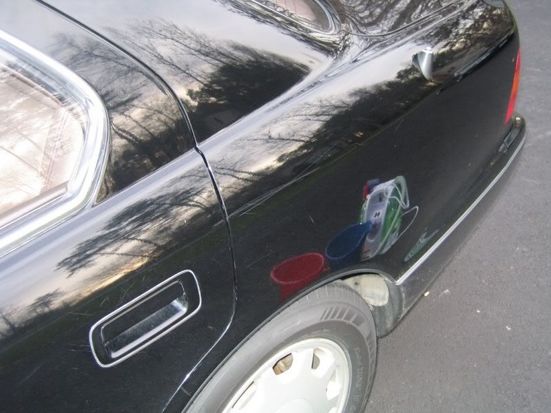

Today I worked on a 1995 black Lexus LS 400 with SS paint. After washing and claying I tried Meg's #80, but didn't do the job, so I turned to SSR2.5 with an Edge 2000 blue polishing pad and it worked wonders!
The only problem I had was the weather - it was too cold and took me 5 passes to get a swirl free finish although once the sun came out for awhile it only took 2 passes but had to stop eventually.
I am going back when weather is above 40
Here is an example for you - what you don't see in the picture is the automatic car wash induced swirls on the sides. They are all over. Of course you can see how oidized the paint is. (don't have any after SSR2.5 pictures.)

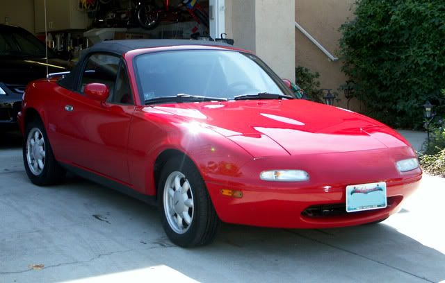

I did a severely oxidized Miata a while back and used mostly Poorboy's products (Pro polish, SSR1, PwC and EX), it worked great:
Pro polish worked great at removing the oxidization.
Here is a side by side with Pro polish applied by hand:
If you are looking to get swirls out you are going to need some type of abrasive polish, a paint cleanser won't do much for swirls. For some of the deeper swirls on that Miata I used DACP and was able to remove about 90% of the swirls!
Here is an after shot:
Hope this helps and good luck!
