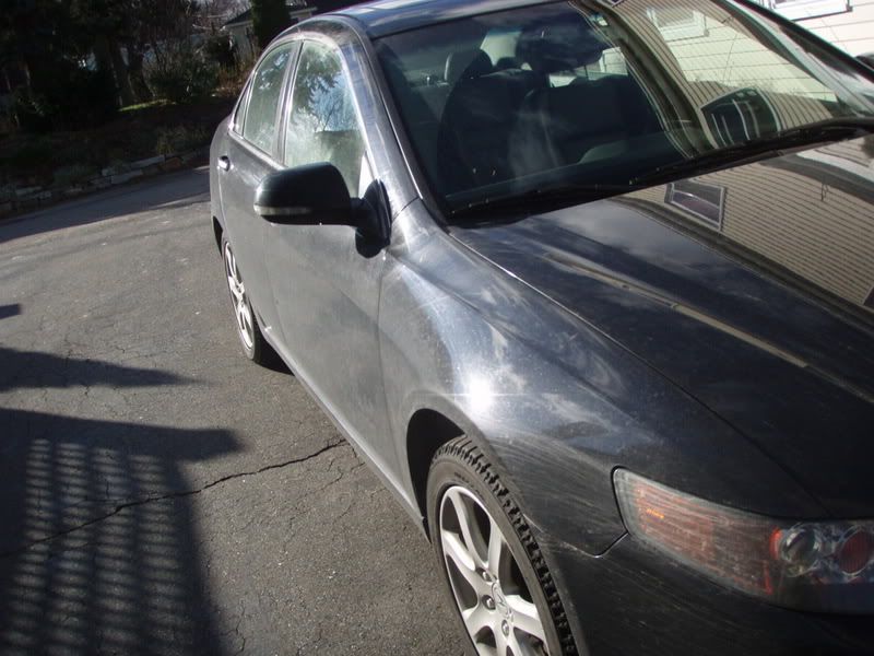

ONR on these? (pics)

This is a RINSE-less wash product. Think about what that means.
When doing a regular wash you rinse twice. First you rinse the car to remove any of the big dirt particles before you take a wash mitt to the panel. Then the soap provides lubricity while your wash mitt agitates the stuck-on particles. The final rinse removes those particles and the soap residue and leaves a clean car. That's how it works.
With ONR, you skip the initial rinse, so any loose dirt particles are there from the start. Then you agitate with a wash mitt or towel (same as conventional wash) and the ONR solution "encapsulates" the dirt so it does not touch the finish while wiping and drying.
Think about it now, an ounce of ONR can only "encapsulate" so much dirt. At some point the amount of dirt on the car may outweigh the cleaning power of ONR. That is why a pre-rinse at the coin op or a run through the touchless almost gaurantees successful results.
Think about it further. The "encapsulation" allows you to wipe and dry without a final rinse. BUT, it does not replace the initial rinse that you would do during a normal wash. If you were doing a conventional wash you would not touch a dry panel without rinsing it first. So what the hell makes anyone think its ok with ONR.
If I was going to attack a really dirty car (like the ones in the original post here) and I absolutely HAD to use ONR I would avoid wiping. I would use as many towels as necessary to wash one spot at a time. That is why Microfiber towels are suggested when using ONR. Because they can loosen the dirt and then absorb the "encapsulated" particles into their thousands of tiny fibers.
Scott - I'm not doubting you. It's clear that you have a succesfull business and produce great results with ONR. However, I would like to see before and after pics of a panel washed with ONR under some halogen lights. I woudl expect to see some marring if the car is particularly dirty. Nothing catastrophic, and maybe not anything more than a regular wash would cause, but I believe it has to be there. Please prove me wrong. And if you can, please tell us your technique. Do you wipe when the car is excessively dirty, or do you "dab" the dirt off turning the towel as many times as necessary to get that spot clean? Mitts or MF towels? What ratio do you mix the ONR? Do you change the ratio if the car is excessively dirty? Two buckets or one? Grit guard? How many times do you rinse the mitt or towel per panel?
Bottom line, ONR can either be a real time and effort saver, or it can severely ruin a perfectly good car finish. There really isn't an in-between. So much depends on tools, technique, patience, and practice. That is what this forum is meant to be for. It's not to have an argument where half the people say "ONR sucks" and the other half say "no it doesn't, you're doing it wrong"

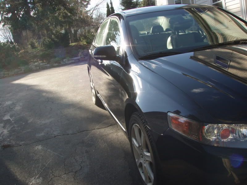

I am not calling you out, what I am saying is that ONR will clean much filthier cars than you would believe possible. I have explored the limits of both QEW and ONR and they far surpassed my expectations. Yes, you do have to pre-rinse a mud caked car and rinseless washes may leave some smearing on paint completely devoid of wax (but ONR does the best in that regard), but just normal filth from driving in the rain is not a problem. It isn't just for well maintained cars and it isn't fair to Optimum, Detailer's Pride or Protect All to suggest otherwise.

1. I have never ruined a perfectly good finish using either QEW or ONR, even on really dirty cars, and a rough estimate would be over 9000+ of the 11,200 cars I have cleaned since I started my detailing business have been cleaned via rinseless washes. If you ruin a finish with ONR, it is going to be operator error, not the product.
2. Yes, good technique and quality towels and pads or mitts will make rinseless washes work their best, just like with conventional washing.
3. When you wash a panel with a quality mitt or pad, you can see the dirt practically melt away and I don't see the advantage at all of a pre-rinse. Plus, with rinseless washing not being soapy, you can see the entire panel and are less likely to miss any areas when washing and drying.
This is a Ford F-250 I regular ONR wash. This picture was taken in March when I last polished it out.
This was in September, waxed a couple times but not repolished. Washed only with ONR at least twice a month, many times in the full sun at his office. And yes, it gets dirty as he has a 80 mile daily commute.
I'd say ONR did a pretty good job preventing marring.
