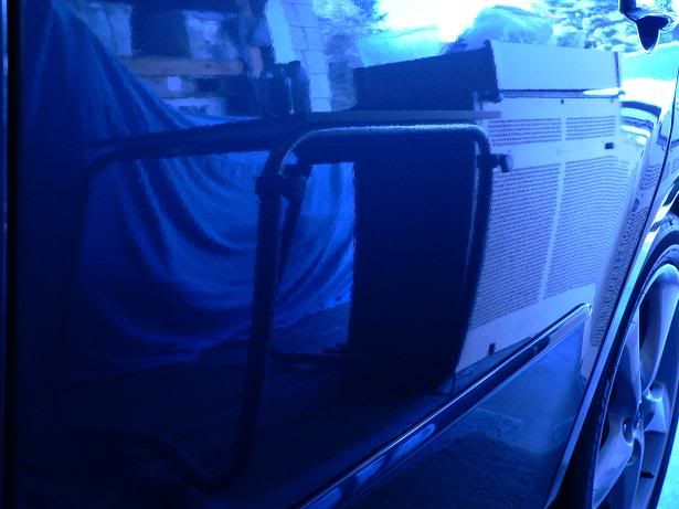

Darn, put a hairline crease in just above the handle, not terribly noticable, maybe correctable, fudge. That's why I'm scared of the PC. Took a picture of the panel looking good. Will post.
Guess the 3 day test is in order. Afraid to look.
Morning after. #7 & PIFxx
Better angle - tons of overspray - not anymore
okay, but I only used the PIFxx on that one panel.
the rest has just #7 and still needs correction.
I'll run it down to the park and see what I can do.
This round of pictures looks like they came out of 110 camera that had been carried below deck across the Atlantic a few times and then traded for hard tack at the docks before being shipped off to Kansas and sitting on the shelf of a Circle T for 14 year before a tourist came along and needed to take a picture of the kiddies at the petting zoo. (( not pleased, I will try again )) The #7 has a nice masking effect, I definately am going to need to do some polishing though.
This round of pictures looks like they came out of 110 camera that had been carried below deck across the Atlantic a few times and then traded for hard tack at the docks before being shipped off to Kansas and sitting on the shelf of a Circle T for 14 years before a tourist came along and needed to take a picture of the kiddies at the petting zoo. (( not pleased, I will try again )) The #7 has a nice masking effect, I definately am going to need to do some polishing though to get the clarity level up.
