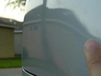

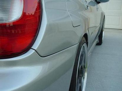

it's not bad at all, they were minor in my eyes... I see cars eveyday with worse! Now the car is almost perfect, except for the right rear quarter panel that I guess the body shop TOTALLY missed with the wet sanding and buffing. It looks like a silver orange skin... arrgh. I may have to break down and get a Porter Cable buffer and wet sand and polish that spot myself. Sooo aggrivating.

thanks I'm going to stop by Proper Auto Care/Classic Motoring Accesories ( http://properautocare.com/ ) in Tampa today at lunch I'll have the guys take a look and see what they think. I've watched the bodyshop guys do it and it seems pretty straightforward, sand then buff out... I had them touch up a few spots from the last time they painted the car.
LOL, oh yeah no problem I could do that too! haha!
Well I stopped by CMA and talked to the GM, Phil, he reccomended the best body shop in town (Gene Perez body repairs, inc.) take a look at the OP, they told me that the car looks good and that if they sanded it it would look like glass and wouldn't match the rest of the car, he wanted to respray it then match it to the next panel, but he reccomended I "save my money, get it out of my mind, and don't worry about it since I am the ONLY one who would notice it" since it truly isn't THAT bad. I guess I'll just live with it...
CMA (Phil) did suggest Menzerna products for my silver metallic car and told me about hitting the slight peel with a mild Menzerna abrasive to knock it down a little vs. taking the plunge with the 2000-3000 grit.
The "live with it" advice sounds very good.
I dunno about polishing it...I've never been able to knock down OP in b/c that way, only on soft single stage. But a bit of polishing probably won't be a bad idea anyhow.
Here's a couple of the mild OP: :mad:
Ah, that's not much, if any, worse than the OP on my Audis (A8 and S8). If cars in that price range have it...
No way would I mess with that. I'd just polish it up nice and shiny (which will make the OP look even worse ;) ) and keep it protected.
