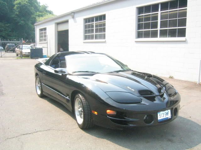

Patrick That picture does not do that detail justice!
on Edit: Now that I think about it .. When I left it on there for 7 hours I want to say that it was a 60* day in september and the car was parked in the garage! Perfect day for a detail!
