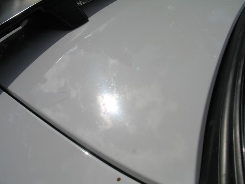

My swirls are back?! WHY
awahl63 said:
Did you see the swirls in the sun or under the halogens?
I'm seeing the swirls in direct sunlight
(sorry the car is filthy but I recognized them immediately :bawling: :help: :(

ok, wash, (the car had been clayed previously), and then chamois the car, dry it up with the microfiber, then I began testing since it was my first time, so I used the optimum compound, with a LC orange pad, on speed 4500, let it haze over, used a microfiber to buff it out, almost all swirls were gone, then I used the white pad with optimum polish, let it haze a lil, then took it off by hand, finally I applied a coat of Poorboys EX with caranuba to the car by HAND and let it dry, etc off with a microfiber....

If the car's just been sitting, and hasn't been touched, then the marring was always there. Must not've been as visible under the halogens as it is in sunlight. That's one reason why I do most of my inspection under high-wattage incandescents instead of halogens ;) It can pay to use multiple light sources when inspecting, less chance of surprises like this one.
In many cases *IMO* there's nothing wrong with a product "hiding" some marring. Just use a long-lasting LSP to seal in the "fillers" and it'll look good for a long time. Yeah, on some cars I'll occasionally polish out all the marring but it's not the only approach for everyone every time. Consider that many (most?) people mar the paint again in short order and if you keep polishing it all the time you'll eventually take off too much clear/paint. A color like that, with a little better prep work ;) can look fine for a long, long time without being literally perfect.
