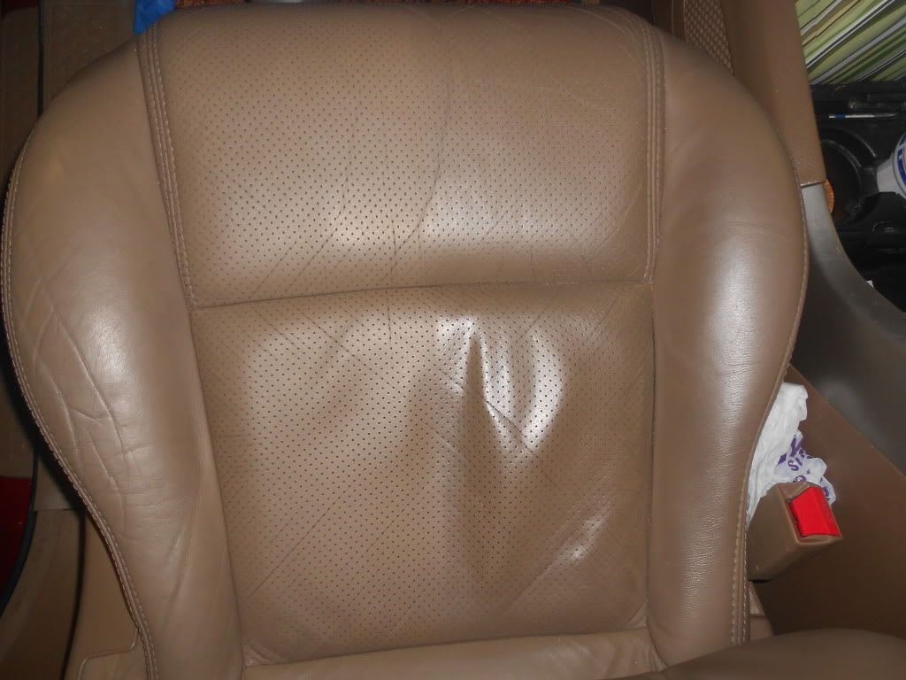

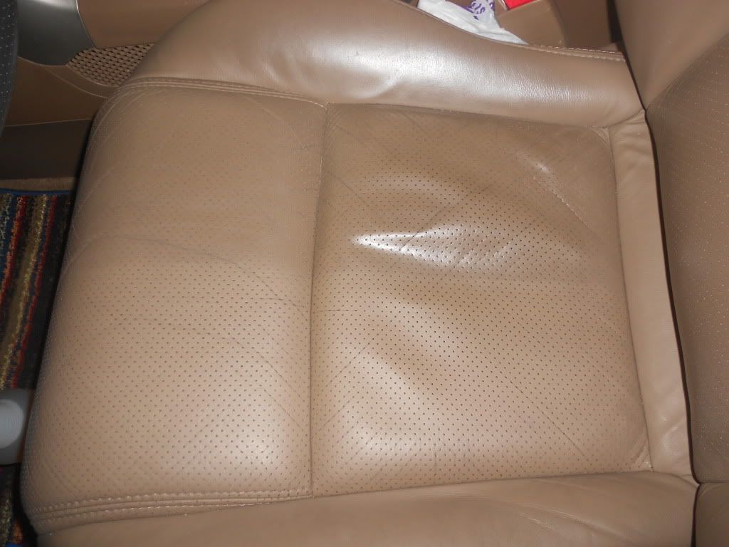

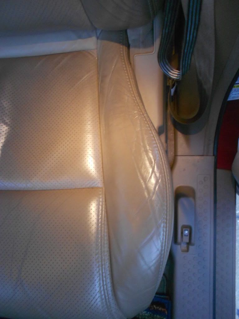

1st 2006 Honda Pilot- 1 step detail and interior leather cleaning- horrific buildup of leather dressing, and never having been detailed there was cracking in the leather.
Swirled paint
Yikes the amount of dressing on these seats
50/50 drivers seat
top down 50/50

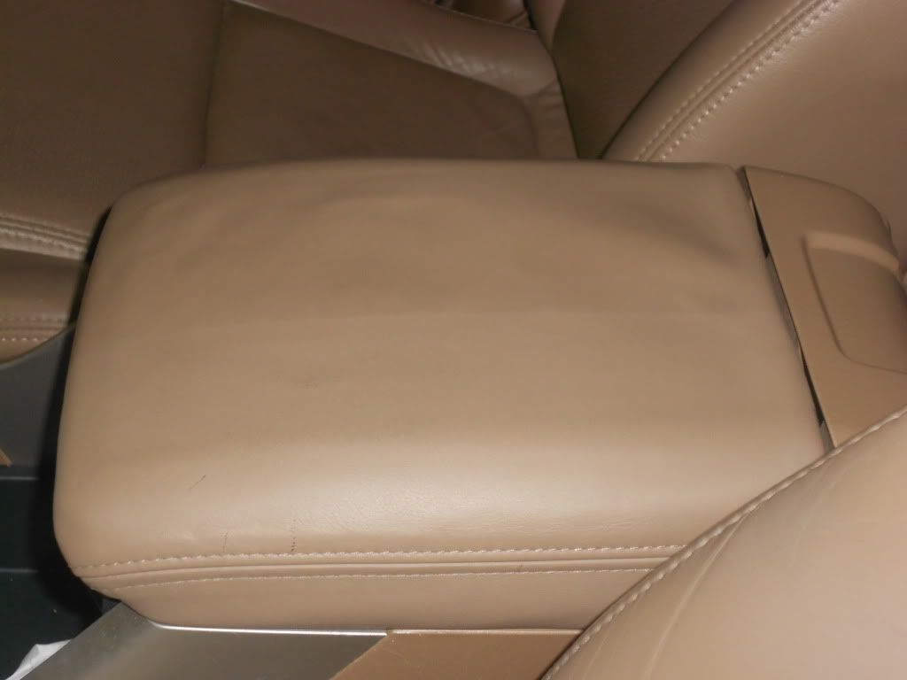

Armrest 50/50
Process for the leather was - Roger Kohs leather doctor products, then even hit them with OPC at 10:1 and a toothbrush.

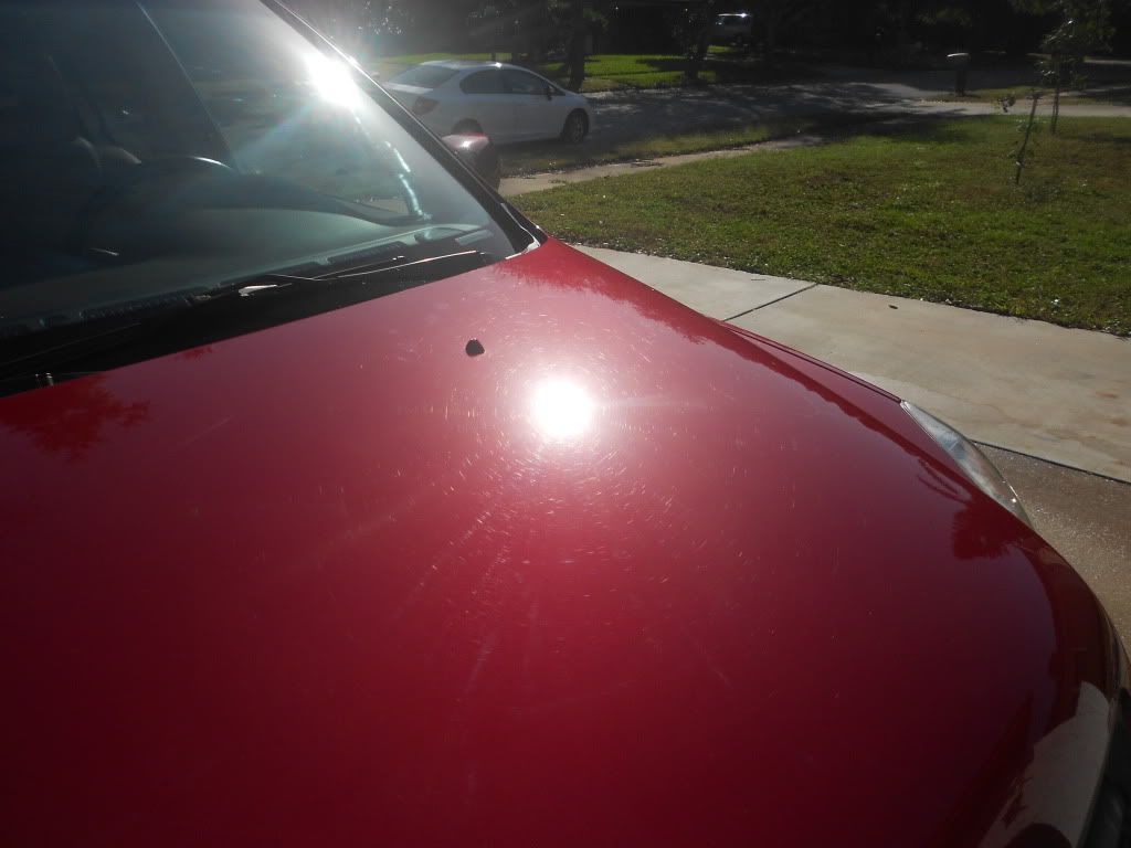

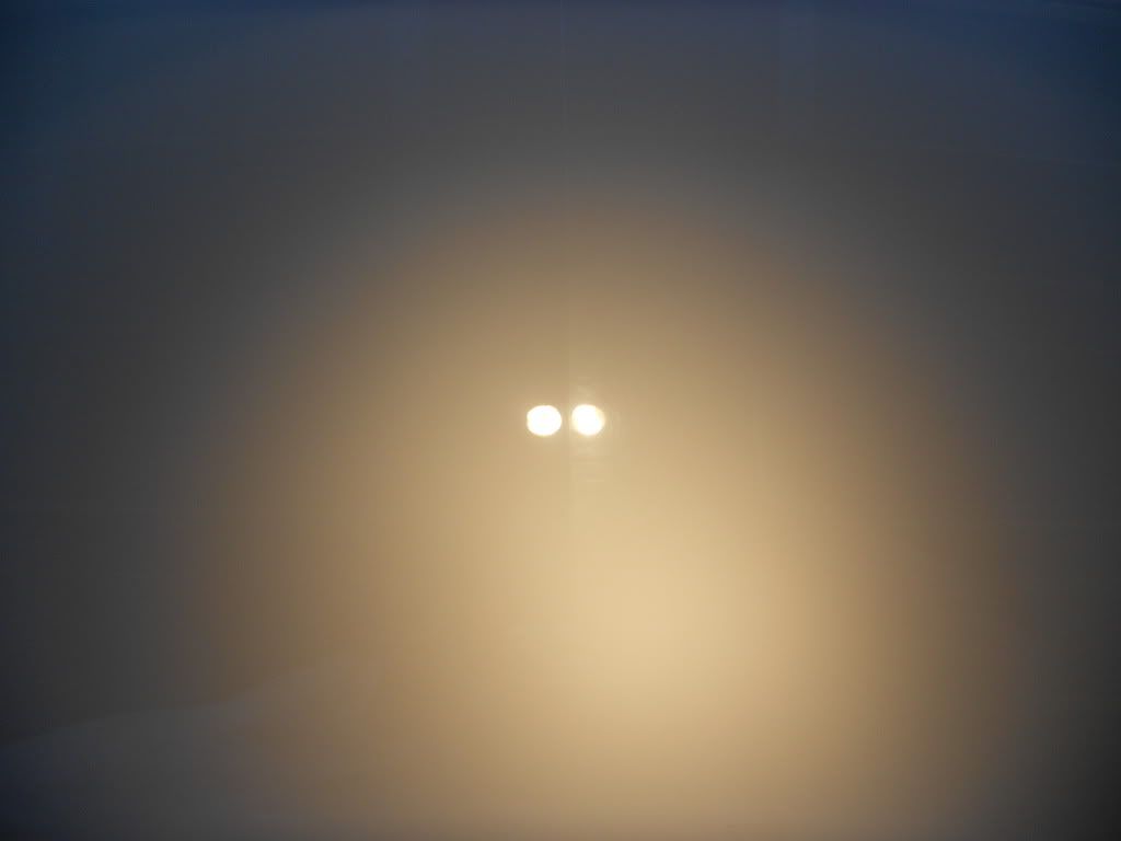

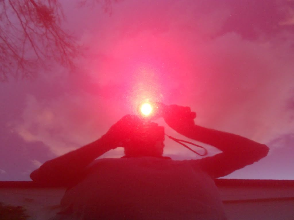

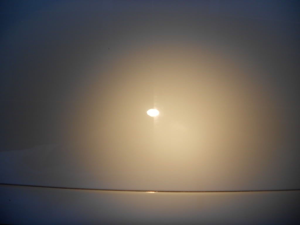

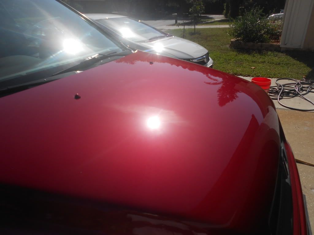

Exterior Sun shot before
Sun shot after - Process was UNO on HD OJ with FLex. LSP was Detail King Supreme SHine sealant thanks to Bud for the free sample! Really liked this product and it really was very easy to work with. Id say about solid 85% correction

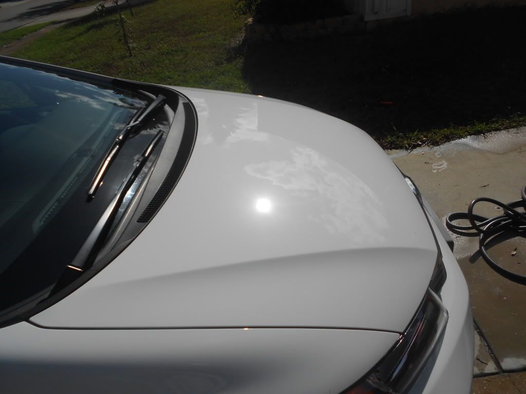

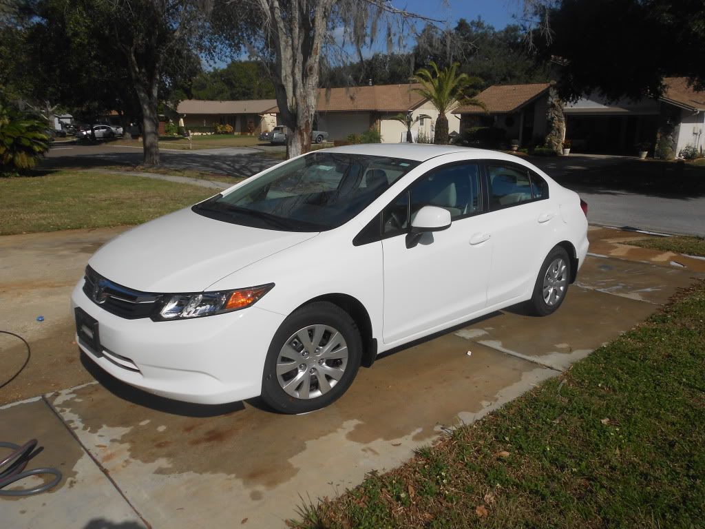

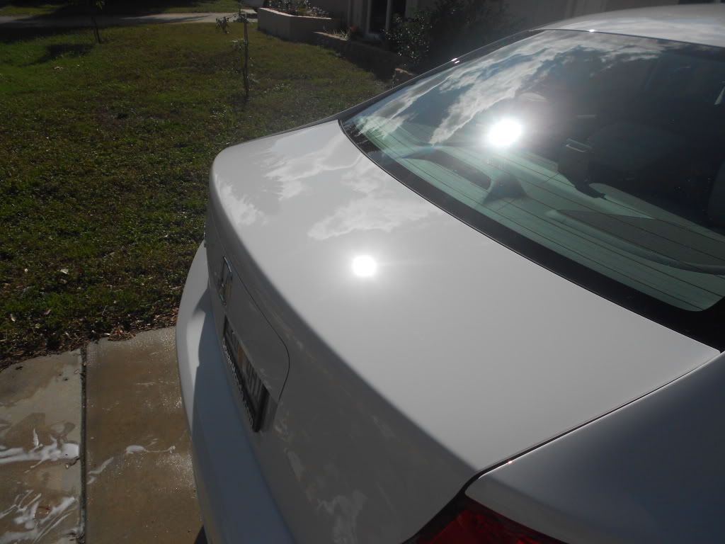

2012 Honda Civic New car Prep + Cquartz treatment. Car is off to a great start.
Simple process here just went with PO85RD on Green HD Pad with GG DA after a good wash and claying. Customer brought the car to me completely filthy right off the lot and insisted the dealer detailers DID NOT touch it at all! Just great
Final Pics

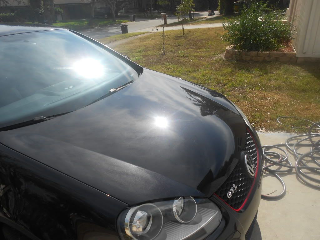

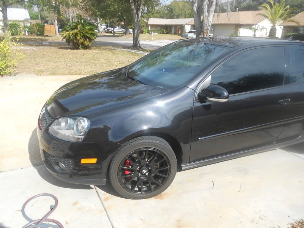

My car - 2006 VW GTI - Full exterior detail, my daily driver, FLex with HD OJ pad SiP, finished down with Uno on Green HD pad, Opti-coat 2.0 (because my baby deserves it) Only a couple pictures of the finished product.

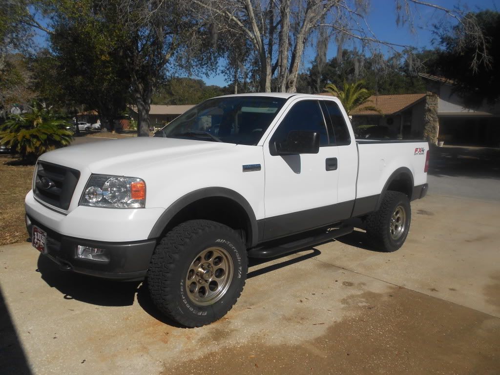

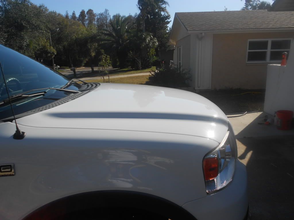

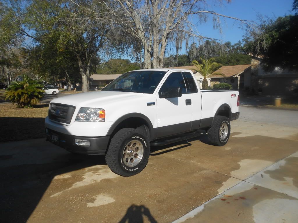

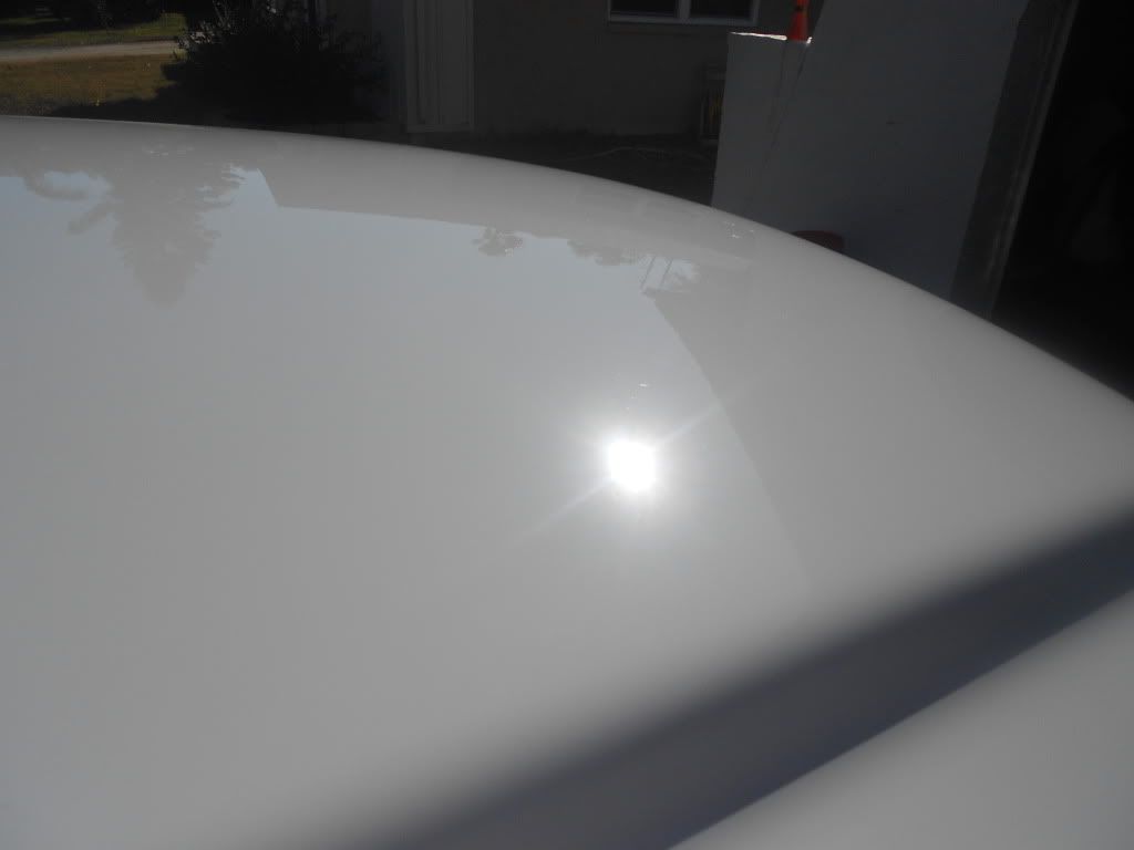

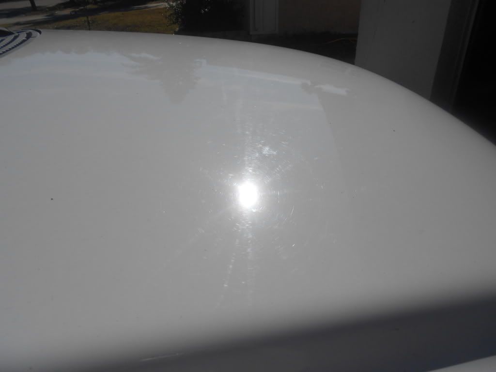

2004 F150 upon arrival - Polish - Uno on OJ HD pad with Flex - 1 step polish long time customer just purchased this truck used - LSP BFWD
50/50 of hood
Finished truck
About 80 - 85% correction.

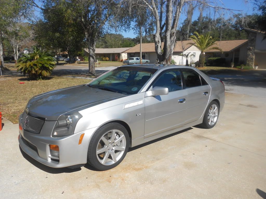

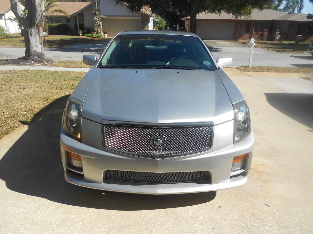

2006 CTS-V
Went for a ride in this bad boy before...man...scary fast. Only finished pics this was a looong detail. FLex with OJ and SiP 2-3 passes, Uno on OJ with GG DA to finish, Cquartz LSP

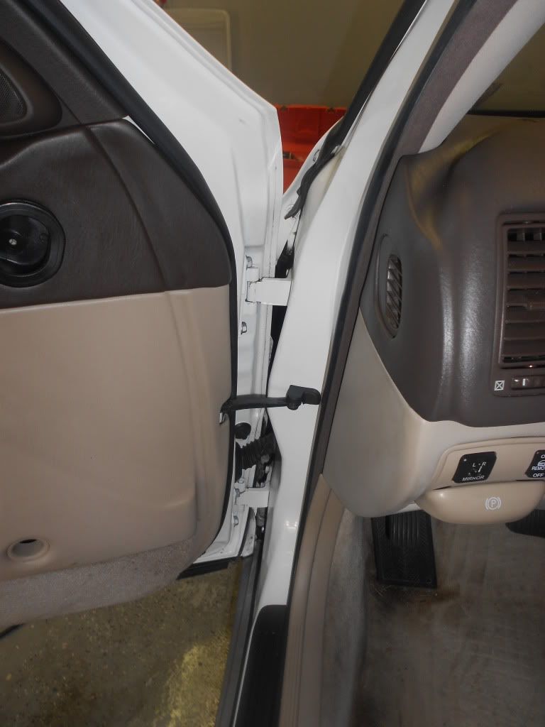

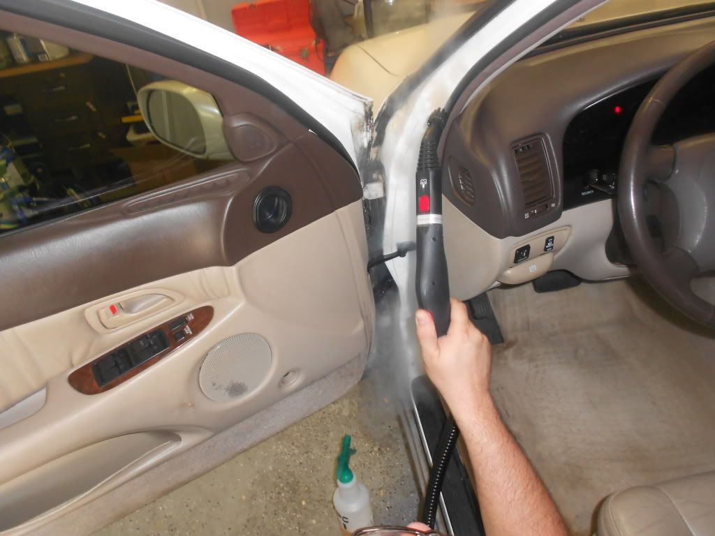

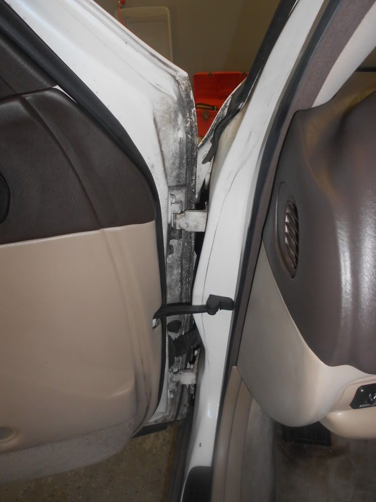

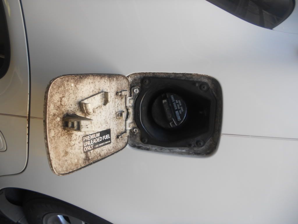

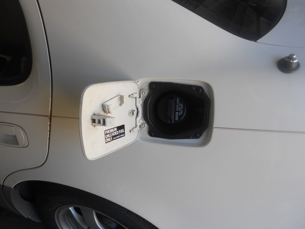

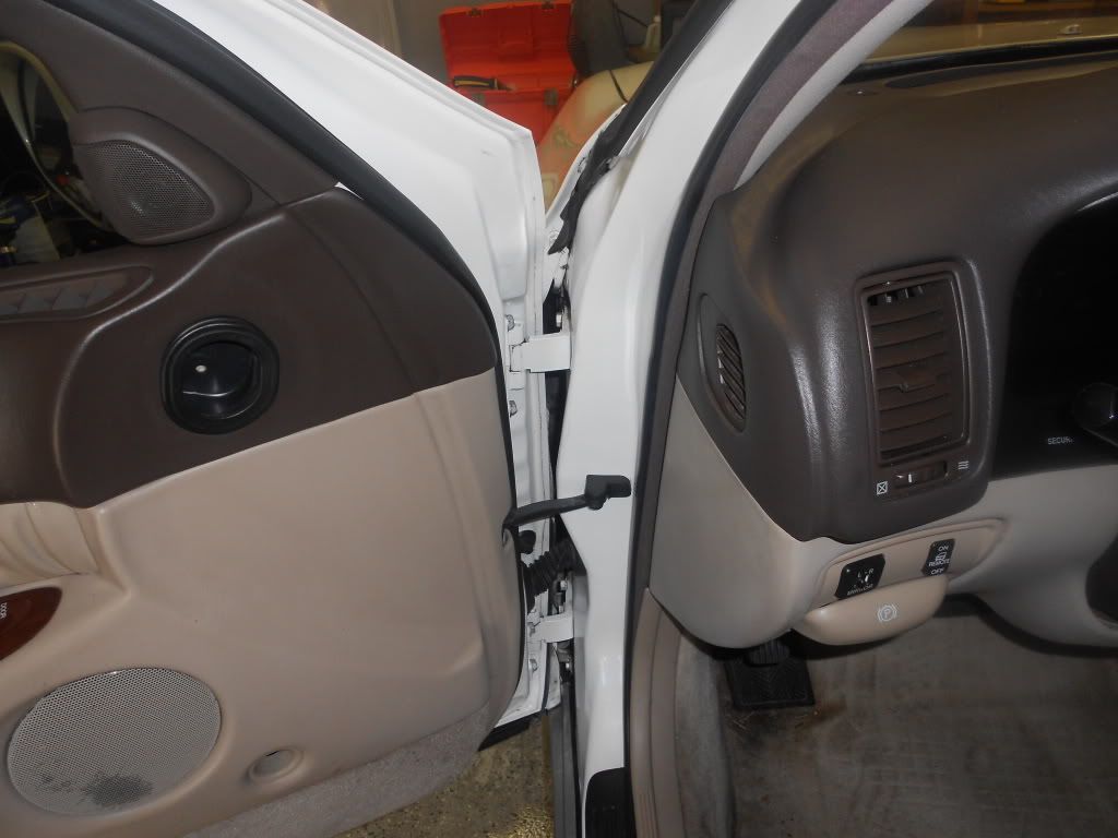

Finally, just some odds and ends. These door jambs and gas cap were from a detail prior to trade in....absolute horror. NO finished pics of car, was on a tight timeframe.
As Peter Gabriel said GIMME STEAM
Finished after steam + 3D APC and lots of toothbrush scrubbing and about 10 MFs filthy.

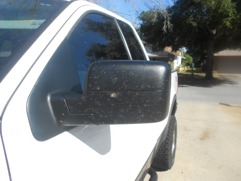

And teh GRAND FINALE. I am hoping Ron Ketcham is reading this far. I need to know....can the ValuGuard trim restore system save this?!?!?!!?!?!! If so I have an automatic upsell for this customer. I told him I would get back to him after hearing from you. this is from the white f-150 pictured earlier and this was taken AFTER a thorough wash with 3D Orange degreaser and getting hit with 3D Bug Remover.
