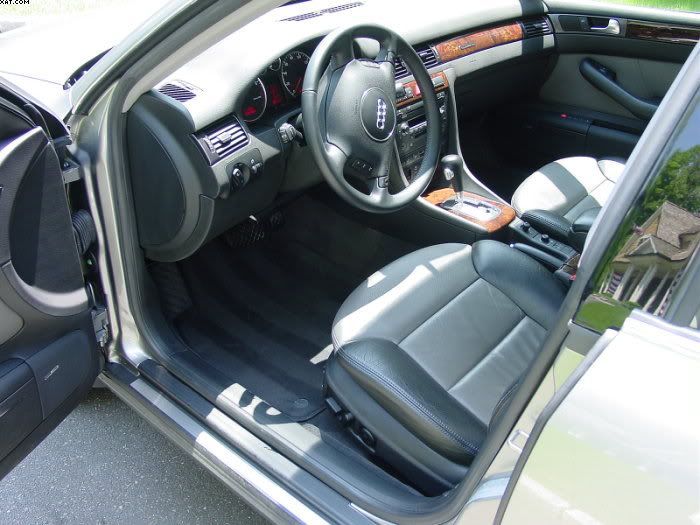

This vehicle was in pretty nice shape, just moderately soiled throughout, nothing too serious. I have to say though, after working on a few Audi's, their build quality is far up there. I really could not believe how solid and well put together everything is. Anyways, interior:
-303 Spot Cleaner , then APC mix, and extracted for carpets and mats
-Costco APC cut 10:1 to clean leather, vinyl, rubber, and plastic
-4* Leather Conditioner on the seating
-Adam's VRT on vinyl, rubber, plastic
-AIO/OCW in jams
