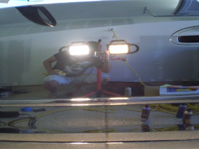

heres a correction i did on the first black car i ever did
you can see here under the halogens its pretty bad.
then 50/50. even still the side tahts "done" isnt 100percent. i know you can tell. because i can tell.
done. i dont even remember how many passes this took. its certainly swirl free. but i knew it wasnt 100 percent. i kept noticing micromarring the closer i inspected the paint. it was a significatn improvement however.
but you can see how in the similar lighting how it looks to noobs that the paint is 100 percent.
in order for it to be 100 percent the before and afters need to be taken under the same lighting and conditions.
