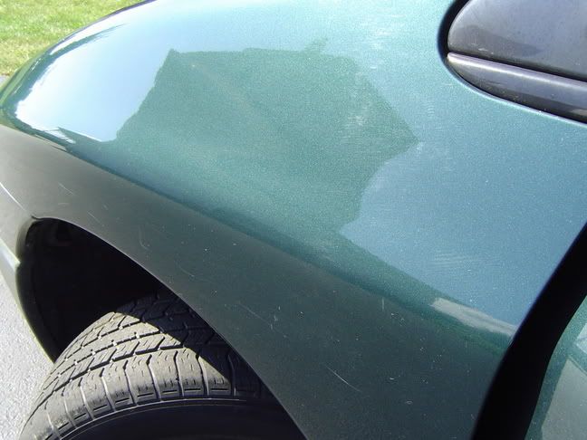

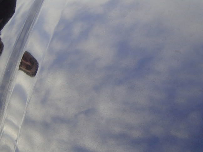

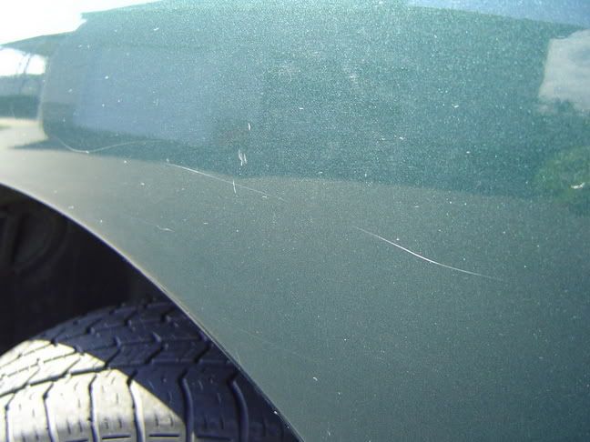

these pictures were taken 2/3 weeks ago, but ive been really busy with school and other things... but here they are... basically these were just comparison pictures to see how good menzerna is... on both vehicles, the fenders were washed, clayed, washed, the ip, then fp, and that was it, no wax (would skew results somewhat) tell me what you think
first car: 97 grand voyager with deep/bad scratches
before pictures

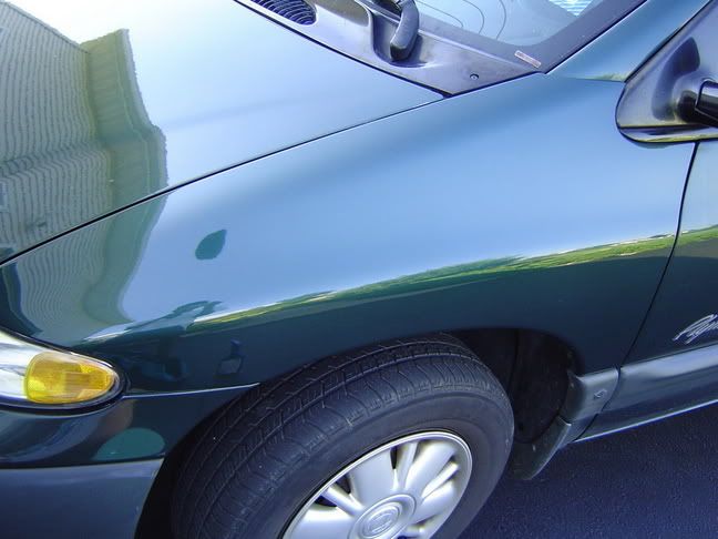

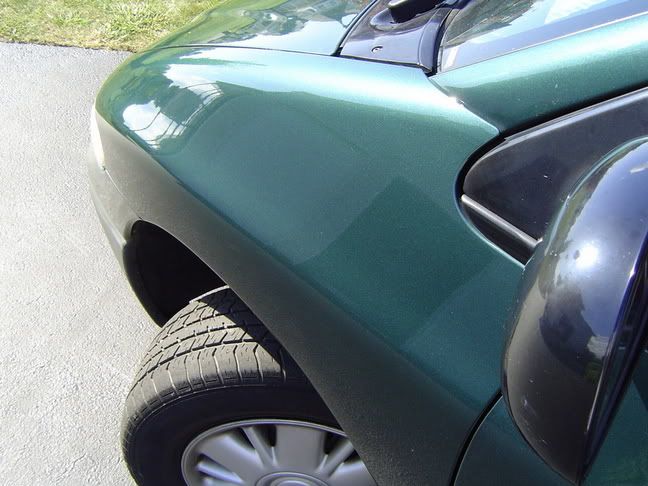

after pics:

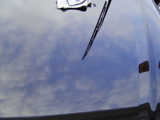

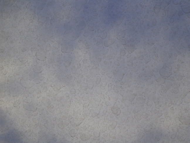

second car: 2002 altima 3.5se with severe water spots... (these things were deep!!!)
before... look @ how dull it looks...!

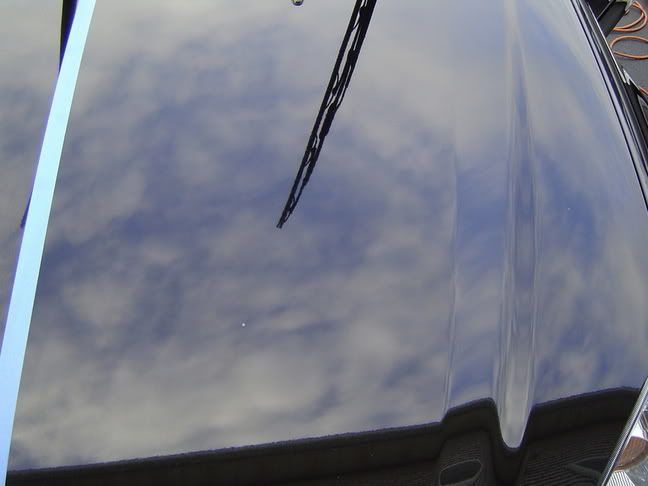

after... somewhat improved
you can see the line down the middle if u look closely & compare to other side
they were both done with a makita 9227
ip was done with a cutting pad (sonus) with 3 passes
fp was done with a polishing pad (sonus) with 1 pass
