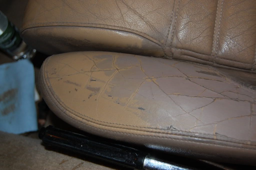

Some progress shots:

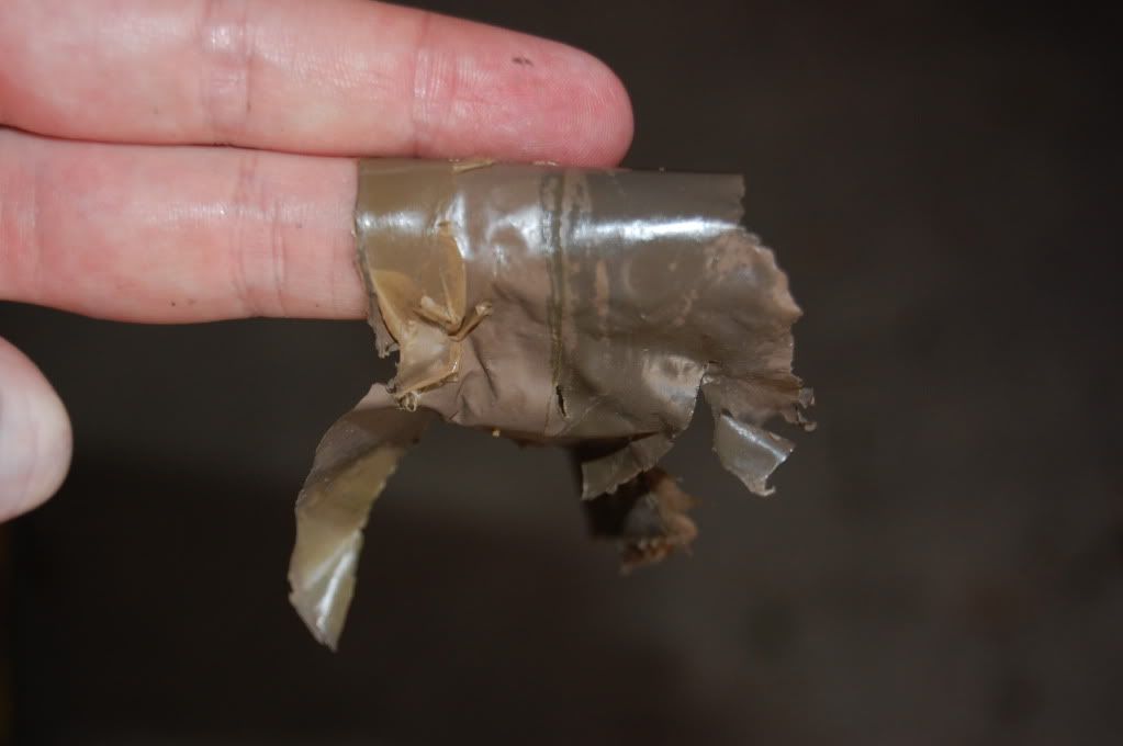

The Conolly (?sp?) Leather in XJSes is weird stuff...acts like "uncoated" in every possible respect (at least mine does, in the sense of living with it day-to-day) but that stuff that's peeling off looks like it *is* a coating :confused:
OK, Roger... school us! I've lived with that leather for over half my life and *I* don't know what the answer is! :nixweiss
Me either, it’s still a mystery; especially with history not yet reveal what this leather have gone through.

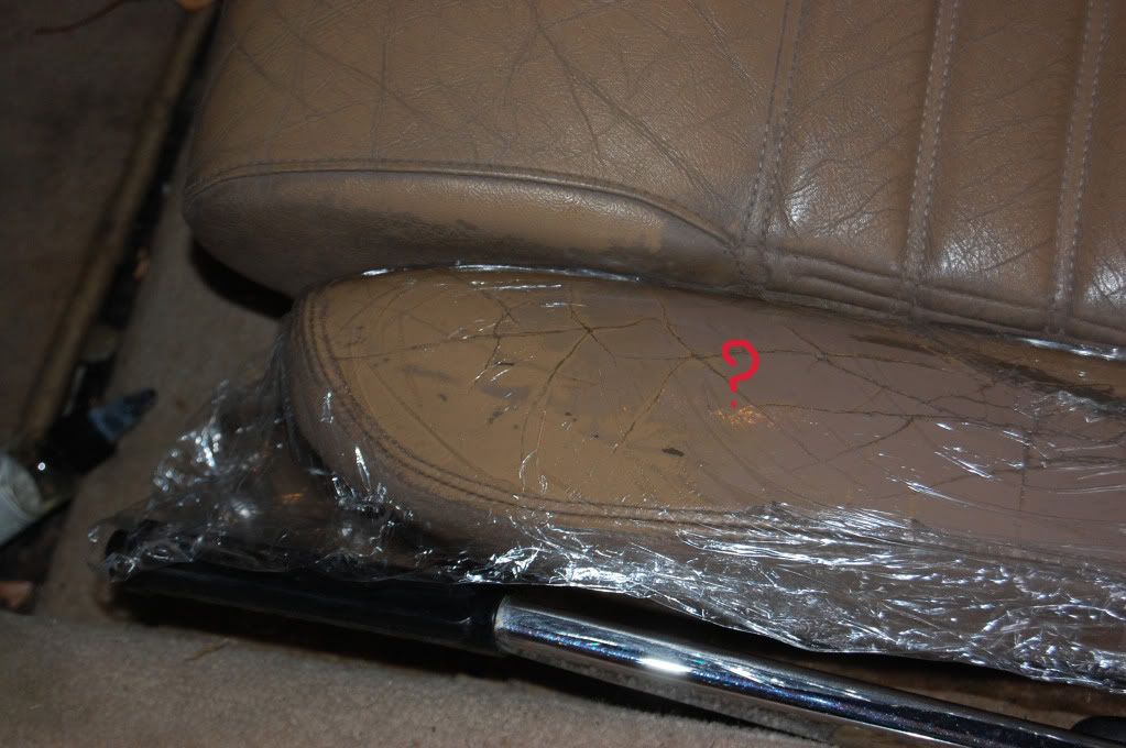

Below the red question mark may reveal the reasons for the layers which are not supposed to be there, or is there for a cover-up.
Hope that I am wrong.

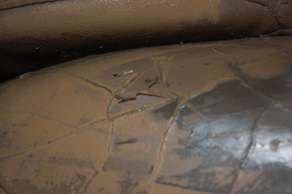

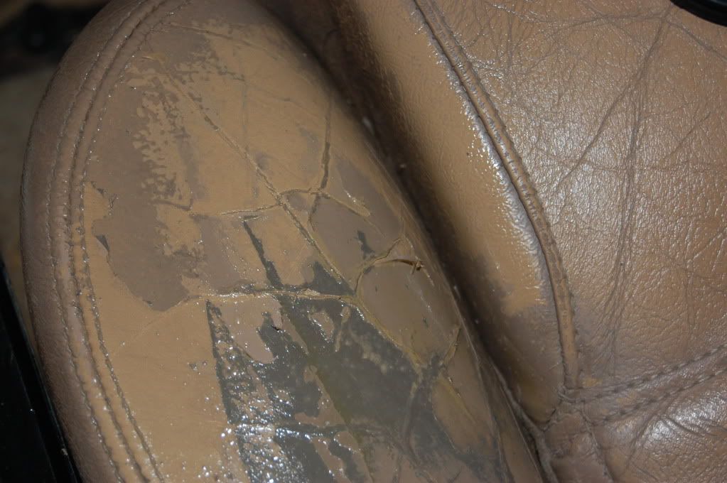

The section at the front of the bolster where the removal of the mystery stuff has been the most successful definitely feels better and has more of a leather feel whereas the section at the back where the stuff has doggedly persisted is slick hand harder. The entire bolster started that way and I was afraid that despite what I had read that it was in fact vinyl (ambla).
Am I right in assuming that even as late as 1994 that this is connelly leather?
Got this explanation when I asked a question on a jag forum:
It was likely sprayed with a plastic based dye, normally used for
vinyl. If it is glossy, the PO used the wrong dye. If it is a
dull or satin color, then it is the correct dye...but something
else is going on. The vinyl dye will eventually peal off leather,
as the leather ''breathes'' and the dye does not

In reality, we need to examine the pictures as the mystery coating is unveiled gradually.
Perhaps some care history background will give us some clue why the peeling coating was there, and is it supposes to be there originally – that’s the question.

Unfortunately I don't have a care history before last year so it will involve a lot of guess work. So I guess I continue to see what comes up and if it's leather or vinyl?
With Prep-7.7 under film cling wrapping and effective dwelling, has proven to be the safest method so far; and patience may pays off handsomely.
Unless it stops to move, we can move forward using a pH 2.3 leather stripper.
It appears to be more of a v... than a l...
Roger Koh
[email protected]
ok, pretty sure (80% is) it's leather which means if Connolly leather and and not top coated. This must have been a bad attempt at repair by a previous owner or dealer. When my bad back allows, back to it I reckon - pictures to follow.
