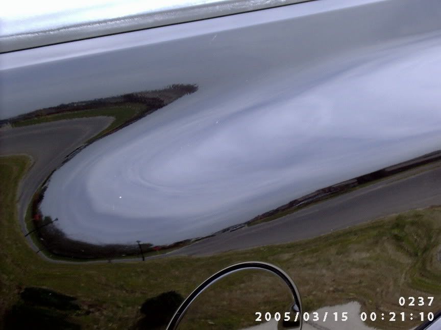

Showing the hood with etched in water spots and very rough surface.

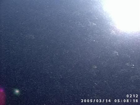

Showing the hood with paint chips but no swirls or water spots.

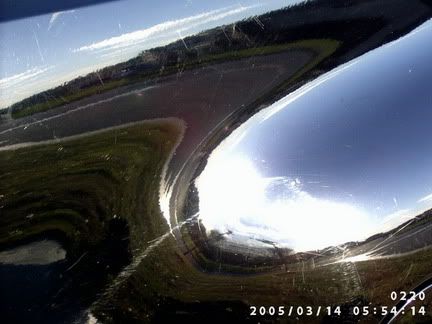

Here are scratches that showed up after the wash.

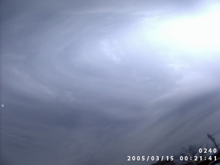

Here is a picture after Vector rotary and Menzerna Power Gloss.

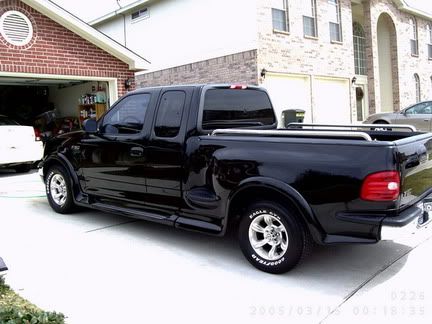

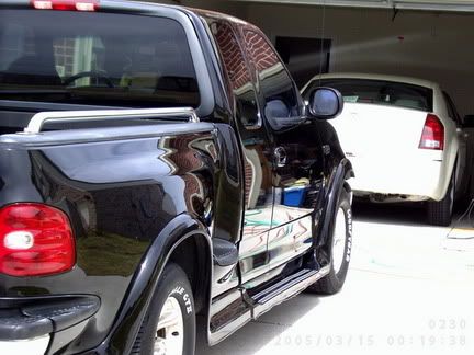

Now here is the end results.

Excellent transformation! Amazing what the right tools and products can do, even on something that neglected.
That truck is so much blacker now that the scuffs, swirls and waterspots were polished off. :up
