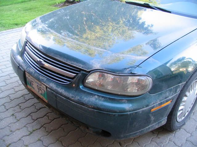

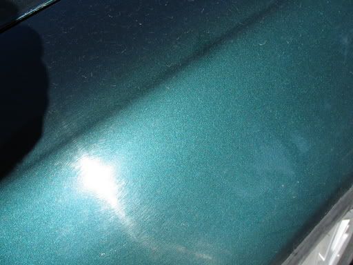

Swirls were the worst I've seen, and the pictures just don't show how bad they really were. I said in my head, "fine, I can handle a bad exterior, I've done similar jobs before". Well I kicked myself hard for the $150 price quote over the phone once I opened the door and hood. (Note to self, don't give quotes over the phone). :sadpace:

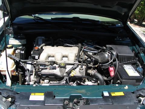

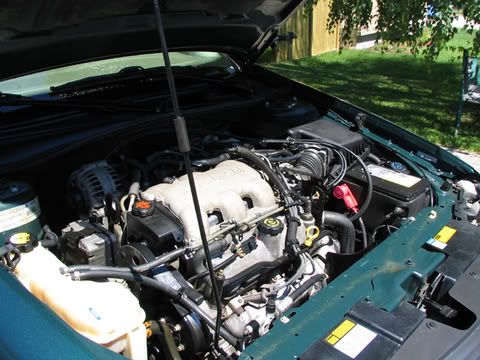

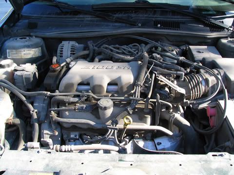

Engine bay was one of the worst I've ever seen. How can such a new car, look so bad?
I did the interior first, then went to go and move it up the driveway to wash it and put it away for the night. Well lucky me, the thing wouldn't start. It cranked over, revved up and then fell well below idle and stalled. I wondered what was going on, but didn't call the owner. I finally got it going and pulled it up to wash it. Ya, today it started no problem, so I dont' know what happend there.

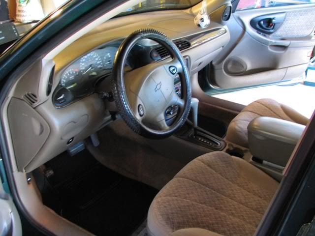

Interior processes were:
Remove junk and owners possesions
Take pictures
Vacuum carpets
Steam clean with "little green bug"
Scrub the carpets for about 2 hours with high concentrate carpet cleaning solution.
Extract waste water
Clean vinyl with "spot remover, NOW FOR FABRIC!"
Removed gumbo with house hold degreaser
Dress with Poorboys Natural Shine
Apply carpet scent

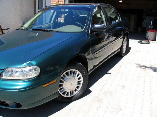

Exterior processes:
Wash
Attempted to dry, but the cloth just snagged on all the junk on the car
Attemped to clay, but it seemed to take over 2 claybars. I had to resort to driving to the store to buy two more. :nixweiss
**the next morning**

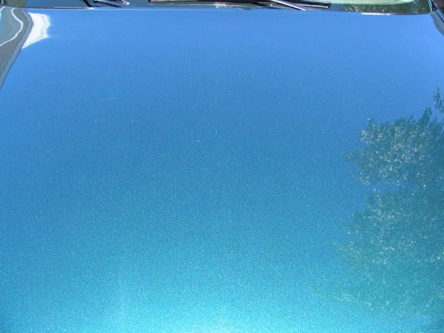

Began polishing with SSR 2.5 on spot cutting pad. x5 later, the car looked representable.
Worked out what ever was left with SSR 2 on a polishing pad. x1
Cleaned the surface to check for any other defects with alchohol
Found some buffer trails, so polished those out.
Cleaned everything once again with Klasse AIO.
Topped with NXT

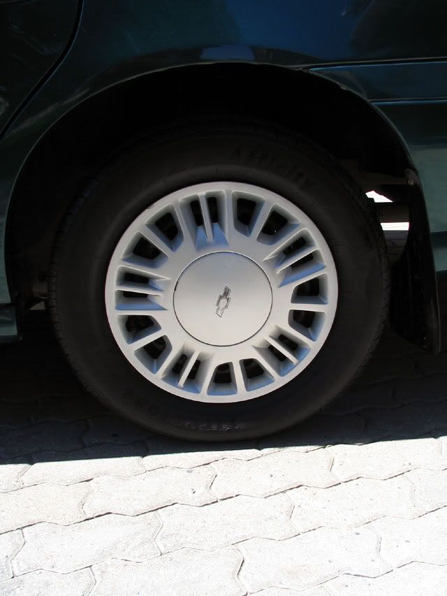

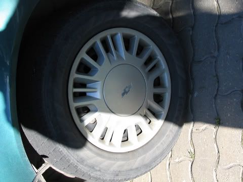

Tires got Diamler Chysler tire dressing
Wheel wells wouldn't come clean, but I dressed them with Armor all anyways
Trim and mudflaps got Poorboys Trim Restorer
Glass got some RainX
Plastic lenses were polished with SSR 2.5 and sealed with the rest of the vehicle
Engine bay:
Washed down engine with misted water
Engine wouldn't start
Left engine over night
Started good. (Damn that scared me)
Began degreasing with HotRims and a toothbrush
Didn't risk misting the engine again, so I just dressed everything with Armor All and tire shine.
(The marks you'll see in the pictures were not removable, due to no maintenence.)

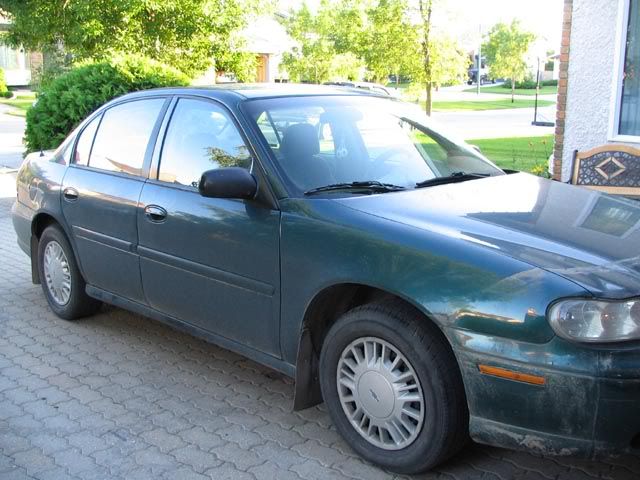

Befores:

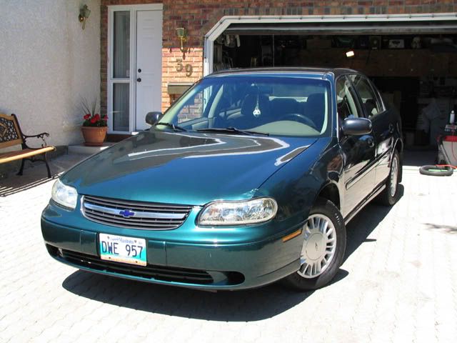

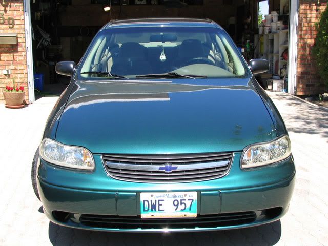

Afters:

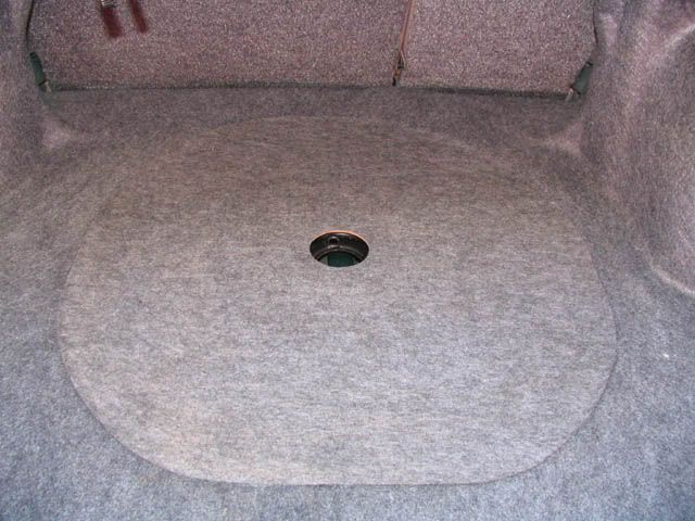

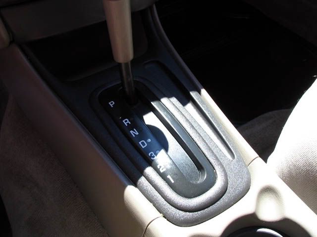

Interior Afters:
I thought this was a nice touch: (Don't mind the little gravel. I vaccuumed it up before he came)
More exterior afters:

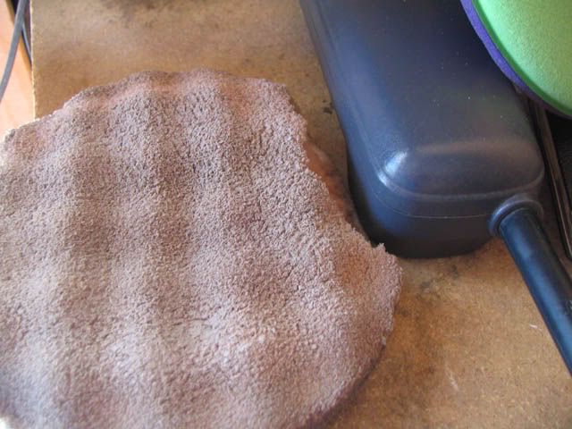

I had a couple casualties, this pad being one of them:

Anymore before pics of the whole car, after washing? This would help members see how bad the swirls are and stuff. Great job by the way, looks much better.
What kind of pad is that in the last picture? It has certainly seen better days! :eek:

Its a pad from 3M. Its in the trash now, along with 3 other pads.

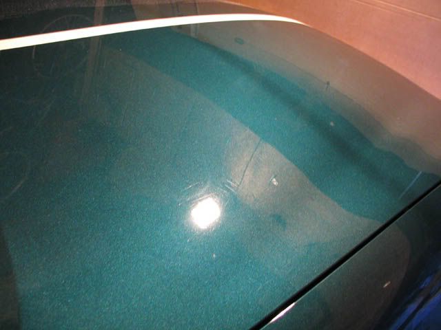

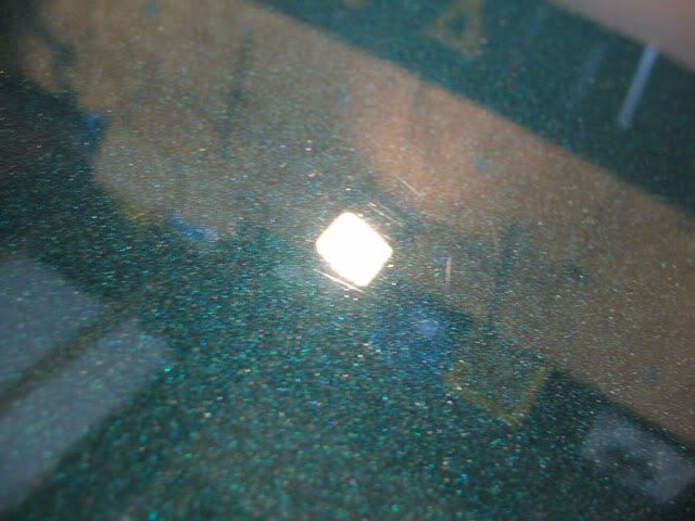

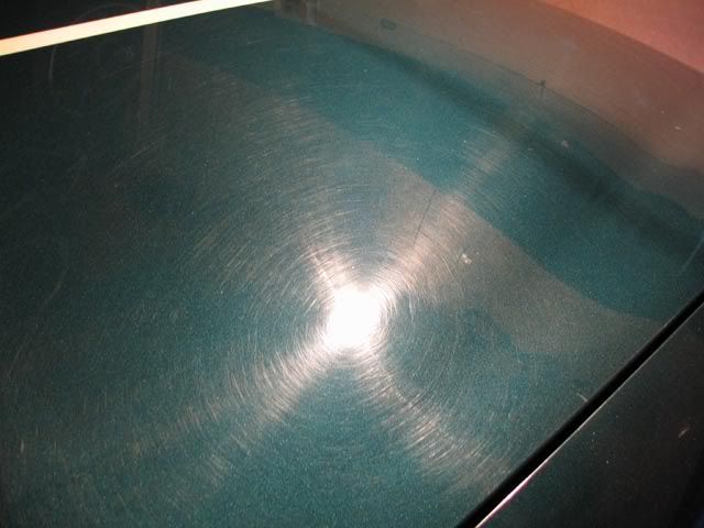

I am uploading some half half pictures right now:
This one is in the middle. The before side had received SSR2.5 x1 on them already when I realized that what I was doing. (Early morning)

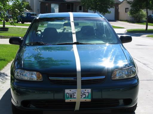

Here is one more, which was before washing, at night time, with the flash. I was hoping it would bring out the swirls more, but I had a very hard time gettin them to show. I started too early this morning to get any good full sun shots:

Nice job Steve! I think you help to prove those wrong that say you can't do much surface correction with a PC (although it takes longer)

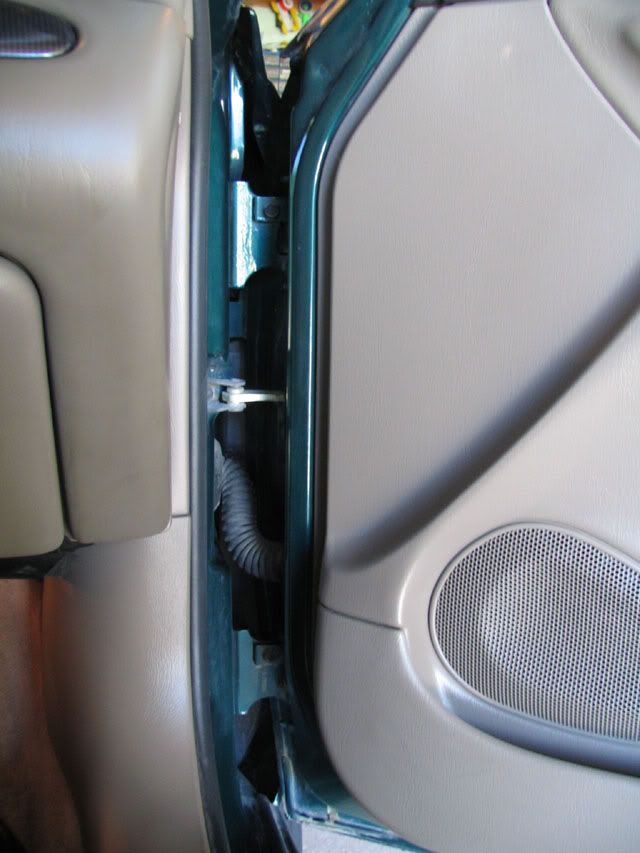

Everything looks 100x better except the doorjams :(.
What happened there?
I'm not saying this maliciously, but to further help you out in your ventures. I've been nailed on this before too, early on in the biz. Mix up a 6:1 APC mix and use a cheap MF to degrease everything, then hit everything with QD after washing the car. It will look brand new.
Other than that, amazing comeback!
Thats what I did. :nixweiss It was like embedded into the paint. :eek: Oh, and you didn't want to see them before. ;)
I wasn't about to break out yet ANOUTHER clay bar just for the door jams. I wasn't paid enough.
WOW, amazing, that car was just nasty before! What is that stuff on the hood before? some leftover residue from a bra or wat, how did you get it off? Great turnaround. should have polished that chrome chevy bar on the grill, would have added some extra sparkle.
