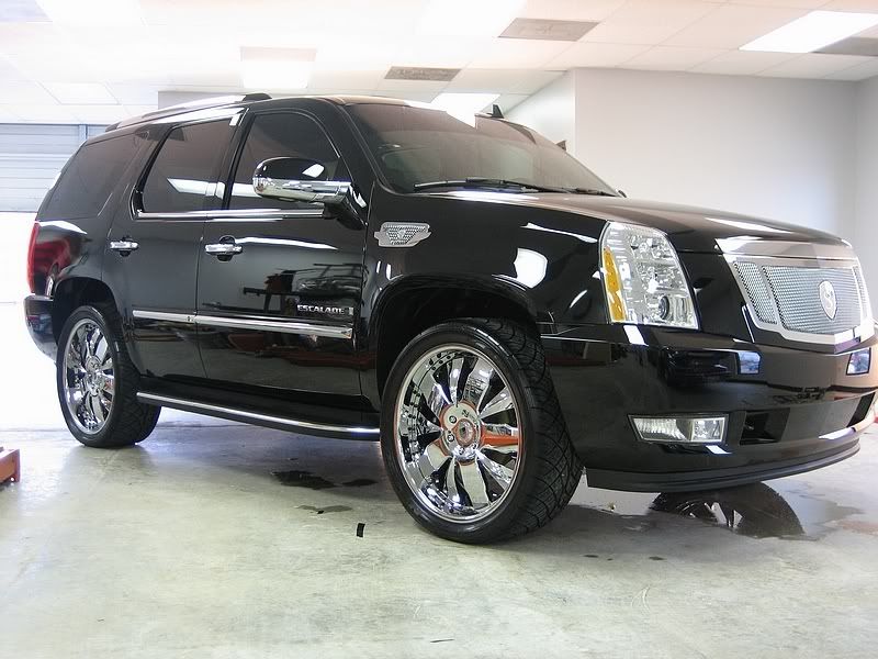

New body style Escalade?
I did one of these last weekend and the paint was *very* soft--PS would *not* leave an acceptable finish:
eb, friggin bee-utiful!

David I've gotta give you props on the Escalade! Hope you were payed handsomely for that one!
Thanks. Since selling my business, I don't do it for the money, I do it for the pure enjoyment of the hobby. :thx
