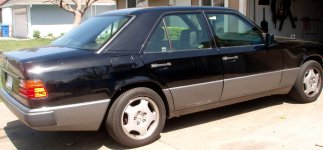

I got in on Autogeeks specail for the Wolfgangs & Merzaerna blends...his Finishing glaze and total swril remover...I had a jet black MB to work on and the paint was somewhat trashed...I will have this car for a week so the pics posted are not the finished product
I started with washing then clay..then used the PC and PB PP to clean the paint even further.
Then the WG with the rotary and a polishing par..using the WG SWR it worked the surface very well, cut the swirls pretty fast...it reminds me a lot of a blend of PP and SSR2.5...Its not real thick and easy to work doesn't gum up the pad to fast (about half the car I started cleaning the pad) it doesn't sling to bad not like others I have worked with...and not a to of dusting to speak of
Once I cut the car I then started on the finishing glaze...with the rotary and a finishing pad...this has a high gloss and cutting power at the same time...its a very thin liquid product that works the surface with ease....The finish was just a bit oily looking to me but that settled down with a cold water wipe down
At this point the car was like a mirror working with halogen lights I could see very little swirls in the paint...I then use PB BH glaze by hand...and that's where I stopped...I plan on putting on a sealant and then topping off with Nattys red over this next week.
