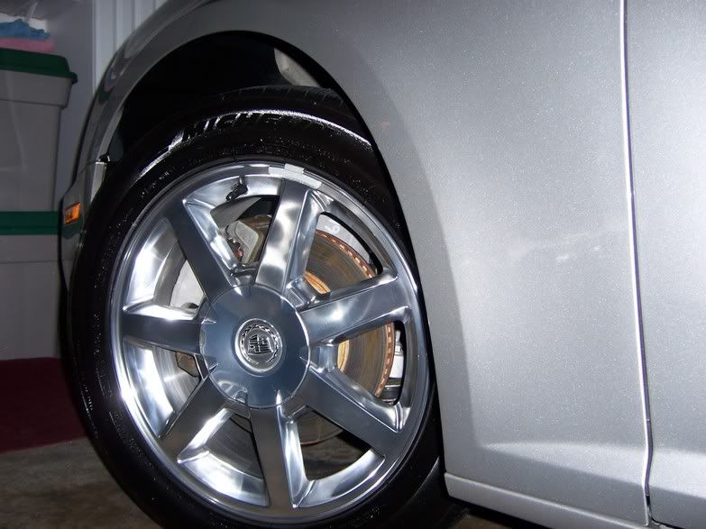

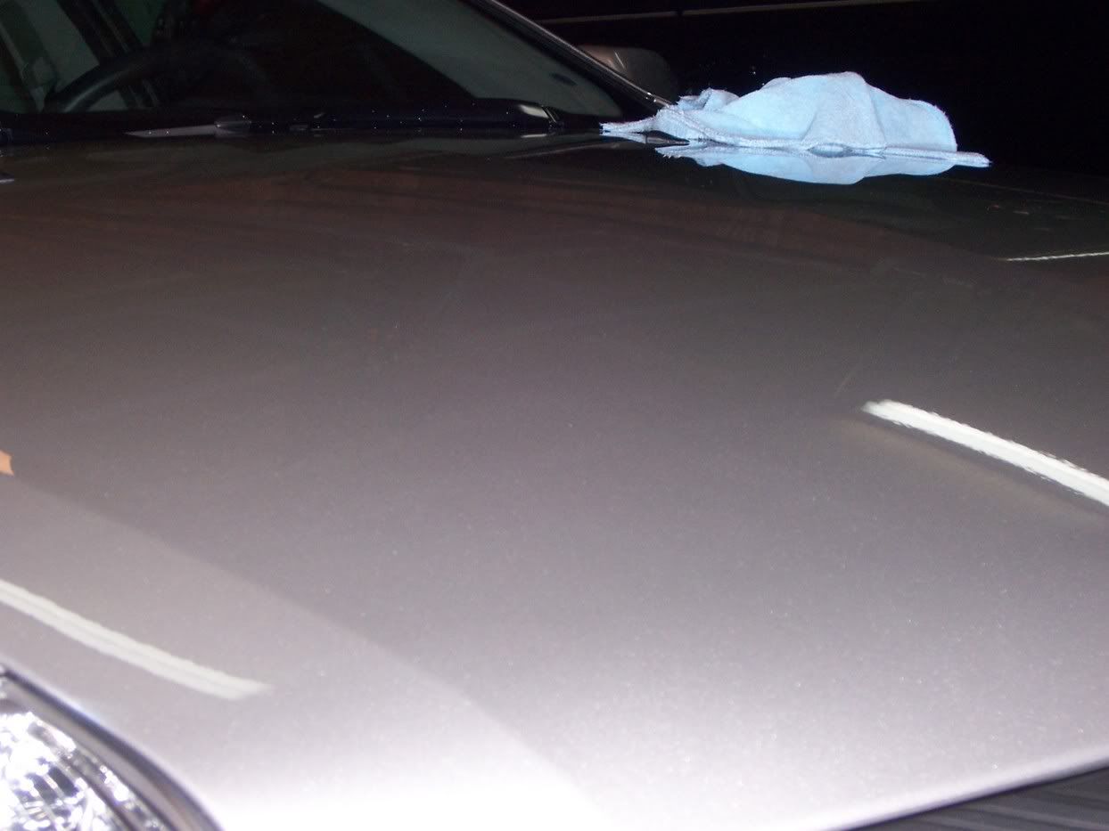

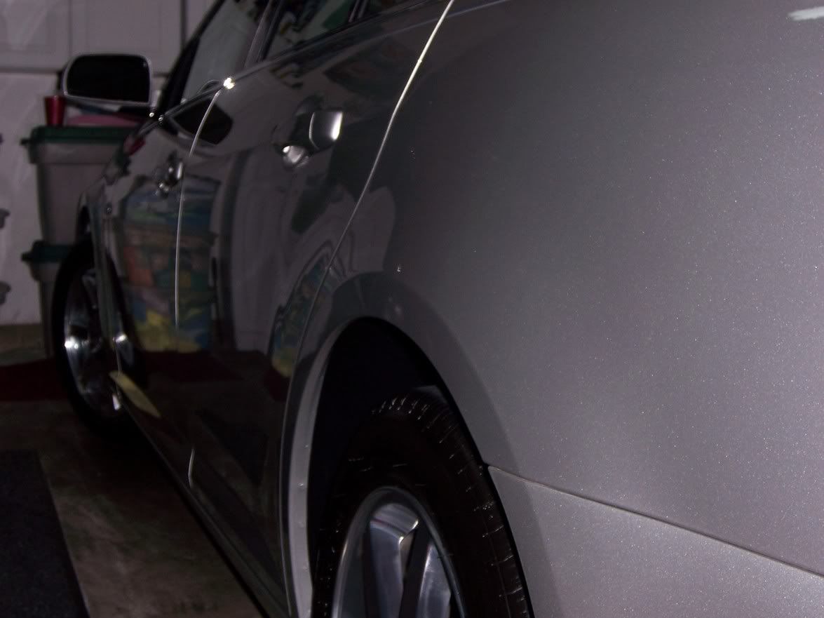

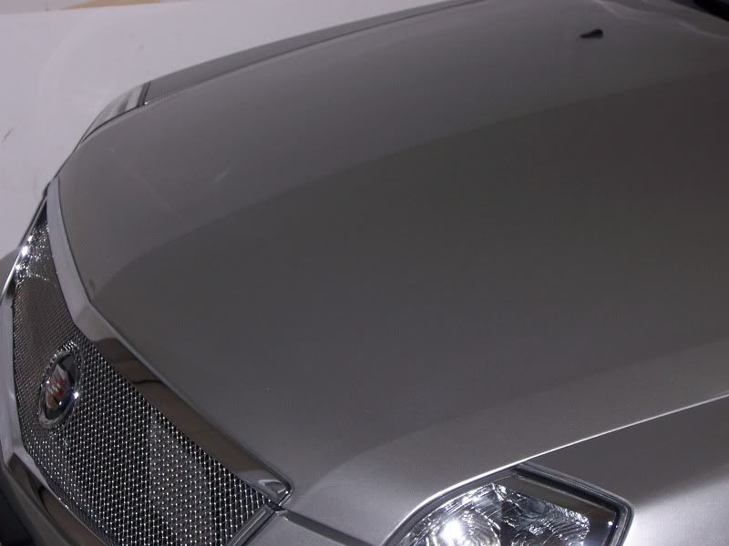

Here are a few shots (night). It's been raining all day in the NE. The good news is... it's going to rain all day Sunday too. I guess it's better than snow :)

Flakes are a popping on that STS. :)
The Lexus has a very nice looking Z 'pop' too :)
