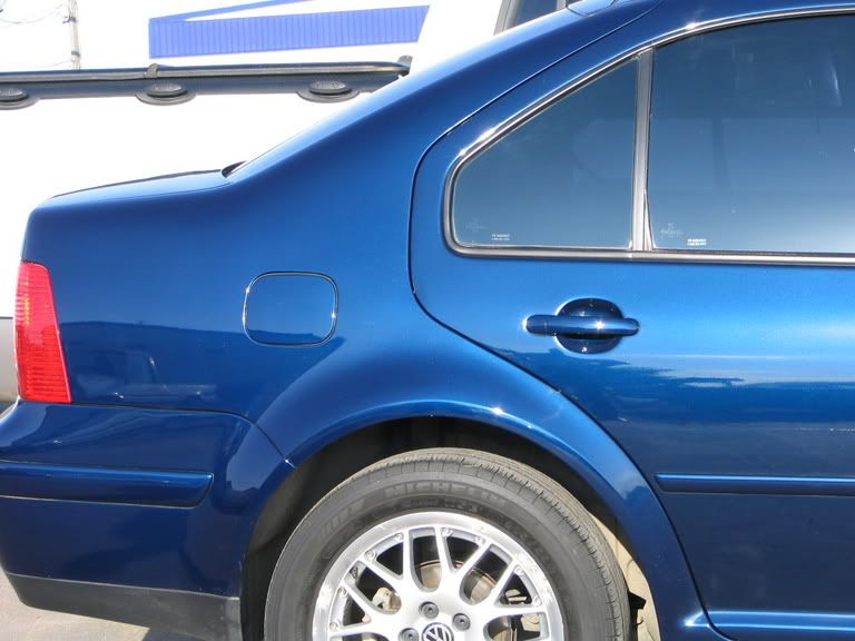

[/IMG]
This is a lot car and was about 12 hours in and out. Exterior is 3M fine cut x2, MG, FPII all with 50/50% alcohol wipe, gotta make sure 'what you see is what you get' and then Z2 as i am trying to use up stock. I might do another Z2 then p21s.
