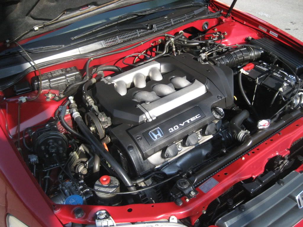

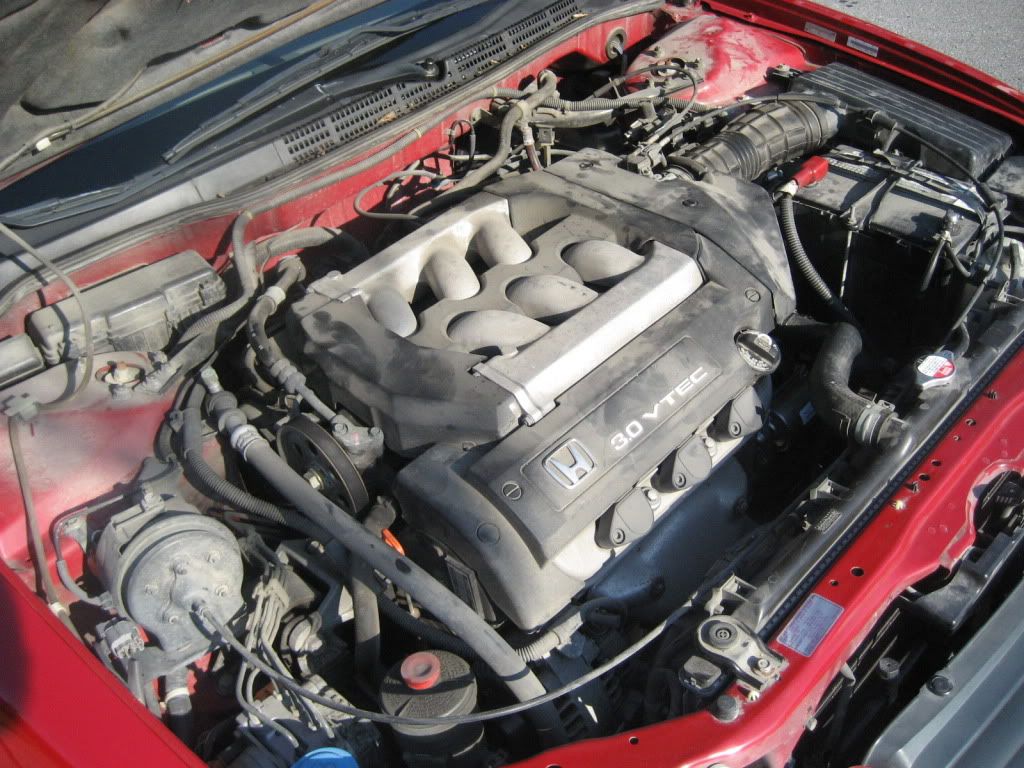

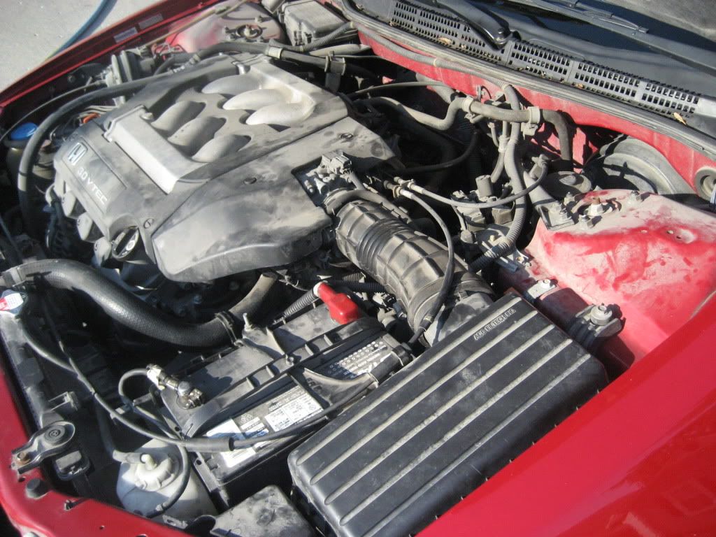

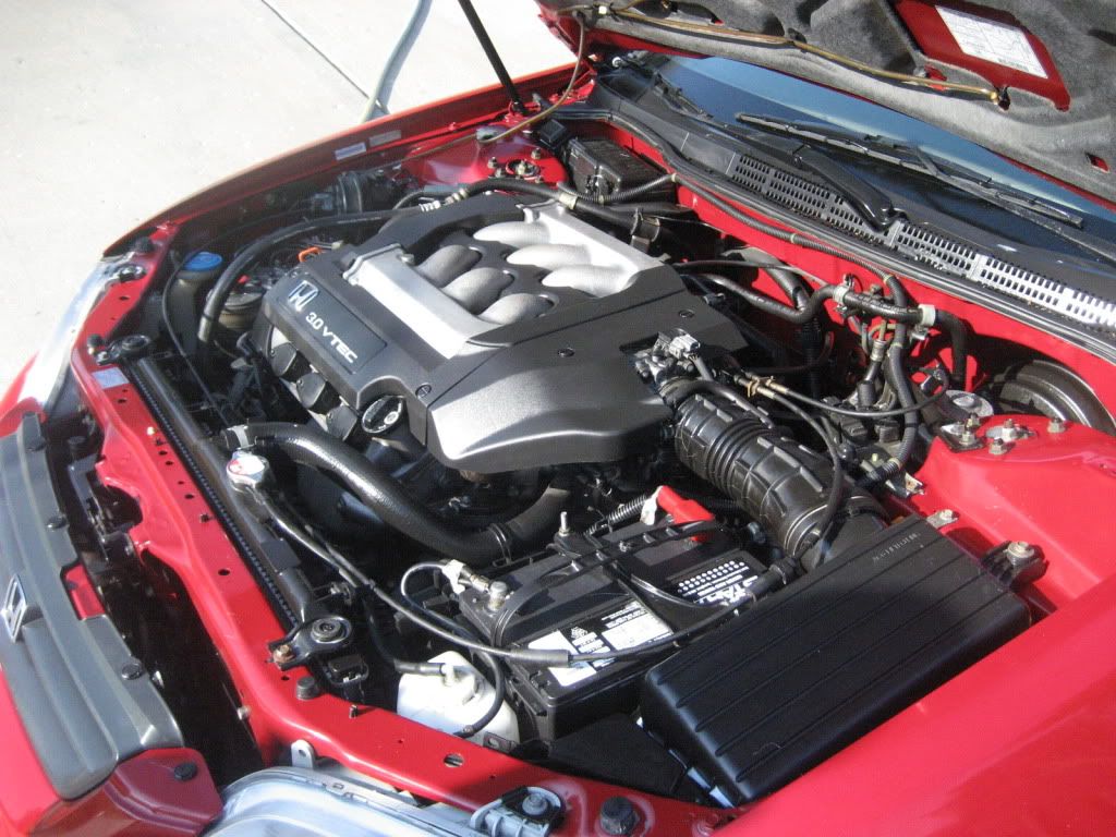

The customer wanted his engine cleaned and detailed before he sold the car.
PROCESS:
Saturated engine bay with Gunk Engine Cleaner
Scrubbed engine bay with a bucket of soapy water (dish washing soap) and a long handle brush
Rinsed with a stream of water - no pressure
Dried with an old towel
Sprayed entire engine bay with Tire Foam (ran out of TrimShine)
Wiped with towel
Done.
A lot of people think Tire Foam will make the engine bay greasy... not true. Oil based tire dressings will, but not ArmorAll Tire Foam
20 minutes, 60 dollars.
