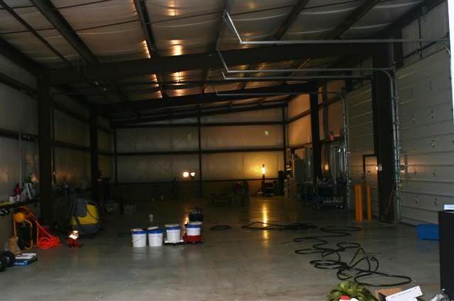

Guys, Eric forgot to mention the size of his "shop"
He opened up last week and what a place!
A detailers dream!!!:goodjob:goodjob:goodjob

For a large shop of that size, a forced air, fuel oil heater would work. If you are worried about fumes, find one with a heat exchanger unit that will vent outside. With roll up doors, you need a heat supply that will replace the loss quickly when you move a car in/out of the bay.
If that is your shop pictured above, you might want to look into something similar to these: Oil Fired Unit Heaters - Portable Oil Fired Heater, Modine Oil Unit Heater, Modine Heaters (the 3 bottom units shown) or a similar unit if you have access to natural gas. They might seem expensive but the heat sure is nice.....

Yeah that is the shop I am in. These item look like what I am searching for. They look like they have enought BTUs to handle what I need. I am currently using a force air heater, and the fumes get to be too much after a while.
While on that site, use the BTU checker, punch in the values for your shop and the type of insulation that you have and it will give you a good idea of what will be needed. Looks like a NICE setup for you. Congrats on the new space.
Edit: We always set ours up high in the back corner on an angle frame and aimed the unit to the front corner opposite the heater. Worked well for us when I had my shop.
