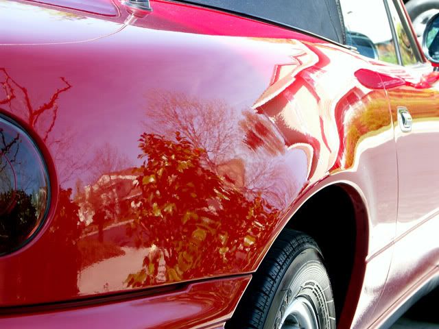

Here is some shots of oxidized red that I used PP, DACP for some heavier swirls (SSR2.5 wasn't available at the time) SSR1, PwC and EX. PP really cut through the oxidization, I used it both by hand and PC with equal results (PC just being easier and faster).

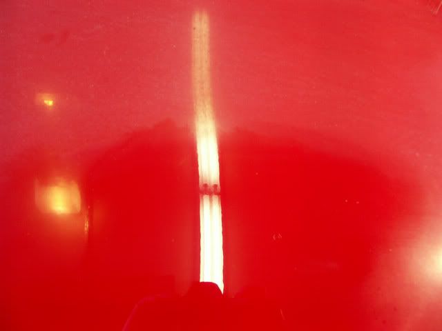

Here is a shot after using PP by hand on the hood:
Here is the side before and after:

Here is some shots of oxidized red that I used PP, DACP for some heavier swirls (SSR2.5 wasn't available at the time) SSR1, PwC and EX. PP really cut through the oxidization, I used it both by hand and PC with equal results (PC just being easier and faster). Good luck :hippi
Your pics looked awsome. Thanks all, for your responses. This car has been neglected and has had no wax on it in years. I washed and clayed already. Should I still polish before the SSR2.5?
